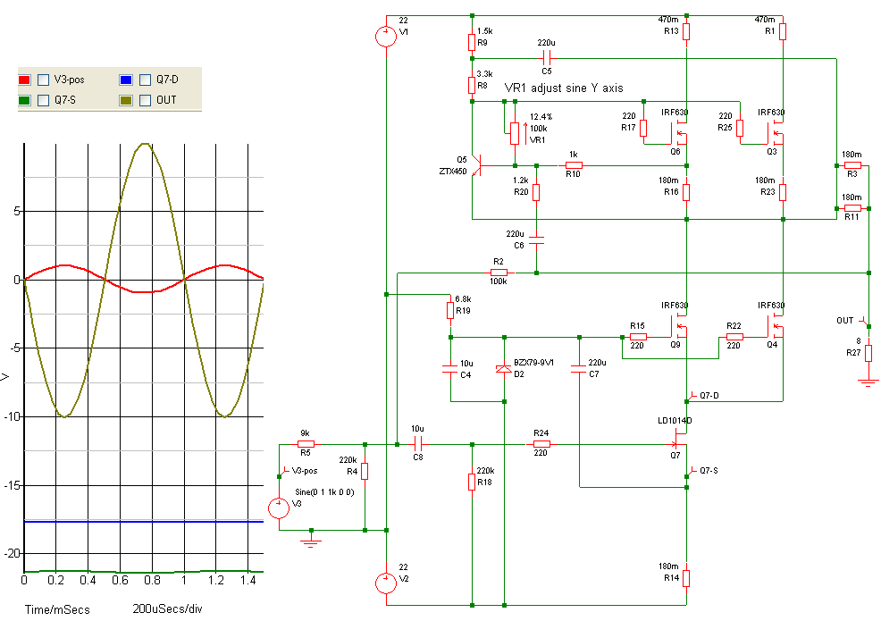

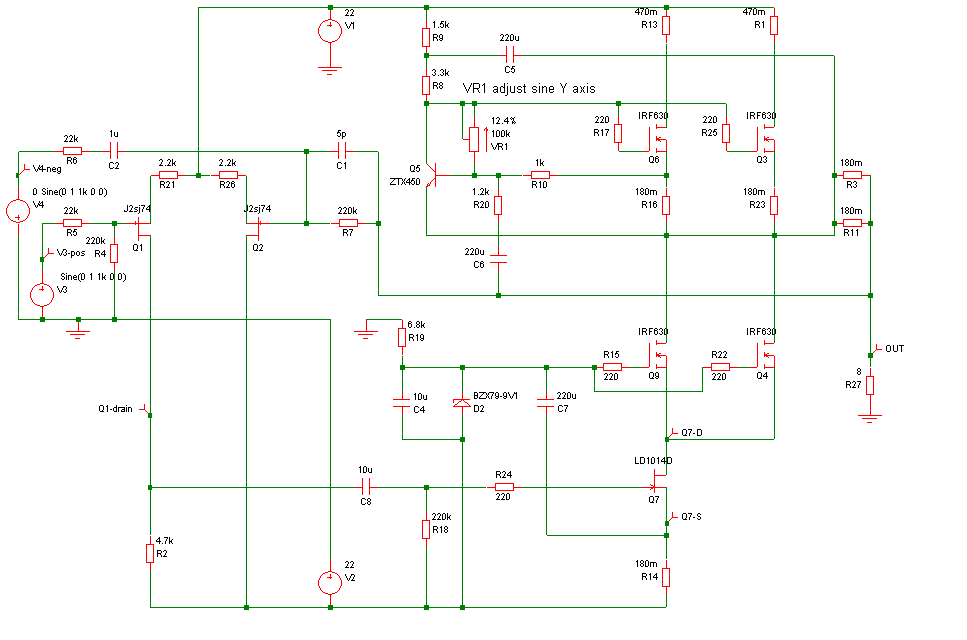

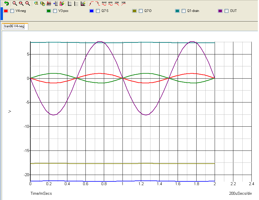

flg said:John, your input diff has no Isource?
I'm getting a pretty good sine for not having a functioning input differential, wouldn't you say?
The sim also says I can also drop in the 2SK170, invert the Drain/Source resistor values and get the same effect.
Haha, you got me to thinking: I had way too much gain with the CCS. Without the CCS I'm just passing unamplified voltage through the jfet diff pair. I'll explore further.
Thanks flg!
