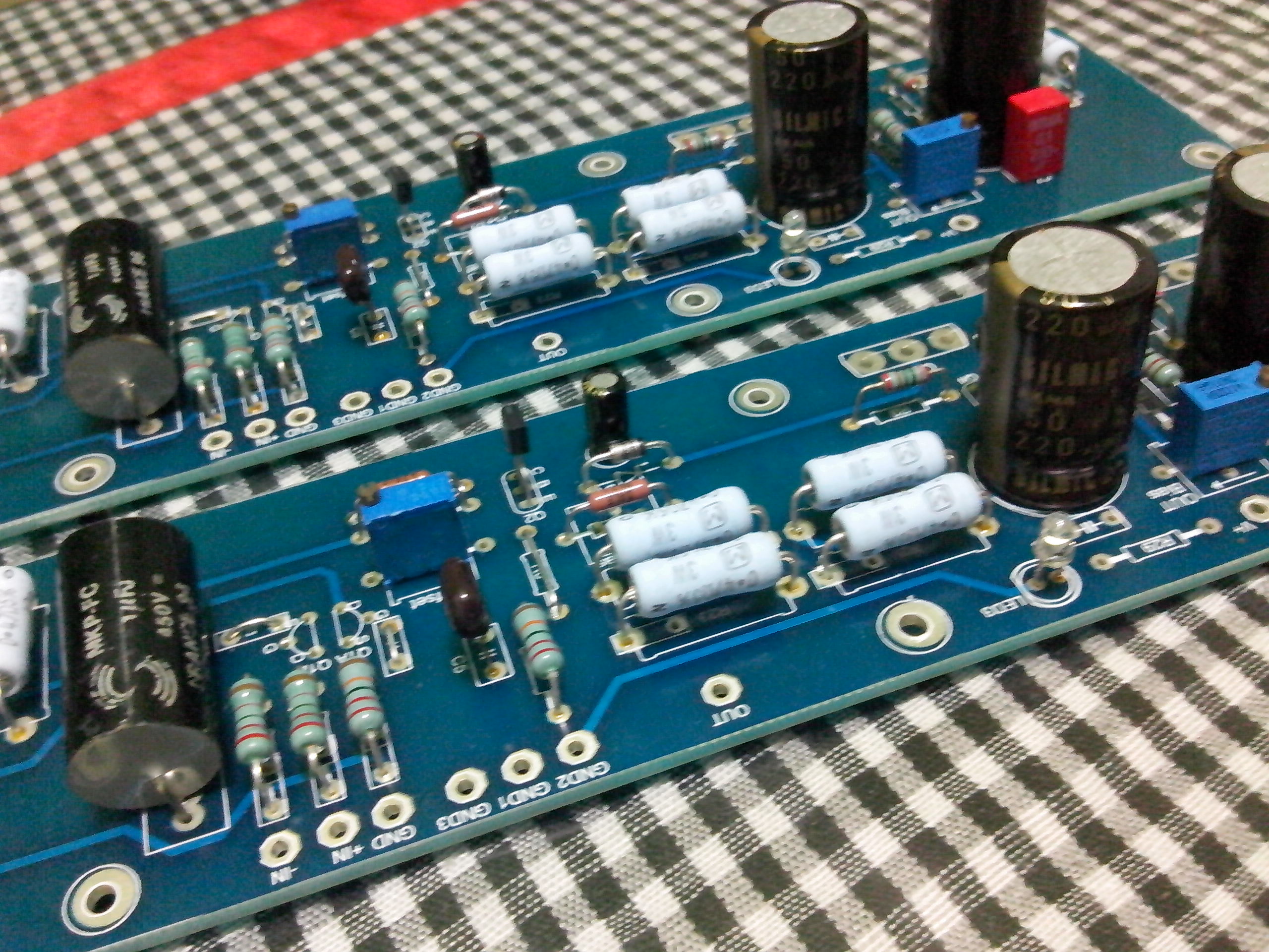

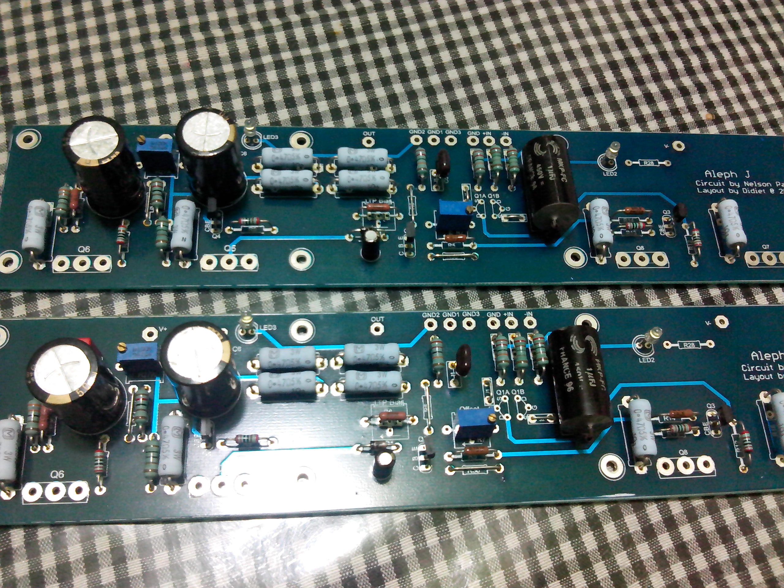

Finished collecting some stuff
attachment.php
attachment.php
Any suggest for the output transistors?
Some people consider FQA series better than IRFP
What do you think? :rolleyes:
If you don't me saying, you have been a bit shy with the solder, you should have a good joint on both sides of the PCB with a 2-sided layout.
It is double sided through holes
I think one side solder is fine for through holes

Your soldering looks fine... although you are missing some transistors... :) :) :)
