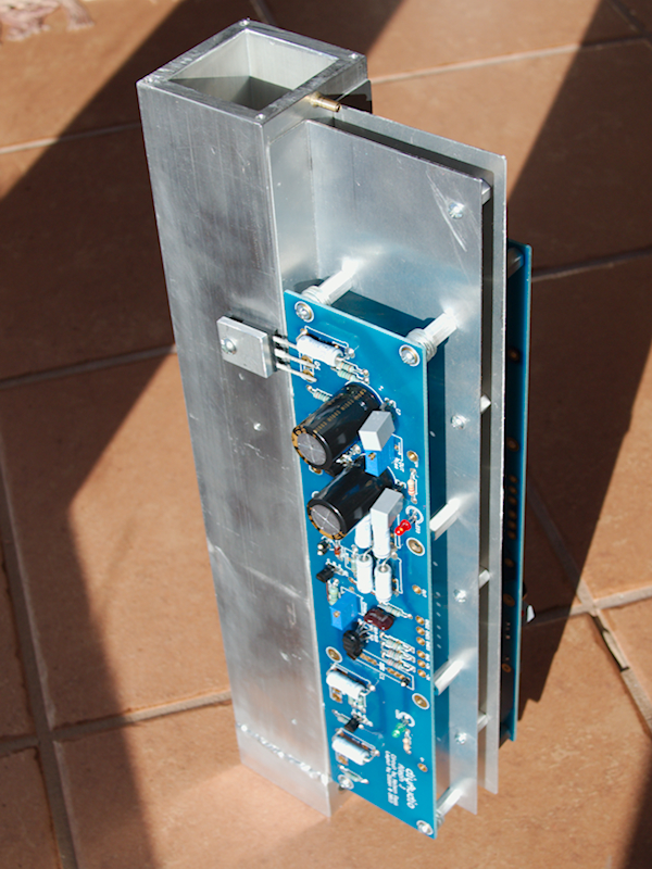

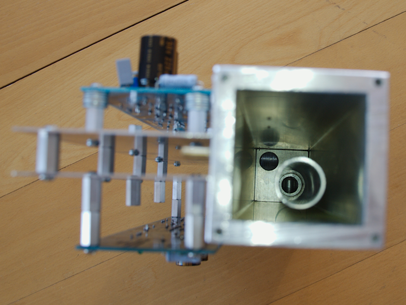

Aleph Kool J heatsink
Still a long way to go, but I thought you guys might enjoy pictures of the liquid cooled heatsink. I've decided to call my little project, "Aleph Kool J" since the liquid cooling is the unusual part of this build.
This is a cooling tower type of heatsink, my version of a concept that bcmbob did with his BA-3. The water flows in from the bottom and cools the outer square tube. An inner round tube is set at the height of output devices and allows water to return to the pump and radiator.
The first picture shows the heatsink in the mockup stage. I am playing with standoff height relative to output device mounting.
The second picture show the inside of the heatsink.
Great thing !!
I also brood long about watercooling the AJ.
But how about radiating the heat away from the square tube?
I will use parts available for PC cooling. Basically, a pump to circulate the coolant, a radiator, and fan. Not cheap, but interesting.

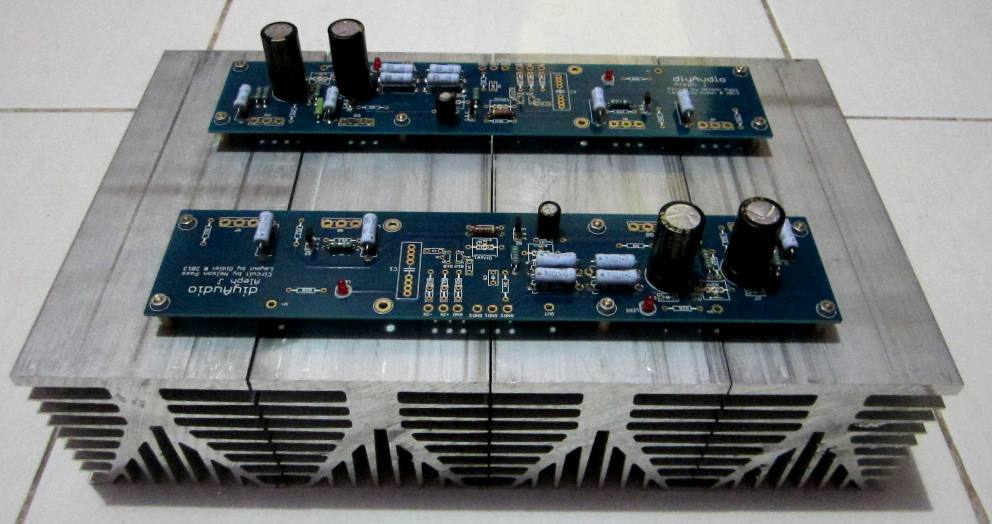

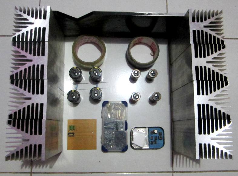

I'm a slow builder, but enjoying the build process during weekend. My original plan was to use 6pcs heatsink per side and use 10mm copper plate to mount them. but after trying different layout, i can make each irfp fits into 1 heatsink. each heatsink profile is 200mmx84mm base dimension, with 7mm thickness of base plate and 81mm height with fins, weighted 1.6kg. hopefully it's enough.
I also try to prepare 2 UMS per side, prepare it one day for another FW
Since I don't know my heatsink thermal conductivity, I find some similarity with the products on this website Heatsinks: 7000 series - 7200HS | Birmingham Aluminium Ltd and I made xls exercise for simulation as attached
Simulation result shows 0.47 °C/W per heatsink. let just say my heatsink profile is half less effective than birminghamalum products, κ will be 1 °C/W.
My question is, how much energy is dissipated from each irfp? Do they dissipate in equal?
