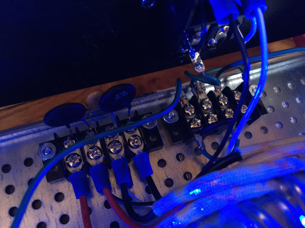

OK ... I need help form the gurus ... I have tried everything and can't get rid of the hum!
AC GND In attaches to Chassis and then though CL60 to Aleph L&R channel GNDs from a single star point. All wiring is separated by at least an inch. Touching the wires does nothing except when I touch the input wires I get a loud hum but not the same hum as the constant one ... another one on top of the one I can't eliminate! I have the AC mains filter across the input then CL-60 in series with each leg of the transformer. Power supplied through an APC conditioner that has an isolation transformer.

You have an enormous ground loop... mainly because the PSU board is spilt and you have no central point on it, but also as you have all the grounds bussed on the PCB and then have the greens running to the CL-60 and Chassis earth... and those are in the magnetic field of the transformer...

I'm in the process of building a new enclosure for my Aleph J. The goal is to bias the AJ a lot higher because in the 3U 300mm store cabinet I couldn't bias higher than 0.85 Ampere/ output device.
In the new cabinet I can bias with the trimpot till 1.2 Ampere/ device and then I reach the end of the 100K trimpot. This is R27 in the FW Alepgh J schematic and is original 68K2.
How can I bias the Aleph J higher? Even higher resistance than the 100K pot, by placing a 47K in series? Or should I better change other resistor values in the AJ current source?
Heatsinks are only 46 degrees with 1.2 Amp / device, so I can bias 10 degrees higher
