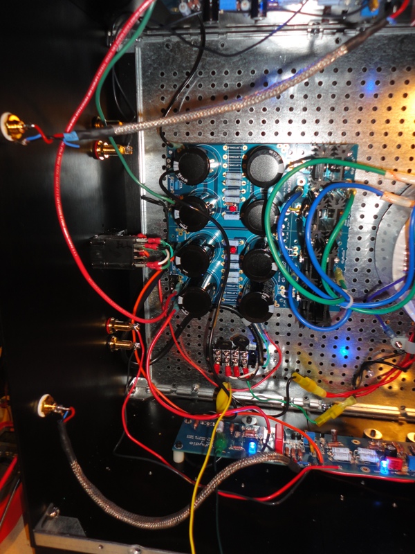

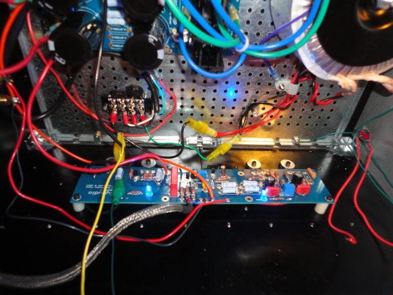

Noise in one channel
I have a low level hum and a occasional crackle noise coming from the left channel rt side is dead quiet. I have done the following to try and alleviate the noise but no luck.
Re-soliderd complete board
Replaced output fet's
Moved all wiring around
Replaced source resistors on ft side (now will bias to .4 ) only 3.5mv before.
Amp plays and sounds nice but spits some noise form L side every 20 sec. or so
Noise stays the same regardless of offset amount
Your non-twisted AC cables (and terminal block) are right by your left channel board and outputs. I was afraid to do that myself.
I'am still having a issue with the L channel after finally getting the noise down I now can't get the offset below 28mv. It will now bias at .4 no problem but pot bottoms out at 28mv. I have tried several times to back off everything and start the process over but with the bias set to .35 and up offset stays high.
