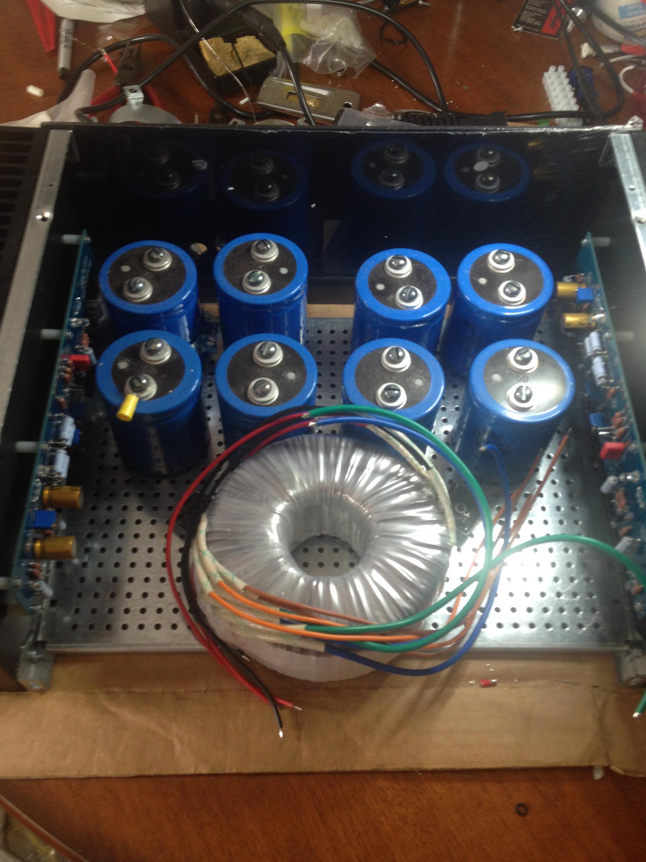

OK, my turn for a question. Below is a dry fit for my Aleph-J. I'd like to use these big cans since I have them - 68,000 µF/50V reformed since sitting on my shelf a few years away from this hobby. Layout is for dual CRC PSU sharing a common transformer.
My concern is the proximity of the outer caps to the boards, especially the input section on the left. If I go this way the outer caps will be the final caps and connect to the board. AC will run below the tray. I bought a bunch of grommets to do that safely.
So the question is should I go this route or a single shared CRC PSU or separate C only PSUs? Thoughts and ideas welcome.

Without drilling new holes in the base, the caps are a bit further apart than my dry fit. the only way to mount the transformer is vertically. I remember seeing a bracket but can't remember where. Did anyone bookmark that? The only ones I've been able to find are pretty flimsy looking and create a shorted turn if the insulating washer fails.
I might be able to fit a pair of Antek 4220s stacked.

Found the L-bracket source - Apex Jr.Home Page Not listed on the site, but call Steve to check availability.
