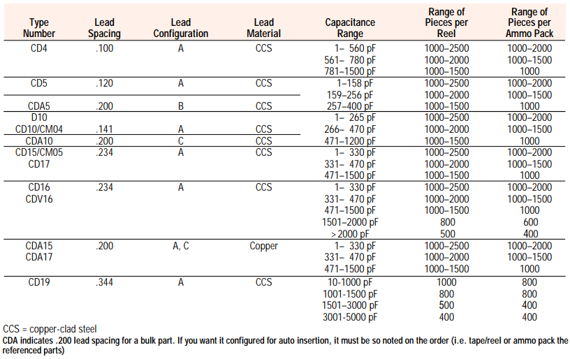

DiyAudio BOM revision D suggest Cornell Dubilier Silver Mica capacitor series CD15 for C5.
Aleph J PCB lead space for C5 is 5mm.
This cap in revision D BOM:
Cornell Dubilier - CDE CD15CD050DO3F (Mica 5pF 500V +/-0.5pF 11.4x4.8mm Lead Space 5.9mm Copper-clad steel lead)
https://mouser.com/ProductDetail/CD15CD050DO3F
Might be beter fit series CDA15:
Cornell Dubilier - CDE CDA15CD050DO3 (Mica 5pF 500V +/-0.5pF 10.9x3.6mm Lead Space 5.1mm Copper lead)
https://mouser.com/ProductDetail/CDA15CD050DO3

I accidently purchase the steel lead parts, they are now sitting in my parts bin never to be used.
Thanks for finding some copper lead parts.

It seems all Cornell Dubilier Silver Mica capacitors have copper-clad steel lead except series CDA15 and CDA17.

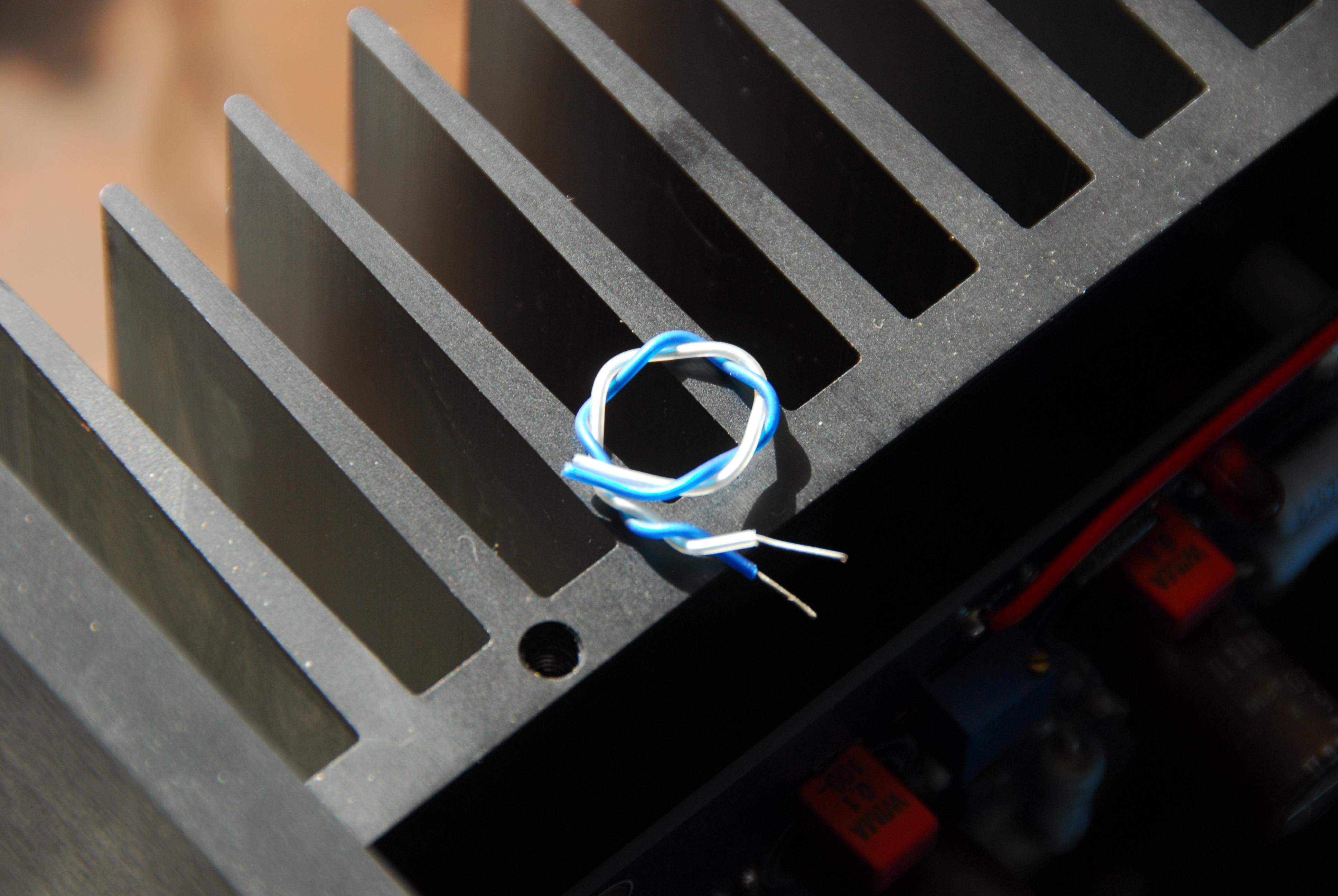

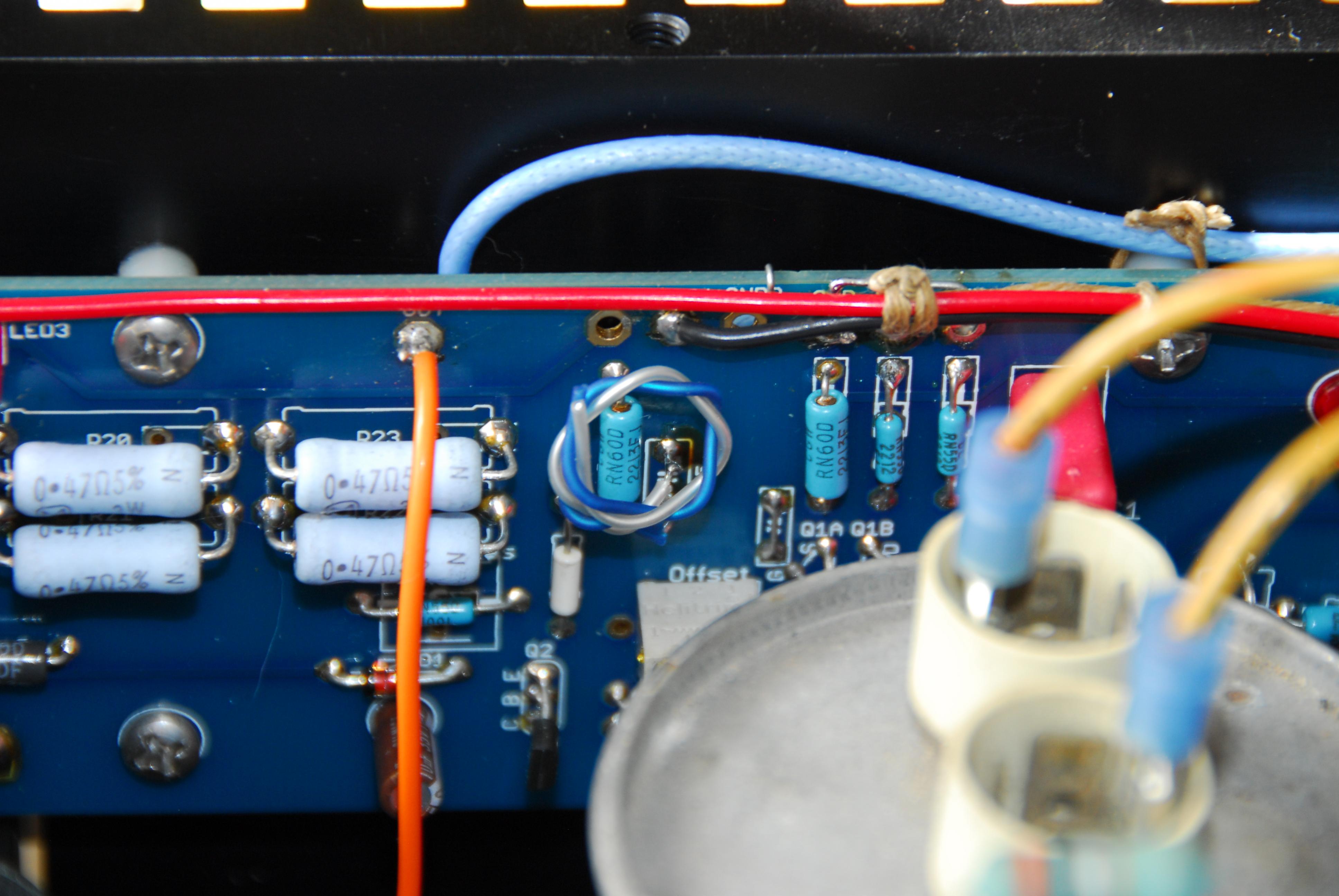

For those little 5pF caps I gave up trying to find the right cap and just made my own from wire wrap wire, but any nice silver plated Teflon or Kynar insulated solid wire will work, 22-26ga or so. I think mine ended up being about 1.25" long, just used 2 pieces of wire and twisted them together and tested with my capacitance meter. Cheap and easy.

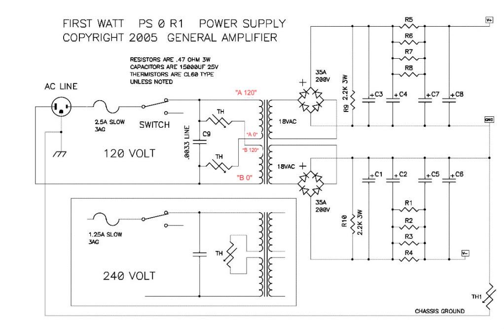

Read 6L6's build guide at the start of this thread (post #1). It describes the power supply construction. And yes, the diyAudio power supply board will work with this amp. The power supply schematic shown in the build guide at the beginning of this thread shows all the components needed.
https://files.diyaudio.com/forums/gallery/data/500/medium/F5PSUschematic.jpg
Also 6L6's power supply build board V3 build guide:
diyAudio Power Supply Circuit Board v3 illustrated build guide

Here is a higher resolution picture of the power supply schematic:
