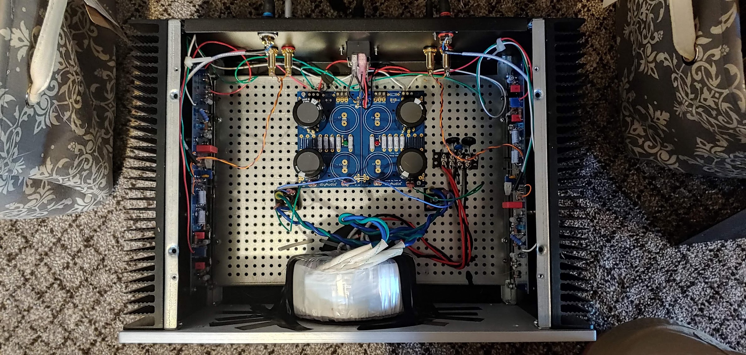

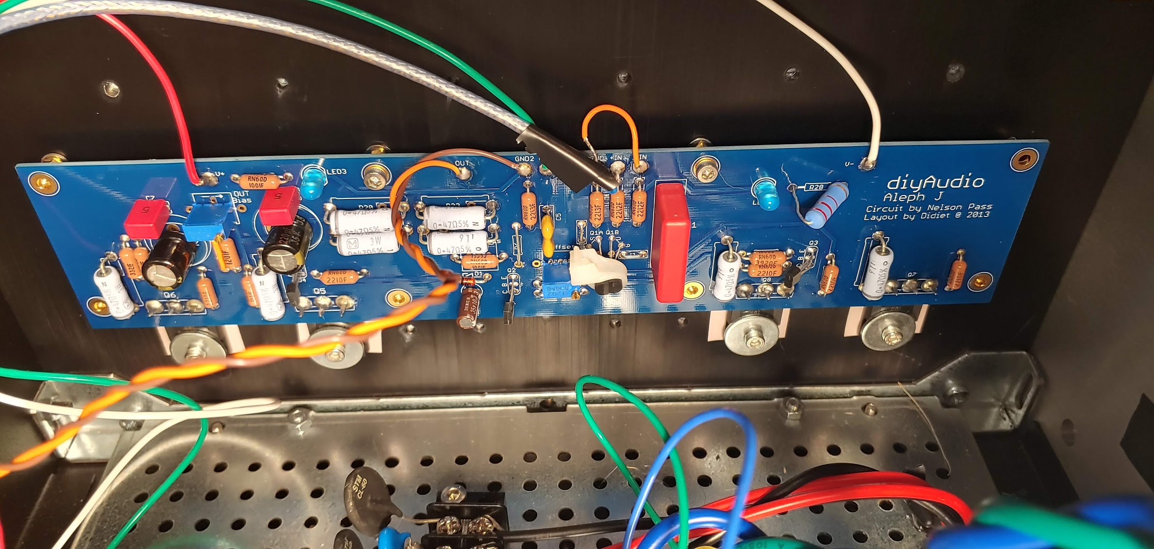

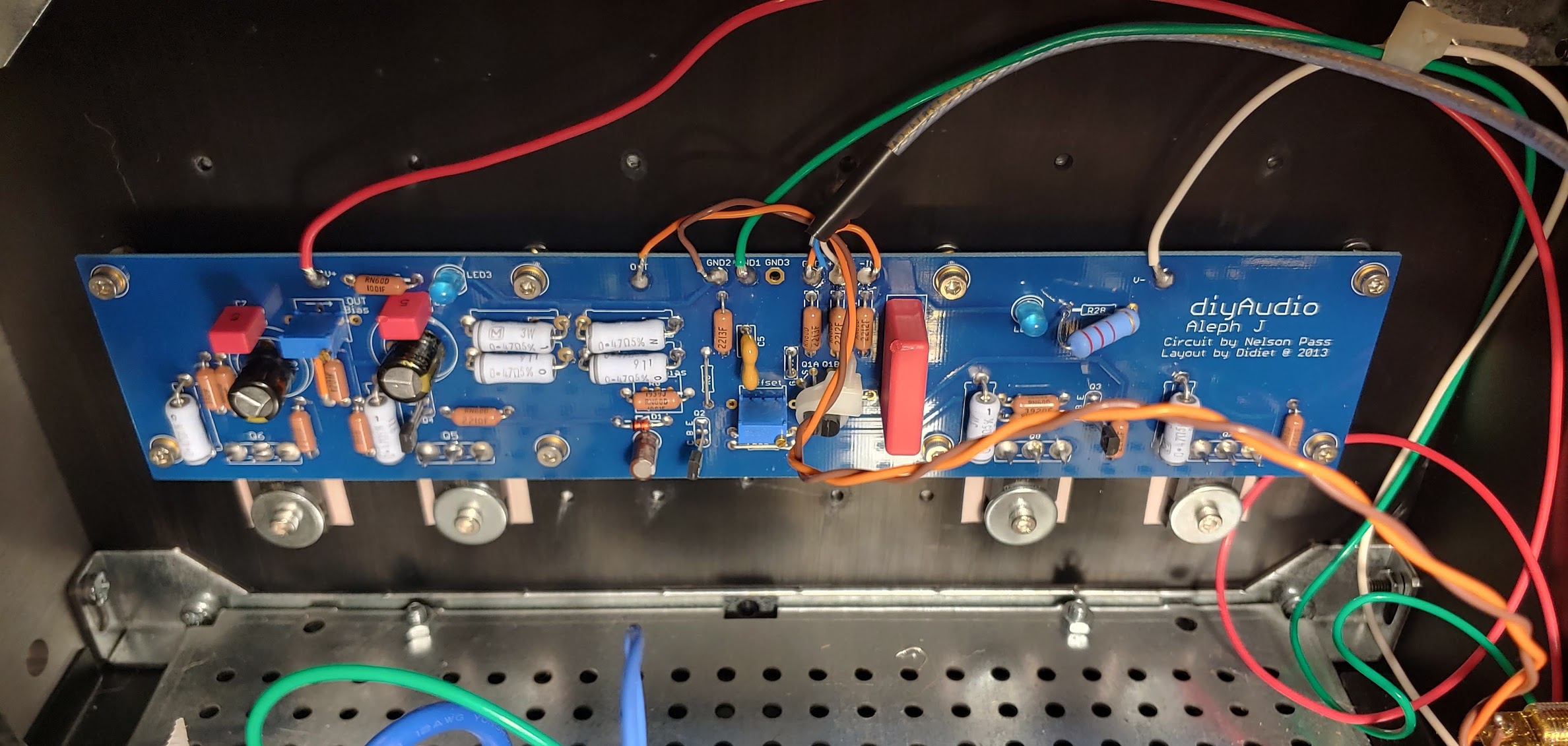

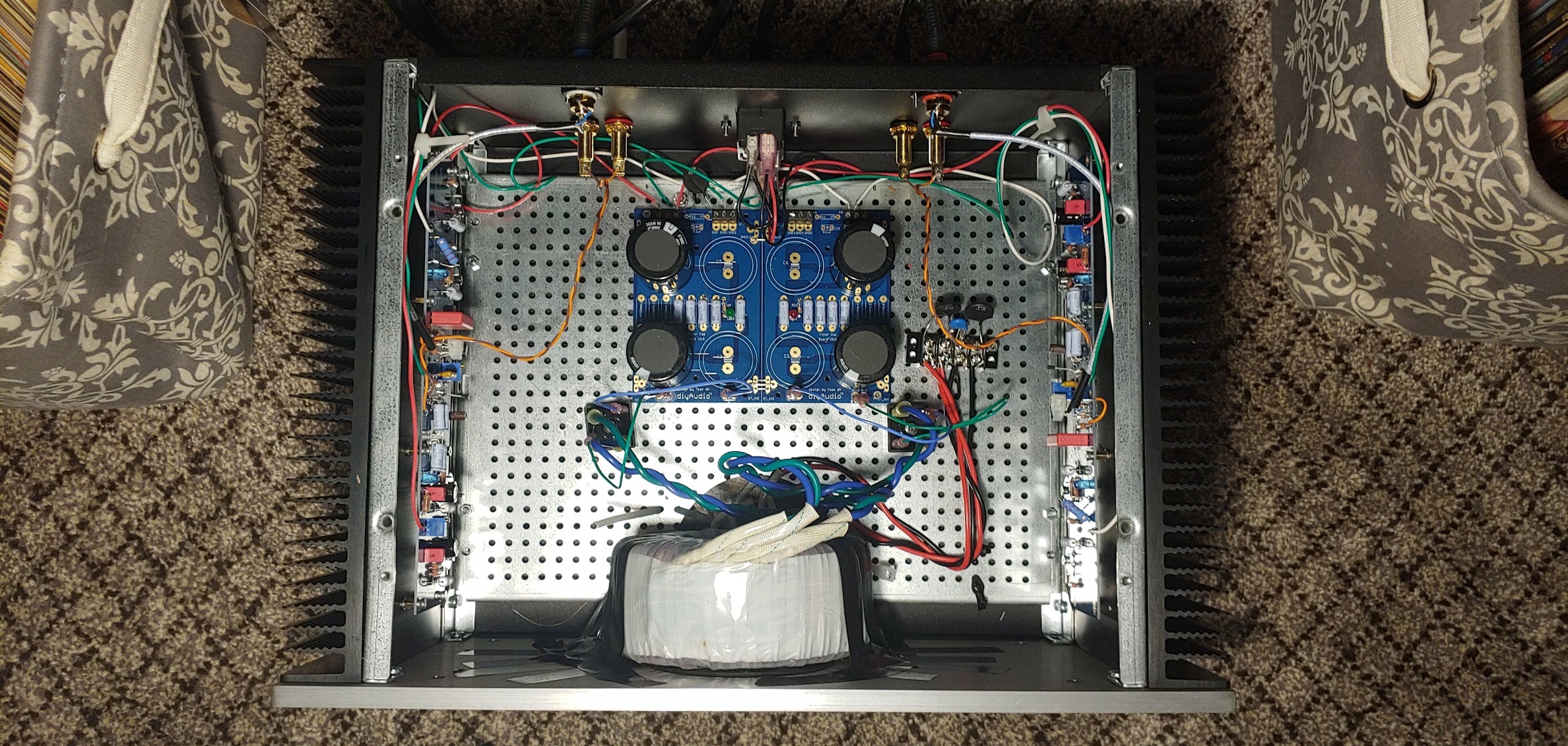

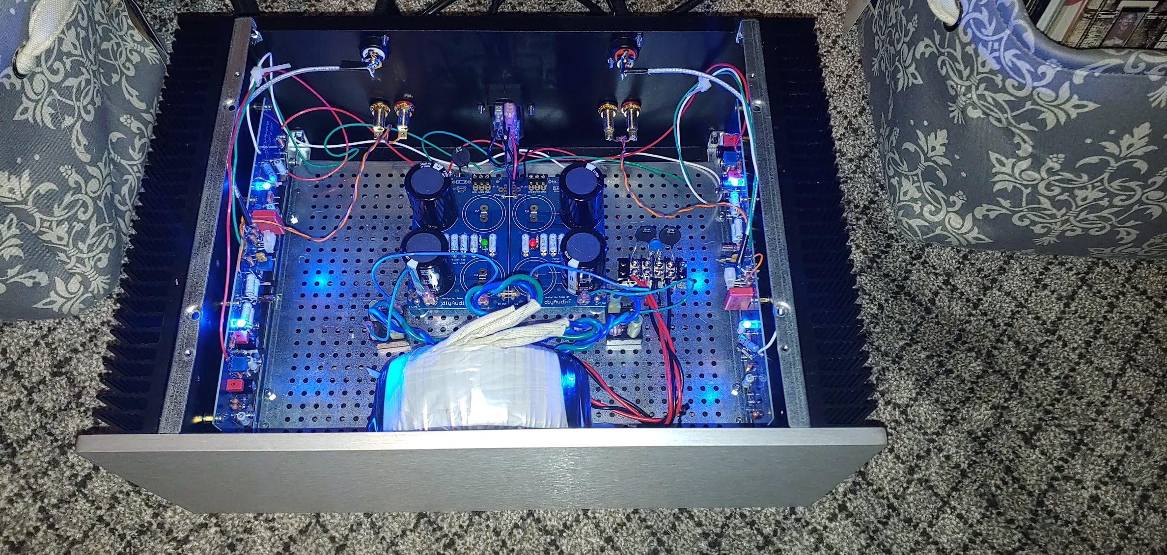

Thank you Rich, already had one on order and schedule for a Monday delivery. The electrical tape was/is very temporary to hold the toroidal in place as I was arranging the amp and connections.
I also just noticed I have the speaker outs running behind the input in my last picture. Not ideal but as I mentioned in my previous post, I have dead silent background so I am not going to bother at this point.

When you get the metal bracket for mounting your transformer, make note of the orientation as it is currently, and try to remount it in the same orientation. It is likely that you found a configuration that was less conducive to producing hum.

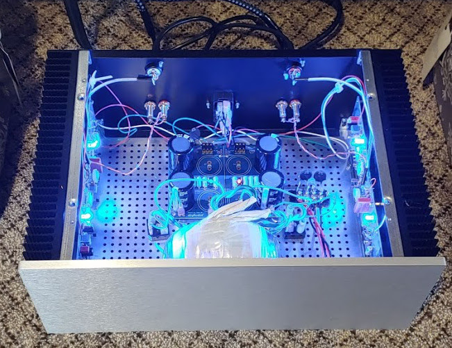

Oh, and the unpopulated cap locations in the PSU are driving me nutz. That’s my problem, not yours, but you do have an opportunity to try something. After you have had a few days to listen to your new amp , try installing some high quality* capacitors of 2200 uF or 4700 uF in those empty spots. Listen to the amp some more.

^ This is about providing a low impedance power supply over a broader frequency range. The larger capacitors, such as used in this most recent example, do an Ok job at energy storage and at setting the dominant low frequency pole for the amplifier, but they do become more inductive at higher frequencies. I think this is more an issue with large bulk caps in the 33mF range and up, where builders tend to use a small number to get the total capacitance figure. I have found noticeable improvements when adding smaller value caps, preferably a decade or more apart in capacitance to improve the overall filtering of the power supply. Reducing the capacitance by a factor of ten increases the self-resonant frequency by a factor of about three, or more due to reduced inductance of the physically smaller parts. Since smaller capacitors are less expensive, it is easy to use high quality parts designed for audio use.
This is a well understood phenomenon in the computer electronics industry. Capacitor manufactures have published white papers on the subject. Admittedly the frequency ranges are quite different (MHz vs kHz), but the concept is the same.

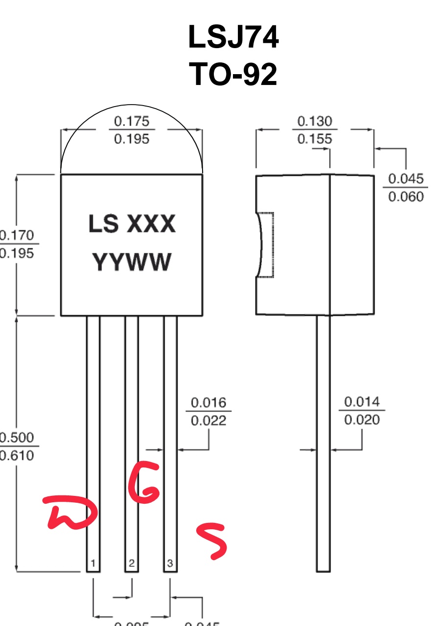

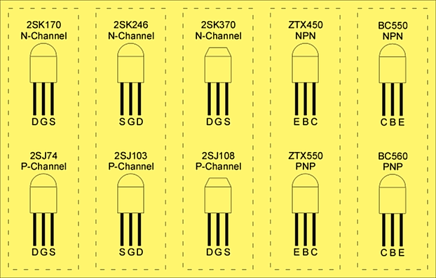

I edit old picture with transistors pin details.
Old one was blurry and pain to watch.
Feel free to save.
Thanks, mate

The recent picture showing the PSU had only half of the capacitor locations populated. I suggested filling the empty locations with smaller value parts. Similar to what you recommend, a combination of large and small value capacitors.I wasn't asking about that.
