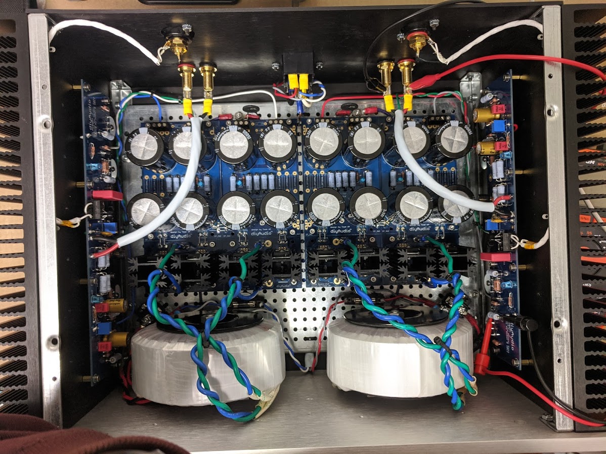

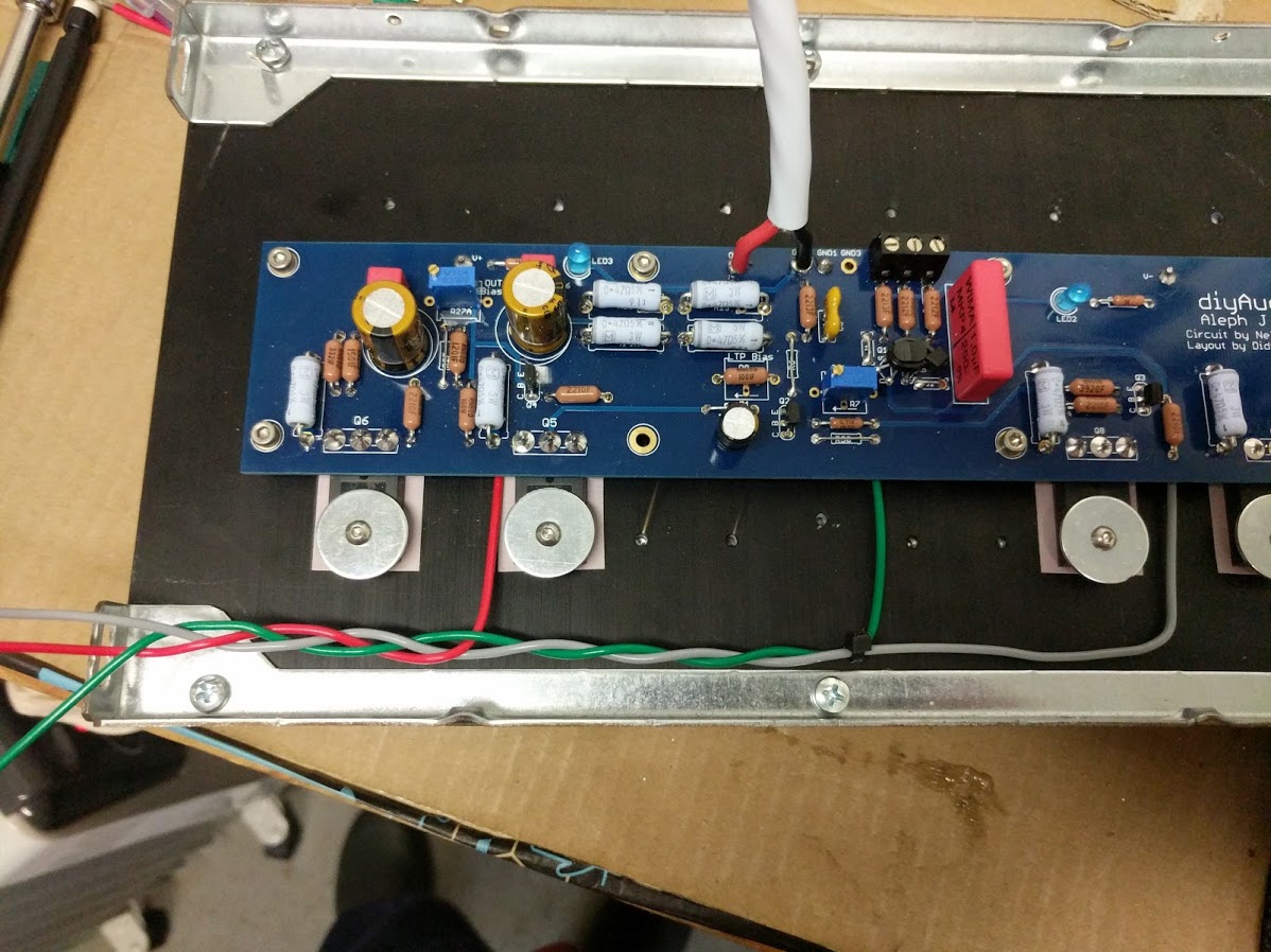

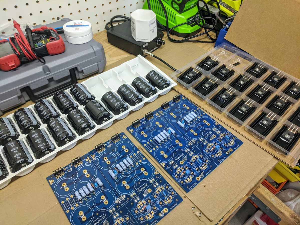

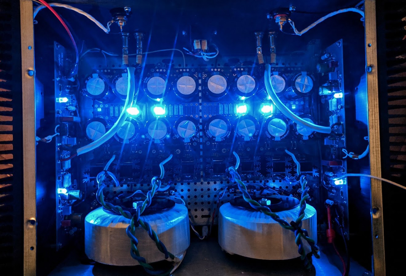

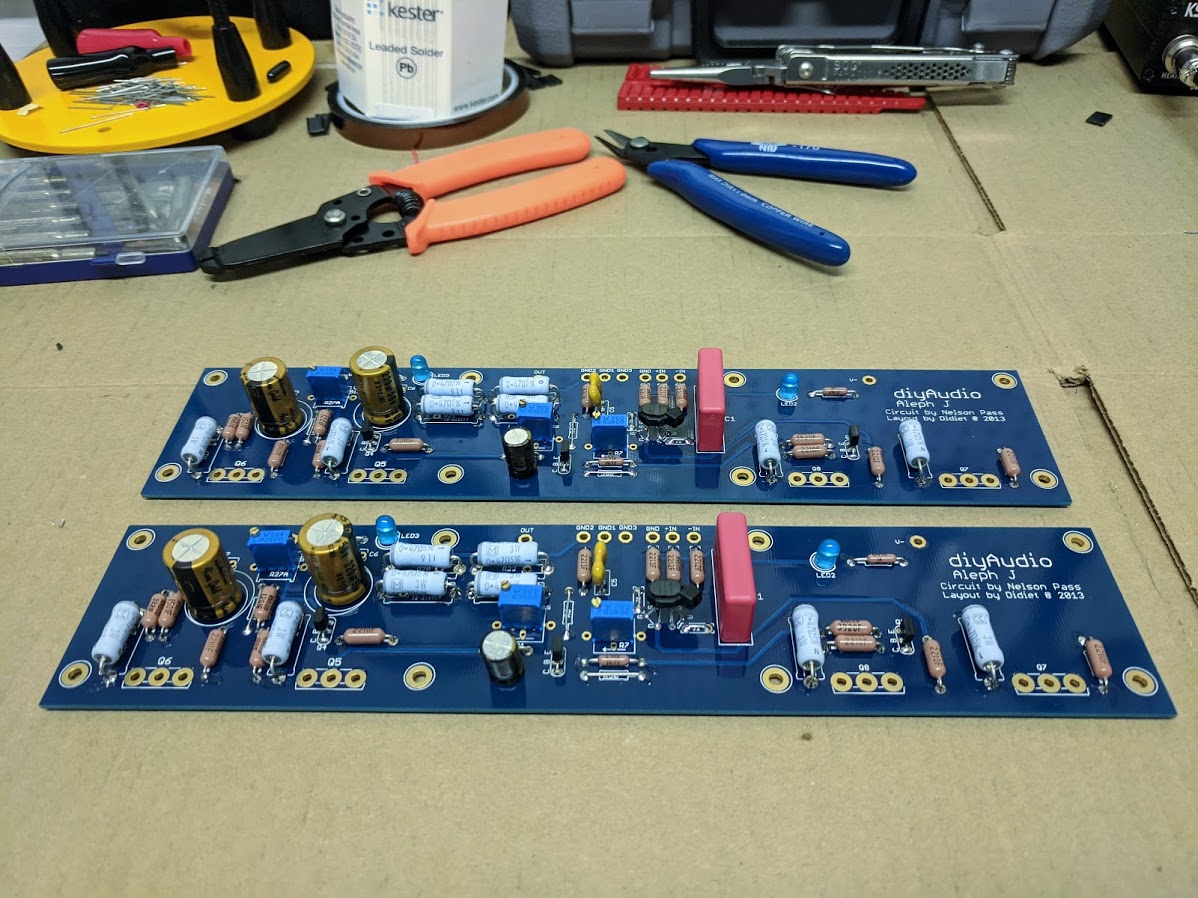

Another Aleph born! Was honestly semi-dreading powering it up for fear I'd be unfortunate and have to troubleshoot a problem with everyone's kind help here. Got lucky I suppose in that the first time ever picking up a soldering iron for real that everything worked. Posted a thread here with some things that I learned applicable to any build but thought I'd come here and share a few more photos of the build and to share the full google album to this thread if it might be of any help to anyone.
Thanks of course to 6L6 for his efforts and willigness to talk to me and answer a couple of clueless texts on the way.
Also will note that for new builders, and I can only reference my build, but don't worry about the turn off/on thump. It is extremely soft and gentle on my 98db speakers.
edit: Note that I have the WRONG pot in R8. It is replaced with a 1k resistor.
Also note that the BOM on the store is out of date. Please use the one in the first post of this thread!
Maybe someone can get them to update it at the store? I know I've read at least 4-5 posts in addition to mine noting issues with the build due to this error.

Awesome build!! I LOVE my AJ. Congrats. What are you building next???? :D:D
Thanks you and ha on what next!
Not sure at this point. The aleph is dead quiet for me but does amplify a small hum I've had on my preamp that has never bugged me until now with a little more power.
I did intentionally build this dual mono with the thought of building another amp to create switchable monoblocks and not have to worry about building a matching PSU later. Still not entirely sure if/when/what that next thing will be but have been considering F4 and M2X w/MV. I'm open to suggestions :).
Though I really do need more time to listen to the aleph to see what I think. Lots of things to enjoy about it but the 45 tube amp while low in power does really excel at midrange and presence.

Nice build Pechelman! I ended up stacking my PSUs, but good to see I could have gone with this layout too (I debated it.) I’ve built a few other amps, but I always come back to the AJ. A fantastic sounding amp. Another +1 for the F6 as a great compliment to AJ.
Yes it’s a 300va, 2x20v toroidy audio supreme. Mine is also mounted vertically like yours but the only difference is mine faces the inside of the chassis while yours faces the front plate. Maybe it isn’t getting enough cooling facing in that direction
This morning, I reversed the mounting bracket so now my transformer is facing the inside of the chassis, like yours.
Temperature after 7h is now 60°C. That's 6°C less then before.
Well, I'll stay like this for the time being (after all, I had no problems for 5 years). Maybe I'll buy a 400VA Toroïdy after the lockdown.

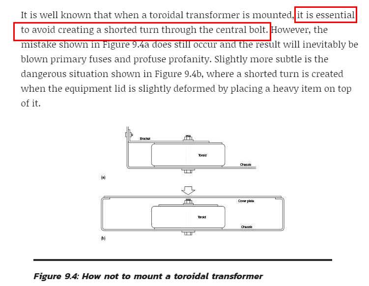

You may want to plug your amp into an AC mains wattmeter similar to this one on Amazon's French website. If your transformer is heating up because your mounting system accidentally creates a "shorted turn", the wattmeter will show abnormally high mains power.
See Figure 9.4 of this article by Douglas Self for an illustrative example.

I could try the wattmeter. Good idea.
The mounting of my transformer is really simple: it has a threaded hole so I just put screw in it to mount it on the bracket.
