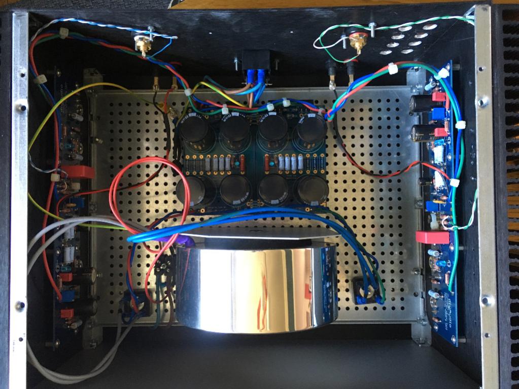

Today, I took the opportunity of the containment to open my AlephJ to clean the dust inside (after five years of service, there was some:D).
I noticed that the sticker on the Toroïdy transformer slipped because it seemed that the glue melted. So, after checking bias and offset settings (both were still OK, no drifting after 5 years), I decided to checked the temperatures in my amplifier.
After 1 one hour (the time to check the settings), the transformer suface temperature was 50°C and inside air temperature was 39°C (measured with a cooking thermometer).
After 7 hours, I measured 66°C on the transformer and 43°C inside the amplifier.
My amp is a "classic" DIY AlephJ, nothing fancy, I just followed the BoM given in the first message of this thread. Same with the PSU:
The transformer is a 300VA Toroïdy Supreme Grade (so it's encapsulated in epoxy and have a metal case).
Diode bridges are 35A Vishay (GBPC3502-E4/51 Vishay Semiconductors | Mouser France)
Here's a picture of the inside:
Do you think I have to worry about the transformer's temperature?

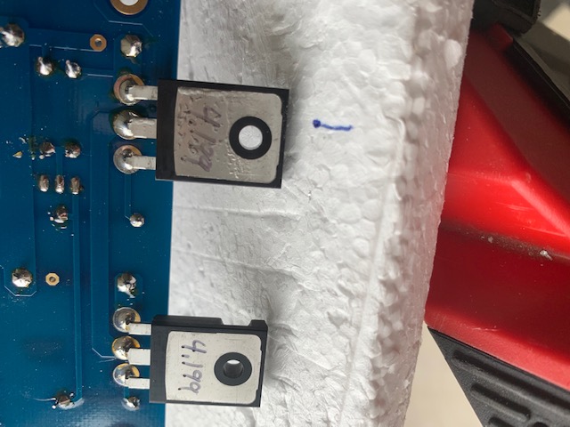

ItsAllInMyHead,
Thanks for the suggestions. I'm still having the same problem. I've made some notes based on your comments, below,
1. I've installed the 1k resistors.
2. Passed the dim bulb check unloaded.
3. The unloaded voltages were all the same 25.6v and look very good.
4. I didn't see any shorts. kilohertz comments noted I should trim the leads, so I did that where potentially appropriate, too. I checked the keratherm and there were some scratches/tears in two of the pads so I replaced them. If you see the attached photos there is some bubbling on the underside of the transistors where the keratherm was bad. Does this mean these two transistors were fried? I had originally purchased these from the DIYAudio store in Aleph J kit, matched.
I powered up the amp with one board attached at a time. The good board is still good and passes the bulb test. The bad board is still bad and the bulb stays lit.
Next steps?

ItsAllInMyHead,
Next steps?
/d
1-3: Great news.
4: Rats. Yep, you most likely have at least one blown output device due to (maybe) the MOSFETs shorting to the heatsinks. It's odd that you didn't see a short in your testing prior to running the dim bulb check on the "bad" board. Did you check it before or after re-mounting with the new Keratherm? If there was no short to the chassis from (likely the drain / pin 2) - then that points to a different root cause somewhere else possibly. The heat from the MOSFETs going up could have caused the holes or the holes could have contributed to the MOSFETs going up.
Out of an abundance of caution, I should let someone else recommend next steps. I am unsure how (or if) the MOSFETs can be tested in situ. Before advising to replace them due to simply looking at them... someone may have a suggestion for checking them while in place or even after removing them to see if you need new parts.
If it comes to replacing them - I'm also not exactly sure how tightly they should be matched. That writing looks familiar, so I'm guessing you got a kit from the store and don't have spares? Either way, you'll get it sorted soon. Someone will chime in soon with suggestions, I'm sure.
Best of luck on getting it fixed! It's truly a wonderful amp, IMO.
By shorts I assume you mean the the leads were touching the heatsink. No, there weren't any I saw. But then again, I can't see through the MOSFETS to the keratherm where damage may have occurred because of tears/holes in the material.

This morning, while reading the BA-3 build guide, I found something interresting concerning my transformer's temperature:
TRANSFORMER = The amplifier’s total bias (in Watts) should be no more than 1/2 the VA of your transformer.
How do you determine watts? Simple - measure your bias current, the voltage drop across the 3W source resistors. Let’s say you measure .3V . Divide that by the value of the source resistor. If using 1.0 ohm, your answer is then .3A (.3 / 1 = .3) — but if using 0.47ohm resistors, a voltage drop of .3 is now .64A (.3 / .47 = .637) Back to the example using the 1.0 ohm resistors, multiply by your rail voltage, 32V, so each device will have a bias of 9.6W (.3 * 32 = 9.6) then multiply by the number of devices - 12 in this amp, (12 * 9.6 = 115W)
For the AlephJ, the calculation is:
(0.4/0.47)*24*8=163W. So the transformer should be 330VA minimum, if I understand correctly.
Mine is a 300VA, so a little bit under the minimum recommended VA. Do you think it could be the explanation of the fairly high temperature I measured?
I don't know how to test the MOSFETS. Is there something in one of the boards how to do this? I couldn't find anything because "test MOSFETS" gives way too many results. Jim had something one for testing other kinds of transistors with a 9v battery and a volt meter, but i don't know if it would work here.
Frankly, this is really frustrating. My M2x (and every other Pass project I've completed) is running without any problems whatsoever, and I can't get this channel working no matter what I do.
Thanks,
/d
Nope - I meant - Taking a DMM set to continuity (or similar) and with one probe on the heatsink or touching one of the mounting bolts for your MOSFETs or anything running to the heatsink and moving the other probe between all 3 legs of the MOSFET. It should show "Over Limit" and/or Not Beep. It's not a visual check.
You'll need to wait for someone with a bit more brains than me to help you sort how to test the MOSFETs themselves. If it were me... I'd yank them and test them. There a a few methods I've read, but even I would "phone a friend" and wait for an answer from someone here that can definitively provide a solid approach. In the interim - Papa has a ton of great articles on the First Watt site. I have been slowly moving my way through them. Some are still over my head, but I learn a bit each time. This one may be a good one to get you going if you haven't read them yet.
http://www.firstwatt.com/pdf/art_mos_test.pdf
The only two methods I know are the "DMM set to diode" test for a super quick "is it totally toast" and running each of them through a check for Vgs described in the article above. It's also how I learned to match MOSFETs for Vgs (but I still am learning more and more characteristics). I'm confident there are better ways for you to check. Someone may even have a suggestion for how to check them w/o removing them. My guess though is that sadly, they're probably toast.
Yep, it's frustrating. My first few builds went well, until one didn't. :D I was told releasing the magic smoke is a right of passage. It still sucks every time I do it. However, every time I do it, I learn a bit more about how the circuit works, I'm a bit more careful in understanding the schematics and asking questions on my next build, and I get a bit more knowledge re: troubleshooting. So, there is an up side.
If I spot anything from a reliable source re: testing for this specific situation, I'll post. Did you read back in the thread? I can't believe you're the first to smoke a set and post about it.

One thing to consider is that one of each pair has shown bubbling on the
back. So even if that mosfet is not toast, you will have difficulty getting full contact
with the heat sink, and it will likely eventually fail.
I think it's likely will you need two new pairs of mosfets. :(
Fortunately IRFP240 is a common part so it should be easy getting
new pairs. Alternatively you may take this as an opportunity to
learn to measure and match mosfets. Make lemonade out of lemons.
I know it's frustrating, but you will get this working eventually.
Your transformer may be running a little hot. I have the same transformer in my Aleph though I’m running mine at slightly higher rail voltages then most. I’ll swap amps out this weekend measure the temps on mine and report back
After I posted my last comment I figured I’m working from home so why not just plug the amp in and let it bake. I had it one for a little over 6hrs. I have my bias at .420 and run mine hot to the point my sinks fluctuate between 55-57 degrees Celsius. My unloaded rails are a little over 29 volts and after measuring the temp on my transformer, it got no hotter than 50 degrees Celsius
