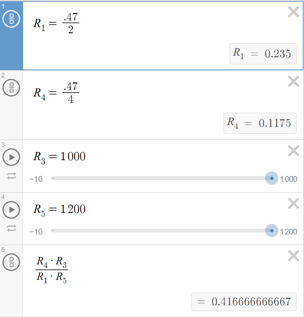

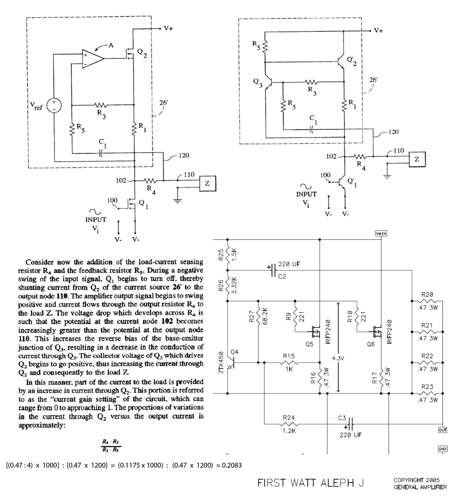

I considered Nelson's patent US5710522 for my calculation. I looked at this paper before I decided to build Aleph J, to figure out the "AC gain" everyone was talking about. The more I look at this AC gain, the more I realise its trade-offs... Is this amp a single-ended amp? That's the first question I've been asking myself recently. Furthermore, I know for sure that, by removing the 4 X 0.47ohm resistors, and replacing them with a nice piece of copper or silver ribbon on the PCB, will do wonders for my speakers. This could qualify as a second question, but to this one, I already know the answer.
The amp is an absolute stunner, but I firmly believe that, albeit the price I'll pay re efficiency, I will gain a lot in sound quality - by disabling the AC gain. But, it has to be disabled by removal of the 4 paralleled resistors - this will provide a two-fold benefit, compared to just removing the R24, for example.
I have tried to extract the important bits from the patent, and place the relevant (I hope!) Aleph J schematic -> to be able to do the simple calculation. So, I arrived at 20.83% "AC gain", provided by the CCS.
I think the math works out a little differently in the case of the Aleph J. When there are two parallel outputs, I believe "R_1" is defined as the parallel value of the source resistors. Making this change, we get the 42% number:
NP states in the patent that the equation is only approximate, so it makes sense that we would see slight variation in practice, so I feel comfortable with either 42% or 38%.
The difference between the simulation - 38% - and the simple formula could be attributed to the following explanation:
As I commented to macka privately, the formula ignores the transconductance of the Mosfets in the output
stage, using a simplified assumption that the transconductance is very high, and not dealing with parallel transistors.
This results in an apparently higher gain than found in the real circuit.
We can always check our work by applying the calculation to an Aleph 2 - we have on good authority that its current gain is around 50%:
Actual current gain on an Aleph 2 is close to 50%.
