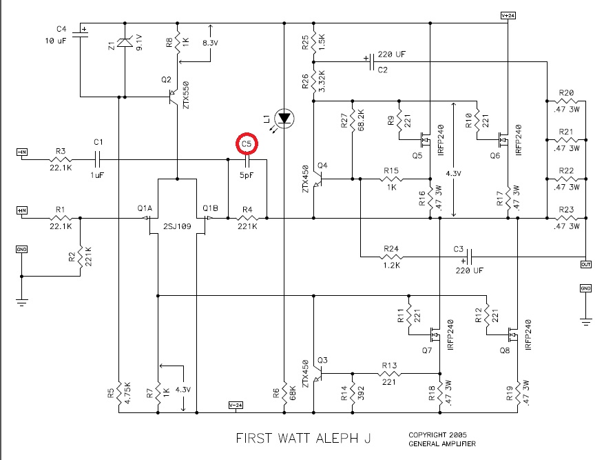

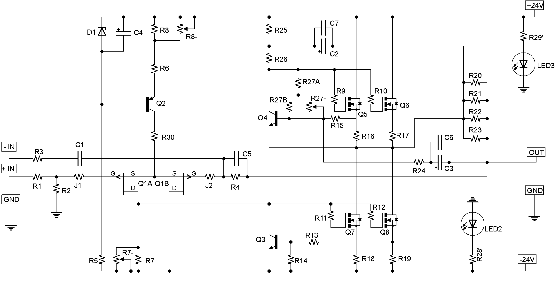

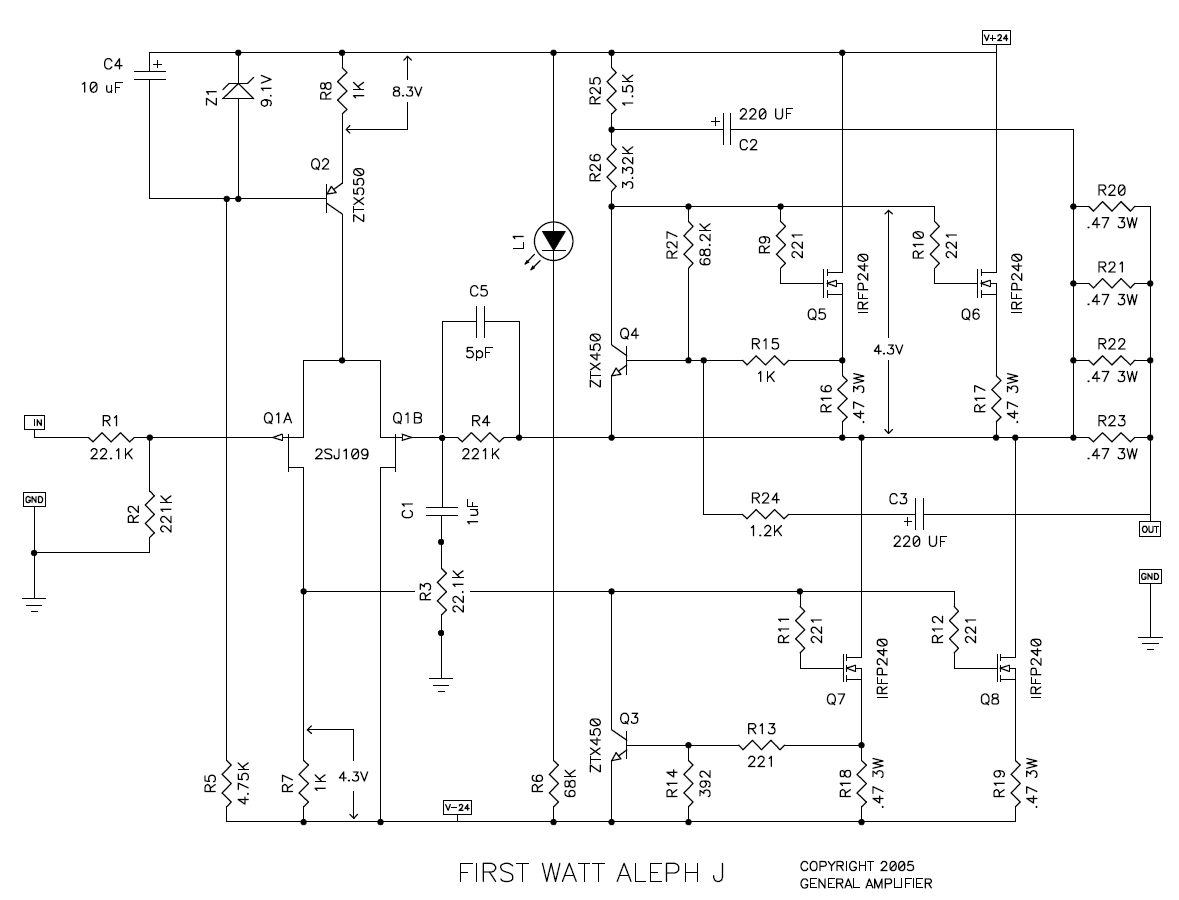

Looking at the Aleph J schematic, the inverting input shows a coupling capacitor, whereas the non-inverting input does not. I have seen this in some other schematics, too. What is the purpose of the capacitor in the inverting input? Why do some amps use is, and others don't?
I wondered about the same thing myself....

Hence, I took the liberty of modifying the balanced-IN, to a single-ended-IN section of the original circuit diagram

Do you want to amplify any DC that might be present at the input? What about subsonic frequencies..?? Do you enjoy watching the bass membrane moving at few hertz?
The capacitor helps roll-off the gain to unity (no gain) at DC, so that only the desired spectrum (20 - 20kHz) is amplified at a full gain.
Why is the capacitor not always there with amps that have a similar input stage?
If you come across such an amp, post the schematics.
Aleph J is also DC-coupled (but intended for wide masses, even un-initiated ones...) - hence the need for the capacitor C1.
Mighty ZenMod intended his amp for those who have been initiated, those who supposedly do know what they are doing, and trust their pre-amps / sources.
.... however, accidents do happen, so I think it is really wise to keep that C1 as an idiot-proof, safety precautionary measure.
It's important to understand that the C1 is in signal path even if Aleph J is wired for a single-ended input (RCA input); its quality is as important as if it was placed at the input, as a "series" capacitor.
