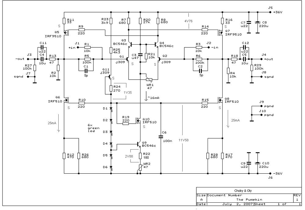

Did you adjust the offset in two directions, between one output and ground and between + and - output, otherwise you get clipping.
And you know the offset is not stable, it may change between + and - 100mV all the time.

normally the thermal floating influences Q9 and Q10 of pumpkin and let us suffer from the considerable drift smario describes.....
you have really a difficult situation with your pumpkin and I hope that Zen Mod can give you more advice....

enclosed an older picture with voltage values from the original pumpkin thread, mind the difference around the LEDs in the circuit.... and I do not know how the two new resistors that should influence the drift influence the voltage values..
maybe Zen Mod has a newer picture....
