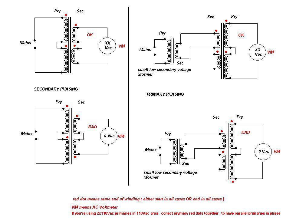

ok now
just one biggie xformer is enough for preamp
one 50Vac secondary to first channel AC input
second 50Vac secondary to other channel AC input
auxiliary voltage - 2x15Vac xformer to appropriate AC input on pcb ; if windings are separate , phase them as per attached tutorial (look at left side of sketch) , to have proper gnd (CT) for that PSU
