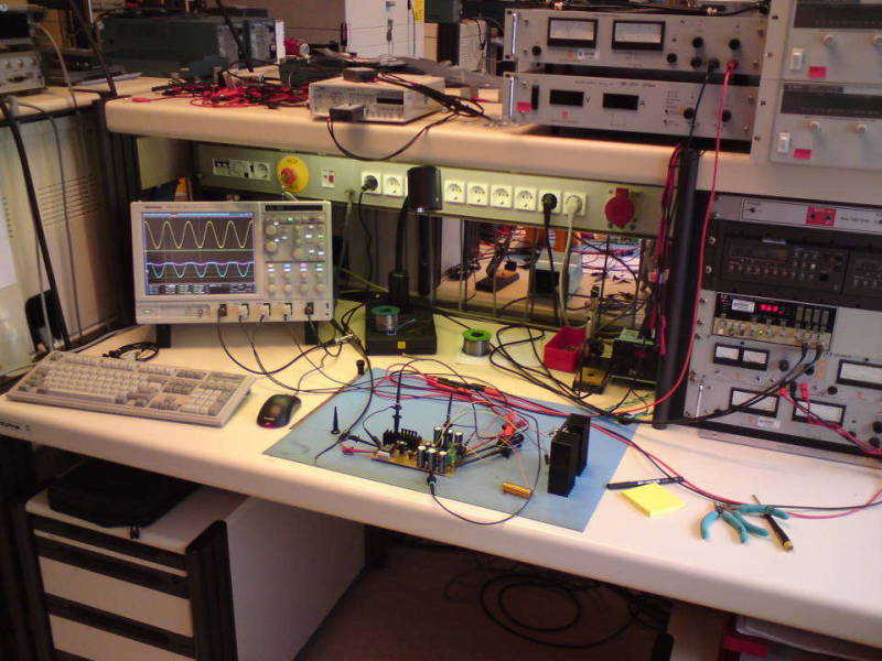

Please tell me why!
Why on earth does it seem that each time I post success in this forum on my A2 amps, reality catches up the day after...
While listening to some CD's, about an hour and a half after switching the amps on, number 2 starts to produce a noise again... Not a ground loop hum, more like white noise.
I quickly disconnected my speaker and got my multimeter downstairs. There is no consistent DC on the output. The reading changes between -10mV and -25mV which is still less than the -45mV on the number 1 amp. AC readings are below 5mV and below the reading capability of my DMM. The noise is audible, but very soft.
So, whatever theory is left, I don't know. I'm afraid some component may have had a jab, jolt or whatever, and may be prone to fail. I wouldn't like to see a catastrophic failure you understand....
I'm frustrated and disappointed, and I'm thinking to rebuild the front-end with brand new components for both amps, hoping to remove the failure.....
noise
Did you check for oscillations? You might want to poke around
your amp with a scope, before hooking them up to really
nice speakers. Check the Aleph Current Source around the BJT.
Check stability with a square wave input to see if there
is overshoot/ ringing on the edges.
If possible:
Check the phase margin. I.e. measure the frequency were your
amp reaches unity gain. Measure phase at given frequency.
Otherwise:
Measure -3dB bandwith. If larger then 100kHz, consider
increasing the cap accross the feedback resistor.
Do not choose the capacitor larger then neccessary.
In all cases it is smart to have the amps idle for at least 30
minutes before taking measurements.
Please do not be frustrated/ dissapointed. The "problems" are
(should be) part of the fun in the journey of constructing an amp.
Every problem solved means you (we) learned something
of value.
You could even take a break of two days away from the amps.
Then start measurements/ testing in the weekend?

Having lost some favorite speakers to an amp project turned R.F. oscillator I can heartily agree with the last post . And I have no on to blame but my own impatience, as I own several scopes.
If you don't have a scope let it idle with no signal for several hours loaded with a 4-16 or so ohm 1/4 watt resistor as a load and see if it becomes warm. Smoked copper is irreversable.

Anyway, just for an update on the process so far:
- I've swapped the front end of the "faulty" amp with the "healhy" one and it appears the problem moved with it.
- I checked the power supply with a resistor load and it remains symmetrical, so I guess the rectifier is ok and the problem was not caused by an assymetrical supply
I'll see if I can get the problem isolated with the scale model. I'd hate to blow my IRFP240's, because I haven't got any matches left.
Same applies for the IR9610's... If they appear to be the broken one's I'll need to get new ones and match them.
