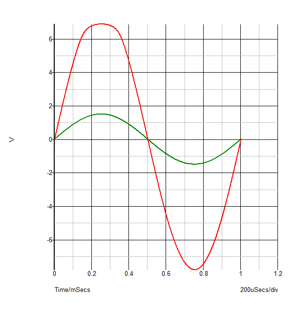

Looking at the picture in post 88 and considering:
(ref a2serv0.pdf, original service manual)
-You used the protective zeners z1..z4.
-You are testing with unbalanced input
-You did not connect -IN to ground during testing.
-You heard a pop
I would check the input zeners, especially z1 or z3.
I ran a sim to check my suspicion (z1 shorted) and the result is
very similar to your picture in post 88.
You could even consider removing the protective zeners
temporarly and test. Make sure you do connect all equipment
before power on of the amp.
regards
PS
In graph
Green is input 1.5Vp
Red is output

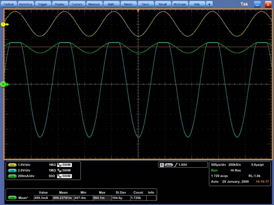

Re: Re: Re: Low Frequency settle
R19 is now around 80k. --> I_CCS = 500mA
Changing R11 doesn't change zero offset, but it's down to 50mV now
Clipping is still there when input exceeds 600mV or so.
Y'know, by now I have checked, measured and/or replaced almost every component on this PCB. There really aren't that many, and still the behaviour remains.
I'm going to leave it at this, and tomorrow I will bring in the Front end PCB of the still working amp. That way I'll have some comparison.

Re: z1,z2,z3,z4
Z1 - Z4 were one of my first suspects... Quite right, especially because clipping starts when the unbalanced input exceeds 0.6V.. precisely one PN junction.
However, I have removed Z1 and Z3 in post 74, and they haven't been back ever since...

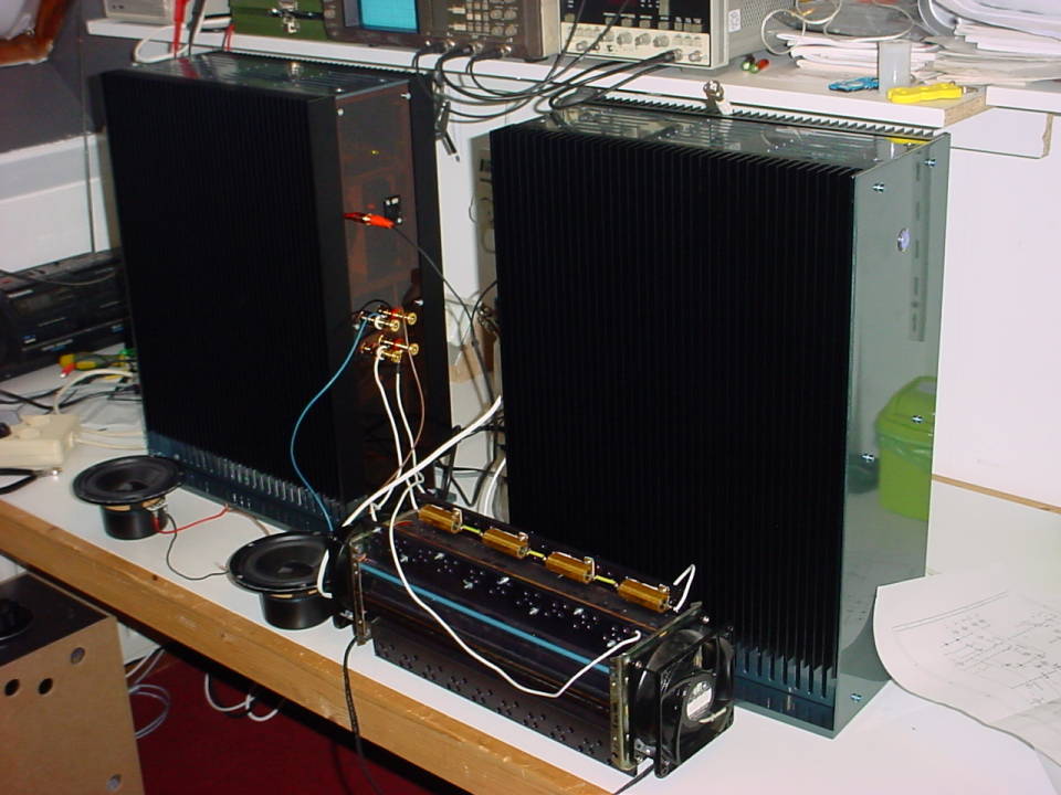

Preliminary tests
Well, actually I'm on the birthday of my little niece right now...
Yesterday night I intergrated the "faulty" PCB back into the main amp and ran it for about 2,5 hours on a resistor load. Performance seems nominal so far.... Tomorrow I'm going to do a full day burn-in trial on the resistor load.
To be continued....
To be continued....

Picture from the amps under test....
