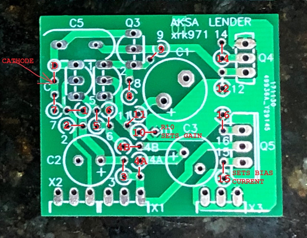

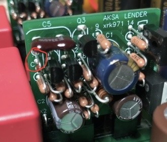

Can you confirm that the cathode on your diode faces the correct direction (towards the “C”)?

Re parts orientation and placement on DB's, I cannot categorically say that it is correct because the orientation of some the resistors is such that values cannot be read. The only way to confirm is to systematically remove parts until their orientation and value have been checked. Given the small size and very close placement of the components, this is likely to be a challenging exercise, but it may be the only way to locate and confirm the source of the noise.
