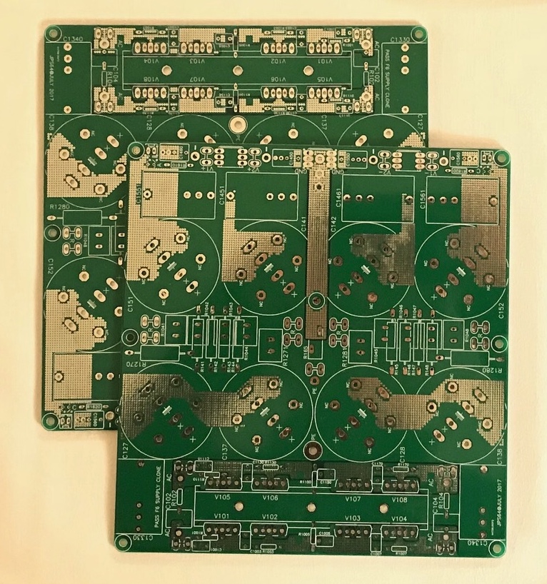

As I am currently running the 20W Alpha from a P2P F6 PSU with good results, I am wondering if I should build up these really sweet looking JPS64 Specials: F6 PSU PCBs with all the usual JP fixin’s :D
attachment.php
BOM here:
http://www.diyaudio.com/forums/attachments/group-buys/671731d1522310061-gb-jps64_f6_psu-zip
I could splurge and get 8 x 33mF caps per board or is 8 x 15mF enough? They were designed for a stereo 1.2amp per channel F6. The B.B. is about 3amps per channel so maybe 8 x 22mF might be more appropriate. But these are designed to be stereo PSU’s with dual sets of RC’s on the output. Will have to think about it. I might just use my Prasi/Project16 CRCs to start off the Beta test and save these for the final boxed build.
CDE 33mF 35v (manufacturer number 339LBB035M2EH) are $5.50ea. Hmm...

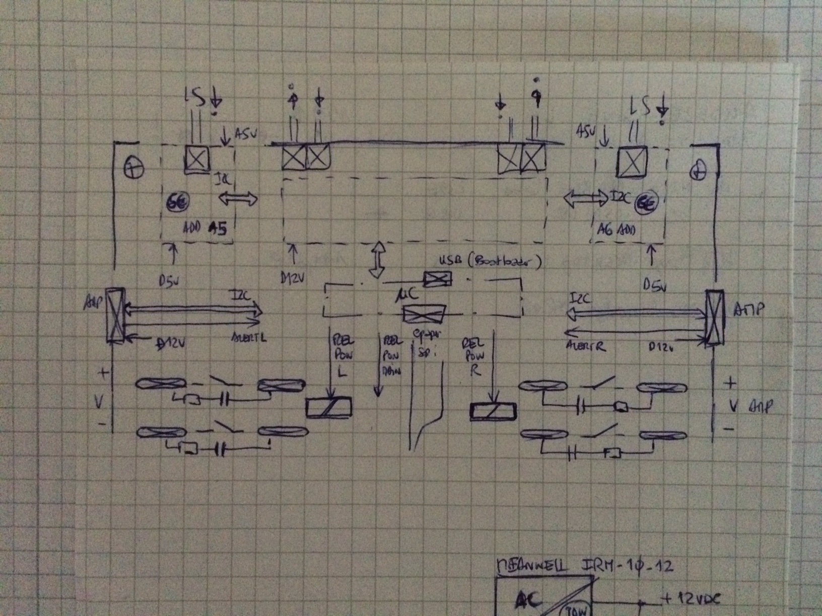

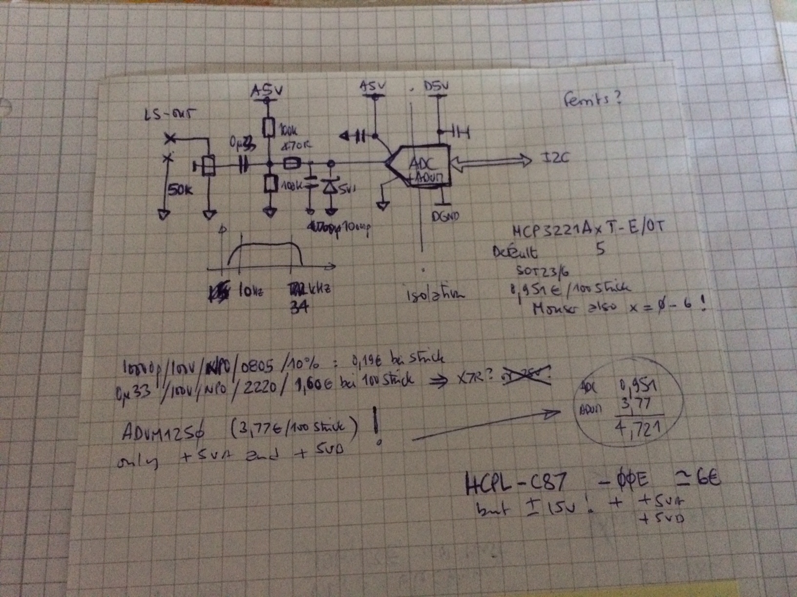

After busy week, still working on ALPHA BB controller board:
- HCPL-C87x voltage sense or 10/12bit ADC + ADUM1250 (I2C)
- R2R relays attenuator (front encoder + IR receiver)
- I2C fan boards interface
- epaper 3 colours display (>= 4.2 inches)
- main power switch and R/L secondary power amplifier DC switch
- DC blocking electronic
- CL60 inrush current limiter
Arduino board or Atmel microcontroller solution not fixed yet.
I hope fixing and finishing prototype during Eastern.
JP

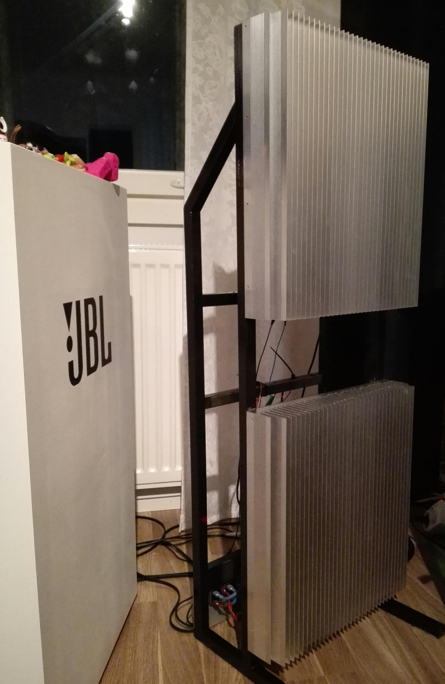

Had to try Alpha with passive cooling..I know X like skeleton cases too :D old frame and stuffed Alpha gear in, took about 3 hours of drilling, tapping and working couple of wires. CapMX is in lower section, and it really warms up comparing to upper section that contains only one channel of Alpha. Sorry about bad picture, listening it atm, speaker- and signal wires aren't attached very well. Prototyping is ready now, next I have to give new looks for the frame and that's always the hard part..paint in the frame didn't like heat and it's mostly burned, have to remove it somehow before working further.

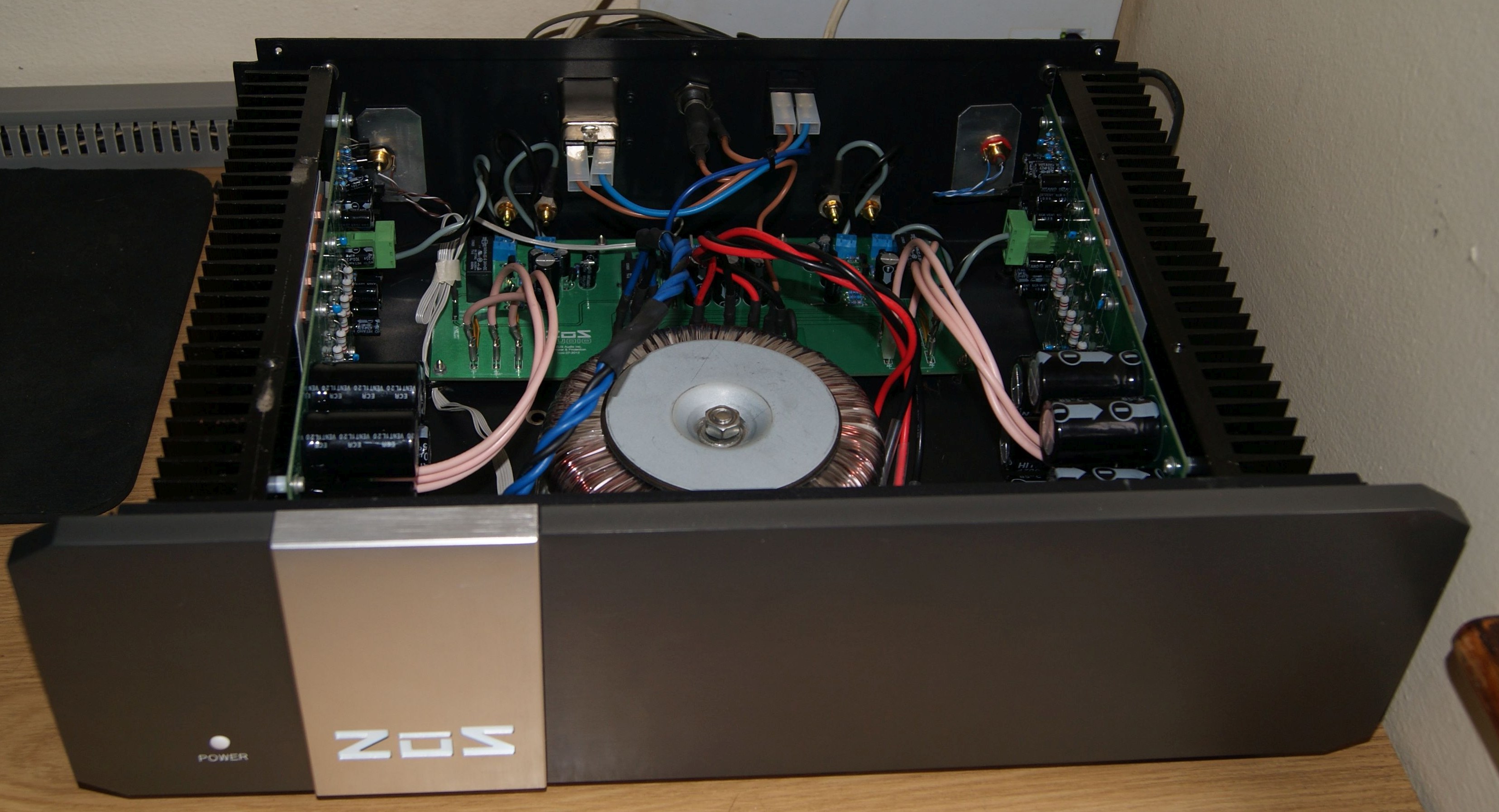

Here is a protection and power control I did for commercial amp ZUS in 2013.
Maybe it is a good kick-off point or someone might just want to make it as is. There are PDF plots so you can see what it looks like and PIC micro source code and Gerber plots included. Sorry I use EasyPC 10. :)

The capmx gets hotter than ALPHA, mmmmm, something oscillating ?
I have no idea, never had any build oscillating before? I'm running original, bigger bias.
Just to be clear, lower sink gets warm after 2 hours, upper a little less. Nothing compared to previous 60w Aleph that use to populate these heatsinks, those were hot, these are warm :)
Edit: and paint burned when there were Aleph 5 dualmono inside.
It is hard to tell if/when a single ended amp oscillates just by the temp simply because it is already hot. I would say thermal runaway or bias is shifting is more likely.
Is there a way to tell for sure, without owning an oscillator? Don't really even know anything about oscillation, haven't even thought of that since this is so easy, nice and simple build :D
