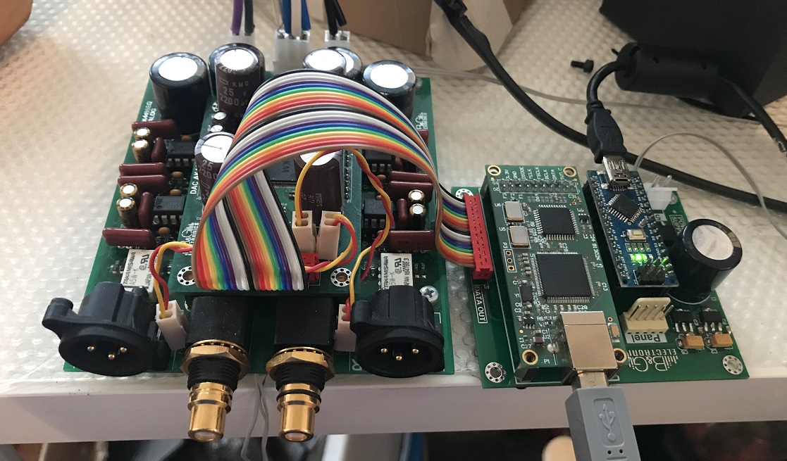

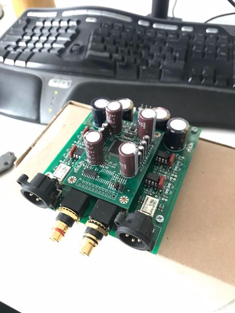

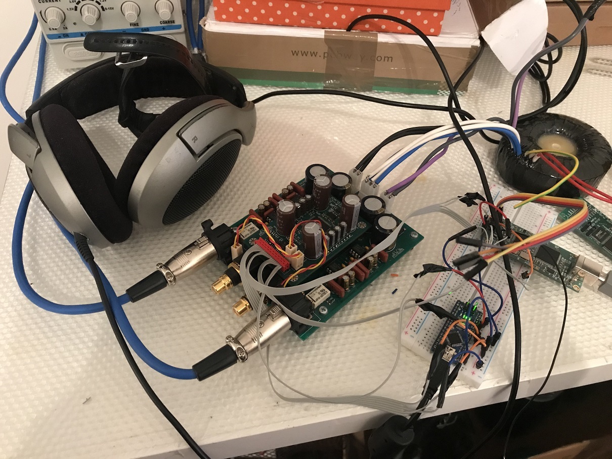

AK4499 DAC Design
Its diy board but I think I just figured out the issue, I was writing the register value in the arduino software as binary but it needs hex.
Weird that it could cause such a problem vs just not work at all.
Working okay now?
The Arduino program I use reads back the data after its written then displays it in Decimal, HEX, and Binary. Makes it convenient to confirm what was written. I think that stuff is in the code that I shared before.
Seems to be.
Your software does this automatically or you programmed that?
My sketch is about as basic as it could be right now, couple lines to write the values in first register for input format and disabling reset state (which somehow worked with the broken binary register value) and set volume registers.
The latter. Display in different formats is easy, there are formatted print options in the Arduino language.
Originally the program only accepted decimal input through the Serial Monitor port, a recent upgrade allows it to accept hex input too. Also added some options to preset all the registers in a device, with support for multiple devices. That stuff had to be coded.
Was it not Deemphasis mode accidentally turned on?
That happened to me once, and the behaviour was exactly like that, severe high freq limiting..
(registers 01H, 0AH)
I have a lot learn with the arduino, I was just hasty to actually test if the DAC worked, the plan was to use it in pin control to begin but the PSN pin was accidentally connected low.
Deemphasis must've been the cause , my binary value of 00000001 when it expected hex gives a binary value of 00000000000000000000000000000001 , that 1 looks like its probably the deemphasis bit.
Finally my DAC AK4499 runs :).
