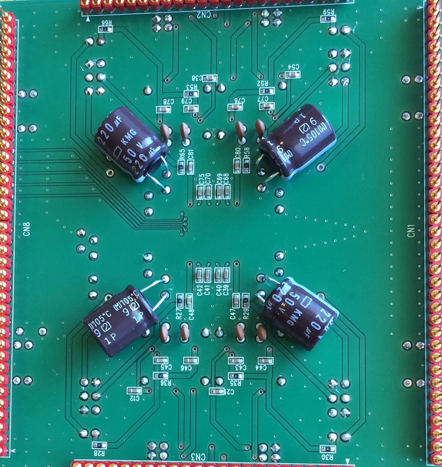

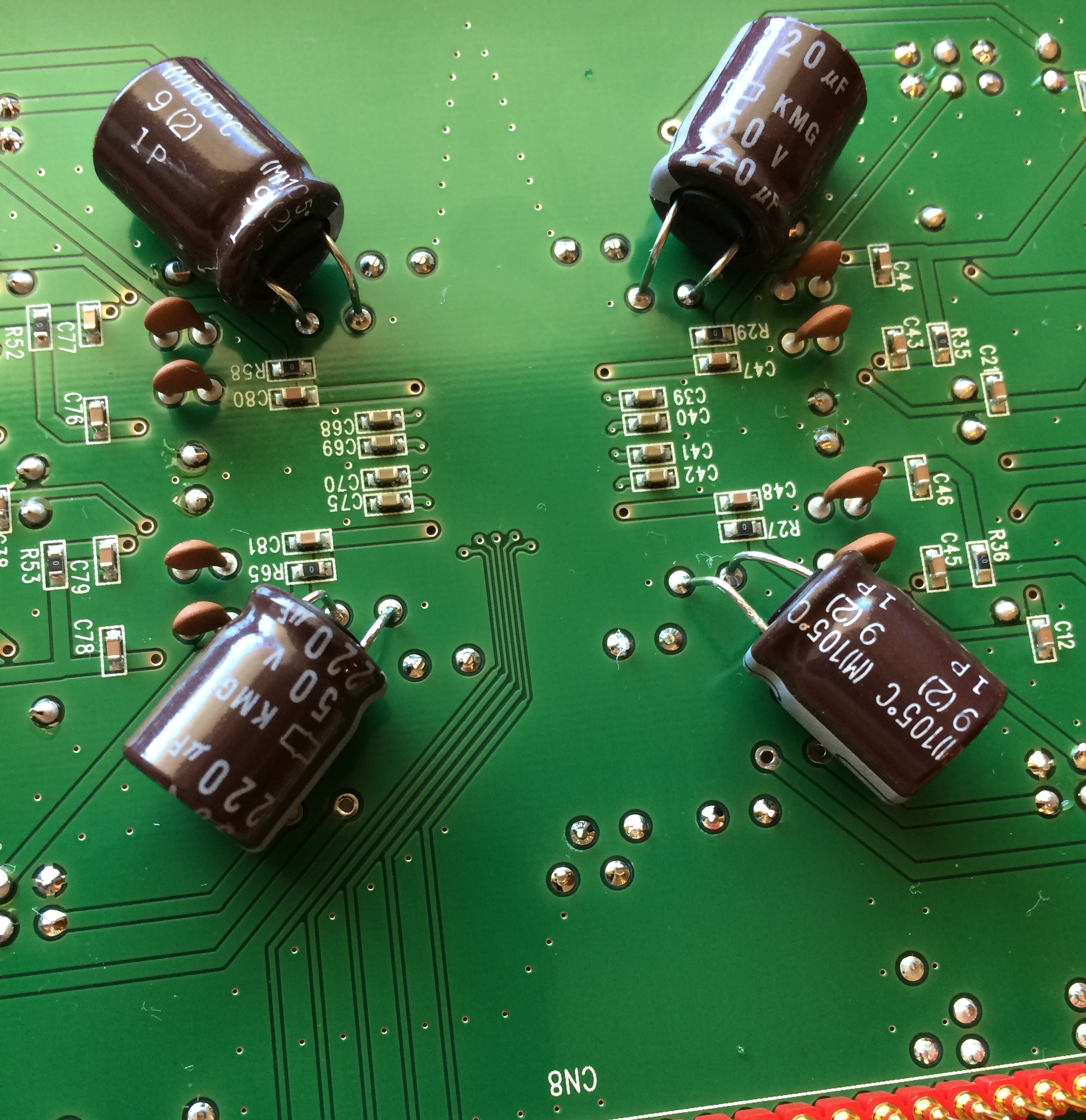

For those that have the evaluation board manual, Adobe Reader may not properly display text fonts for the dac chip daughterboard schematic. However, opening the PDF file in Google Chrome does work to display component values.
Unfortunately, the schematic in that area is still not without a few errors. Actual silkscreen labels and components installed on the underside of the daughterboard can be seen in the pics below.

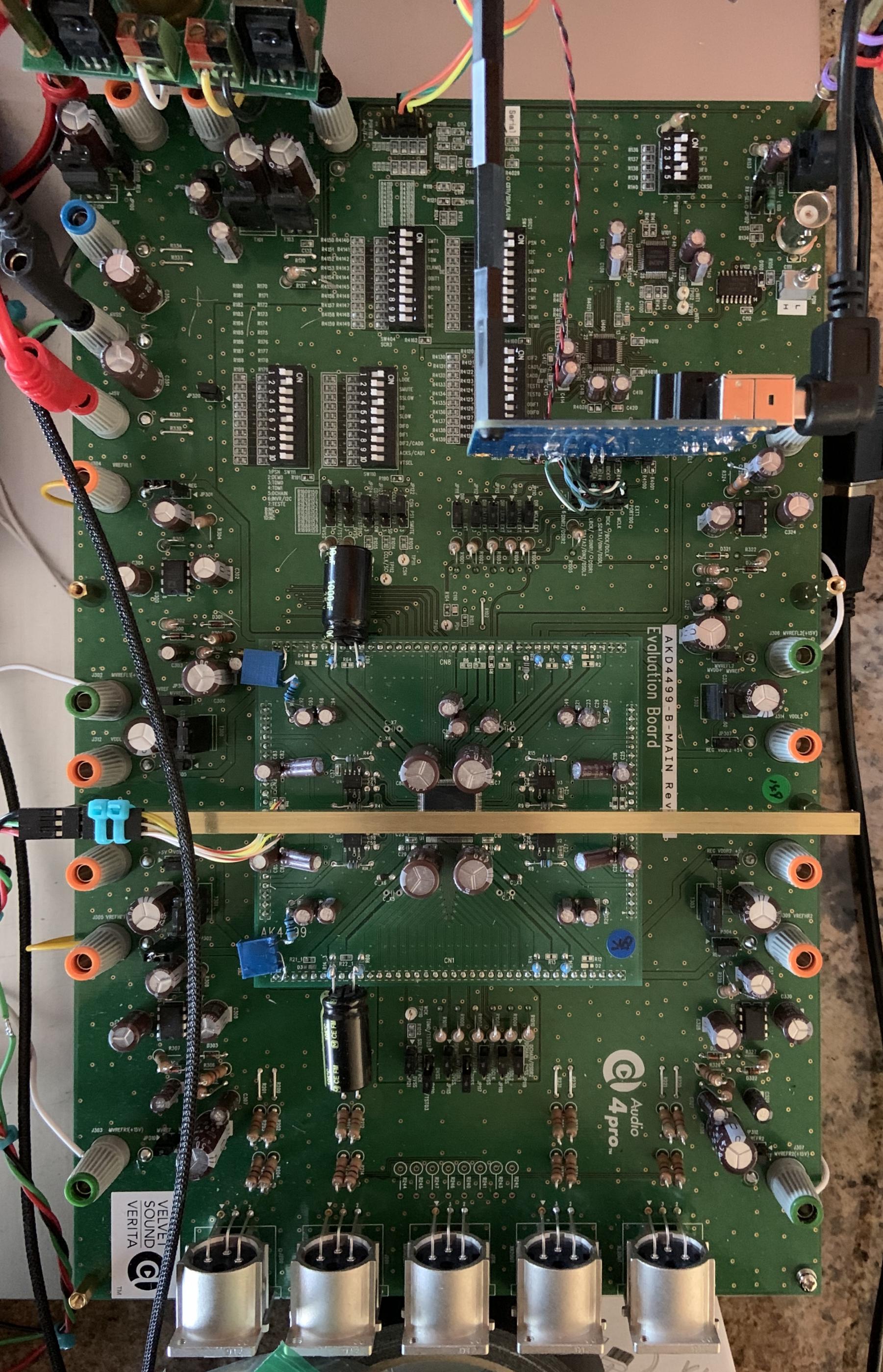

Even when there were some eval boards in stock, people balked at the price. Thing is, AK4499 can sound marvelous or it could sound mediocre. Depends on implementation of course, and of particular note it depends on how many and what kind of voltage regulators are used. The eval board has banana jacks and jumpers to experiment with the regulators that have the most effect on sound quality. To arrive at a marvelous sounding result, one should either use the eval board or make the equivalent from scratch so that it is relatively easy to experiment.
One thing the eval board design leaves out is a way to easily run the I/V opamps from a dedicated set of voltage regulators. That is probably because of the risk of damage to the dac chip if proper power sequencing is not observed (see AK4499 data sheet, page 88). However, if suitable precautions are taken it does turn out that there is some improvement in sound quality with dedicated I/V stage voltage regulators. One way of implementing a mod for that can be seen in the pic below (although the forum software has compressed the image quality a lot).
Regarding the pic of the whole board, a brief description I wrote up for someone previously:
At the left top of the pic you can see an external 5v and 3.3v power supply board for the (mostly) digital circuitry. Also, at top-center are 3 wires (colored yellow, orange, and green) that is the I2C bus connection. An Arduino not shown in the pic programs the dac registers.
In the middle of the pic offset to the right is a blue PCB which is JLSounds I2SoverUSB (better than various other USB boards I have tried, I2SoverUSB has less jitter to my ears).
Towards the lower left of the pic you can see a brass bar from left to right with some little wires coming out of the board to a 3-pin connector. That is a patch to power the I/V opamps directly for 2 of the dac channels. I left the other 2 channels closer to stock in order to compare differences in sound quality.
The trick to making this thing sound good is to power everything with dedicated voltage regulators and use the right type of regulator for each load. LDOs for the digital and RF stuff. The I/V opamps and the Reference Voltage (similar to AVCC, but +5v) need to have regulators that sound good for analog audio (which is kind of an interesting topic, but probably best left for another time).
There are also some extra electrolytic caps that can be seen soldered on at the top and bottom of the dac chip daughter board. Those reduce LF distortion (per the eval board manual, page 28), but would flatten the dynamics if it were not for a trick circuit I added to prevent the flattening. Trick is confidential, the IP belonging to Jam, so I can't say more about that. Presumably, the dynamics flattening problem is why AKM didn't add the caps themselves.
There are some added little blue trim pots and resistors on the dac daughter board which are for trimming the I/V stage output DC offset to 0v (as per AK4499 data sheet, section 10.4.1, Voff = 1.9V). Same thing some people are doing with Sabre dac I/V stages. Seems to help lower distortion a little.
With AK4499 configured as shown in the pic, it sounds clearly better than any Sabre dac I have heard, including a Benchmark DAC-3 we have here for comparison. And Jam said it may be the best dac he has ever heard, which would include some that are quite expensive >$10k.
