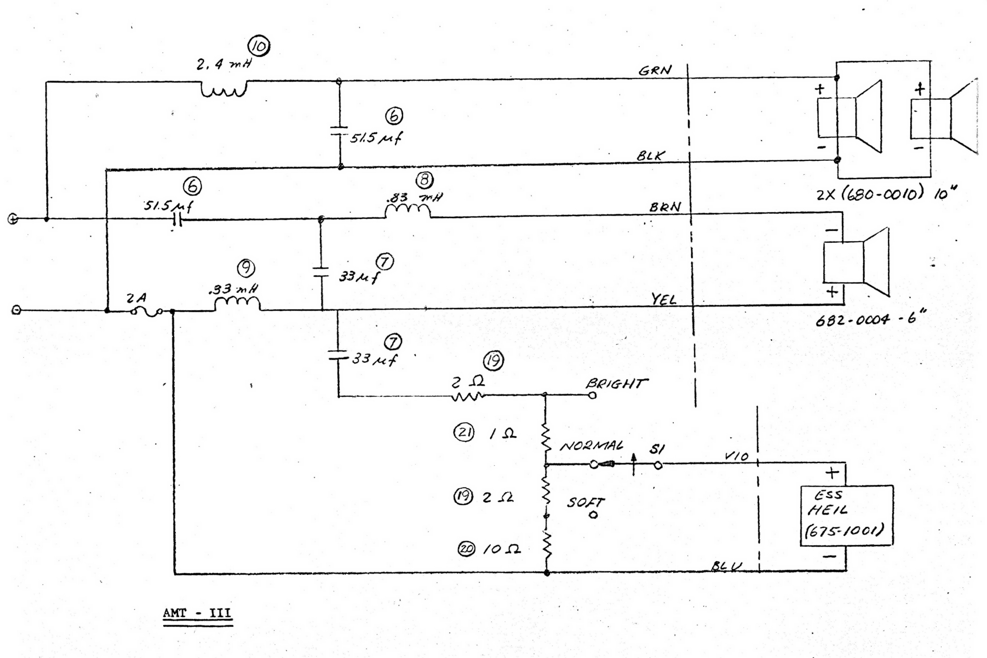

I was wondering if anybody had data about the 6.5 inch AMT3 speaker and the two 10 inchers?
I looking for this info to see what can be used to make a modern incarnation of AMT 3. I ha AMT 1 E Monitors and that configuration forces the Heil to take over at 1Khz which is no great. Better would be to cut at 1.5khz.
OCS Recommend the Emminece 1040SF for the woofers, and the Emminece Alpha 6 for the transition driver, be aware this is not a mid range in the traditional sense, its a midwoofer.
I have two pairs of these, the 1040SF is the way to go, my had the orginal transition drivers, so there was no need to upgrade, if you have the orginals, leave them, as they work excellent,
The 1040SF are efficient, and give you a db our two more output over the original woofers, and useful output down to the low 30hz,s, and will rock your house!!.
Use the 8 ohm version of the AMT3 crossover, it works well, and leave the trasition driver, as ESS had it out of phase with the woofers, it works better.
I have tons of information posted on Audiokarma on these.
I have 2 sets of AMT3's. One 4 coil pair, and one 3 coil pair. The 4 coil pair has the Peerless rubber surround transition driver (mid).
The 3 coil crossover was used in later models, and those models had 8ohm
woofers.
The 4 coil was a earlier design, and used 4 ohm woofers. Those extra resistors as far as I can tell in effect made the 4 ohm woofers 'appear' to be 8 ohms.
To me, unless you are using the stock 4 ohm woofers, is needlessly complicated, and I would suggest going with the 3 coil design, particuliarly if you are using other 8 ohm ESS woofers as replacments, or 1040SF woofers.

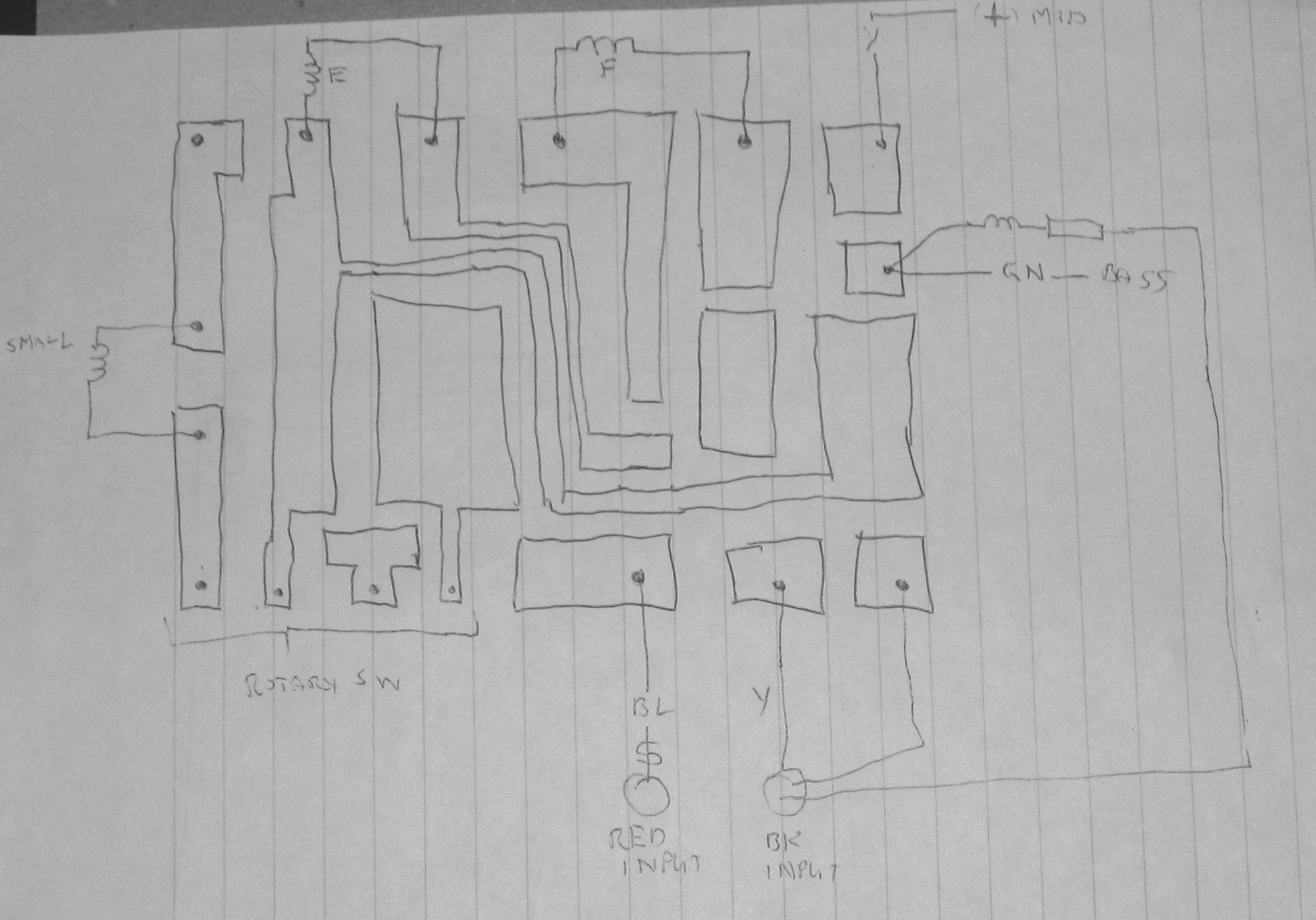

I decided to replace my 4 coil crossover with a totally new set of crossover patterend after the 3 coil design.
I also went with the 1040SF's in both pairs, as it seemed more cost effective. It preserves the over all voicing of the speaker, but gives you better low end response as well as extension.
The Dayton Classic 10" is another replacement possibility, but I would recommend saving up for the 140SF's if cost is a concern, well woth the extra$ IMHO-awesome woofer!!

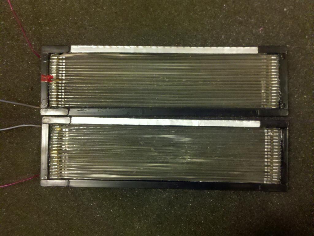

Be very wary of those new diaphragms ^ (if you'd read just this page you would have seen my recent comparison of old vs. new)
I recently found this to be the case. In point, i have been listening to my 1B pair of old heils (and we're talking original AMT units here) for some 17yrs without noticeable degradation when i decided to pull the amt's and put in new diaphragms. Something's amiss. The old diaphragms are 30something years old and they sound significantly brighter than the new ones. Threw both pairs on my dmm and they're all within .4ohms of each other but i removed the new ones again and left the old in place as they're the keeper in my mind. Who wants a pair of new diaphragms for cheap as they're for up for grabs now. They work, but the untrained ear is the new owner of these ESS bummers.
I'm losing faith now in their new stuff altogether.
Ok, but take a look on audiokarma for example and you will find other that have a complete opposite experience.
Perhaps Rick @ESS could shed some light. I think if I was buying new diaphrams I would buy them direct from ESS-then if you have a problem-you have some recourse.
Perhaps these need time to break in. I haven't had a lick of problem with my great Heils- but my old PS1220's in the 80's would ocassionaly melt a diaphram-rooms mates and clipping amps.
The Great Heils are pretty tough, keep the fuse in place and you will be listening them for years-I can't tell the difference with the fuse in or not-so I keep it in place-better safe than sorry.
How cheap? (you can PM me a price if you wish)
My original diaphrams work fine, but are in pretty rough physical shape. One even has a small hole in it. Do you think they are worth keeping?
I fried one of the original 1c diaphragms while making a new 2-way. I had no choice but to get a new, current production matched pair. The sonic measurements were virtually the same between the two but the new diaphragm material, mylar I presume sounded a bit colder, more extended and strident. After a couple weeks of break in either my hearing may have adapted or memory faded as they sounded very close to the originals albeit slightly tighter, more detailed at the cost of a bit of sweetness. Frankly, I like it this way. And they do seem to get better with age. Just my experience.

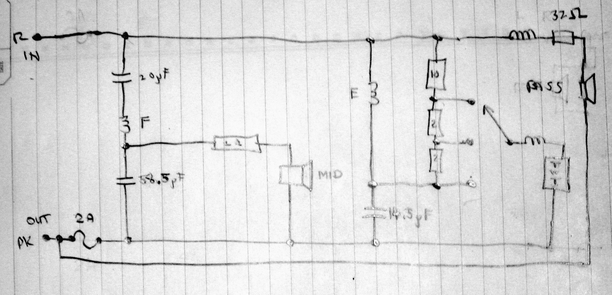

Hello, I'm using the ESS AMT 1C since ~10 Years and they sound great.
But I know about the Problems that this Speakers have with the midrange.
In Germany there are some companys like "Klangmeister" that exchange the xo with a new one without pots and set the AMT a little bit away from the front.
But they take ~700,- Euro / ~900,- USD for this modification, I think thats pretty much for some coils, foils, resistors and two new holes in the housing. ;-)
Does anybody here have succesfully built a new xo with a higher xo-point than 800Hz and could show the plans here?
