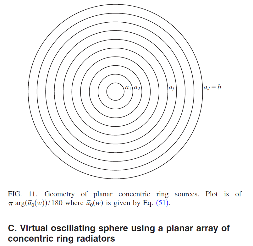

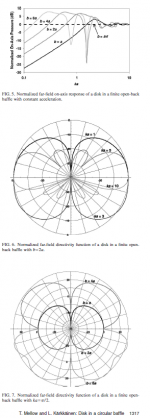

I checked two papers by Tim Mellow and Leo kärkkäinen,
their work is focused to develop a ring radiator planar speaker for mobile phones/media devices. They discuss the theory and mathematics a lot.
A bit too much for me really, I am a simple guy... I can barely understand squares and percentages! Square root is too much!

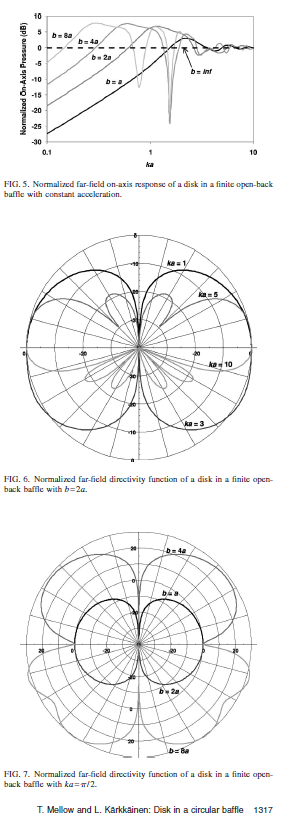

I certainly did not ask you to check the math - that's well above my head also. I just asked to look at four pictures in one linked paper. :rolleyes:
Did you see how the dip, that follows the dipole peak, gets deeper if the baffle becomes large compared to the driver? Did you see how for the "ka" value of that dip the radiation pattern blooms? :)
If that dip is noticeable, the polar pattern will "bloom" (for the length of that dip) when the driver goes from "dipole" mode to "beaming" mode. Your ear will hear this bloom better than your eyes can notice the dip. And this bloom has nothing to do with driver size. It has to do with the difference between baffle size and cone size. A larger driver will only move the bloom area to lower frequencies.

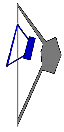

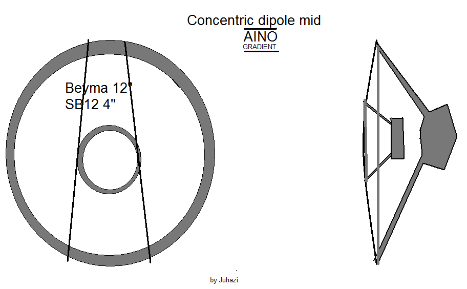

Just got a crazy idea - could this work? I mean does the back radiation of the 4" ruin the front radiation of the 12" in concentric placement? Or vice versa?
I would be concerned with the back radiation of the 4" reflected in the 12" to ruin the front radiation of the 4".
Maybe better to try to find place for the 4" between the 12" and the front ribbon? And choose your crossover points wisely to minimise vertical lobing.
/Mats
... could this work? I mean does the back radiation of the 4" ruin the front radiation of the 12" in concentric placement?
The 12" doesn't care much about the 4". But the sound from the 4" will flow around the basket edge and be reflected from the big cone. This leads to a deep quarter wavelength dip - especially since the distance from basket edge to cone is the same along the circumference of the 4". To avoid that, you should mount the 4" off axis. And you may think about tilting it WRT the 12"

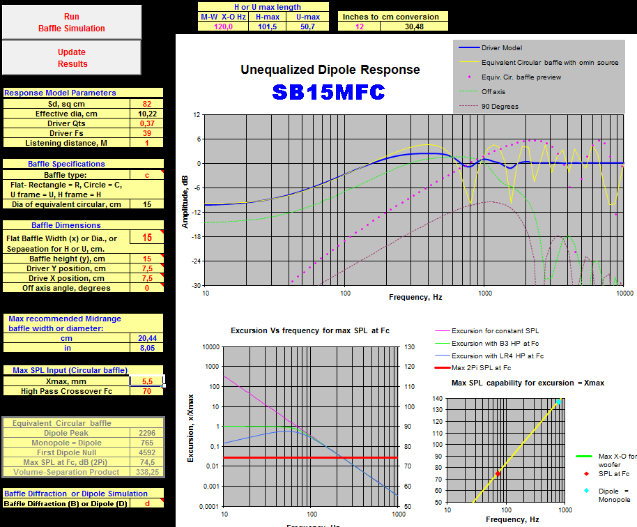

The new SB15MFC is simulated here in A,B,C,Dipole by John Kreskowsky, here is a link to his NaONote 4-way dipole
The line with red dots is the SB15 simulation with no baffle but it's own frame

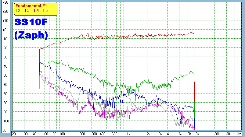

The 5"ers tend to have a quite ragged response at 3kHz, the SB is perhaps the best. Mut if JonK is happy with SS10F I must concider that too. Zaph likes it too.
The price is 87€ reasonable. The motor has neodymium but is quite wide unlike NE. The Illuminattor is way to oexpensive. The NEs seem to have not so good measured response at 2-4000Hz
Zaph about SS10F4
This is a very interesting driver, and my tests were diverse and extensive. Frequency response on the infinite baffle is first rate, nearly a flat line for a 6 octave span. That could open the door for some interesting design oportunities. Harmonic distortion is also very good and we pretty much have one of the better midranges available. Overall it's a well built and tiny midrange that should find it's way into many great 3-way designs. This is effectively a 3" driver with a radiating surface of just over 2". It's hard to understand how small this is until it's in your hand. Use with a small neo tweeter for closer spacing and a higher crossover point.
Good consistency between samples. One had a little higher Qts and lower Vas but close enough to not care. Midrange subenclosure size is generally unimportant as long as it is properly damped. Once I got the T/S parameters, I did some power handling sims and they show that this driver does not need to be treated like a dome midrange with minimal excursion. Even at 300Hz LR2 electrical filtering, calculated Xmax is not exceeded even with 256 watts. Power handling will always be a thermal issue with this midrange unless you try to treat it more like a small woofer than the midrange it is.
Be aware that the rear of the cutout MUST be chamfered or performance will be seriously compromised in several ways that effect both linear and non-linear distortion. This seems to be the case with the tests Vance Dickason presented in Voice Coil, as those results did not look very good. The driver happened to fit my baffle cutout for the Seas 22TAF tweeter, so I just took that and chamfered the back side all the way around including the terminal notches. Mark K also tested this driver, see his results also.
The max power is only 30W but sensitivity is good 90dB@2,83V

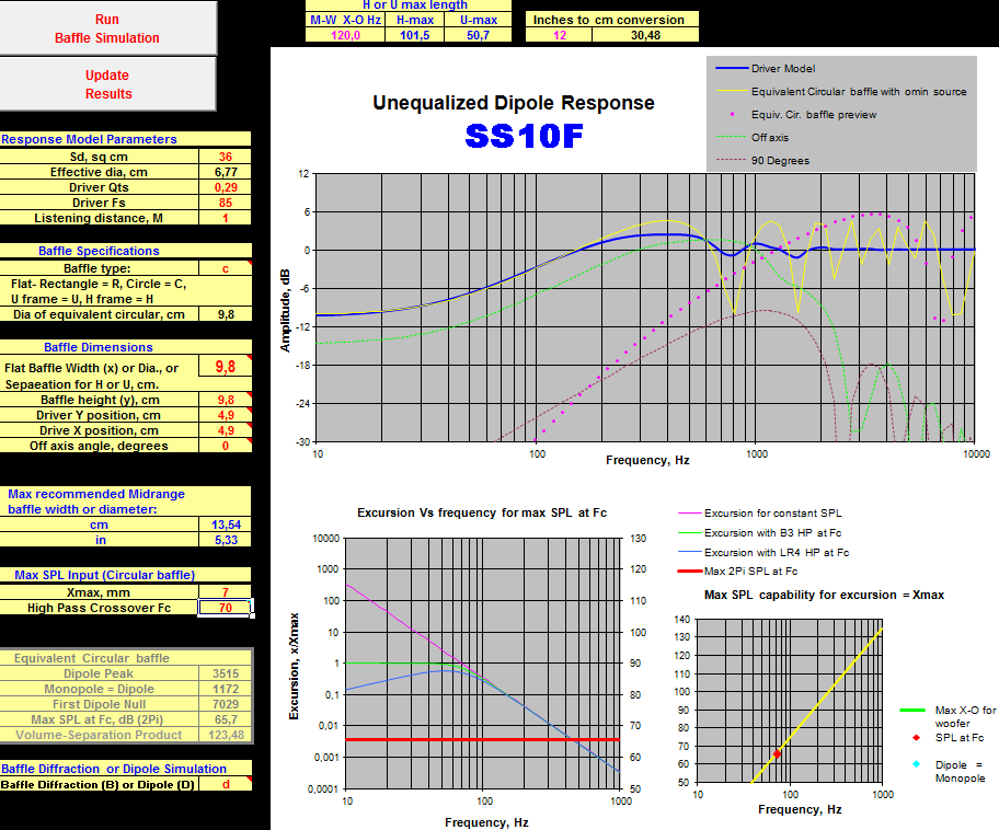

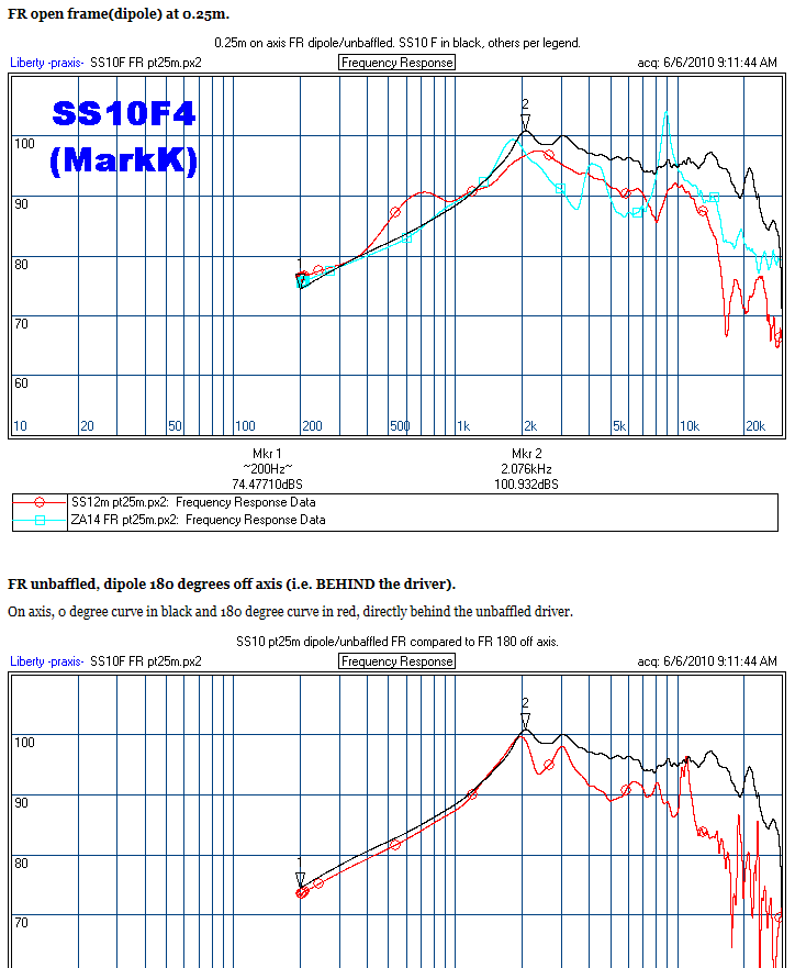

Yes, the SS10F4 has had some rave reviews and sure looks good on paper. Apparently sensitive to chamfering, so I suggest you follow John K advice on that.

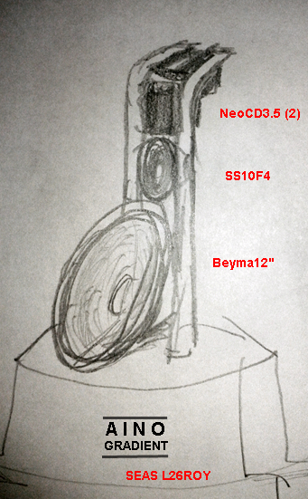

This is still an option to concider. The original Gradient had a vertical line of 4 paper-cone mid-tweeters. Filters were cascaded in LP Fq to get vertical directivity and to minimize floor bounce.
As an option to single SS10F "upper mid" could be a line array of 3-4 small Vifa tweeters working roughly 800-3500Hz. A Fountek NeoCD3.5 could be a "supertweeter" I don't know how to simulate this "system" really but we know that it works.
The horizontal dispersion of these might be too wide, keeping in mind the dispersion of the 12" lower mid?
