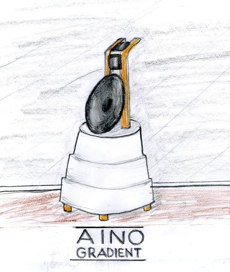

Aino gradient - a collaborative speaker project

My wife has seen my skethes and she sees the outcome of my project like these!
Ok, well I wanted to be an archicect but I had to forget it because I am such a lousy at drawing and in mathematics! My eldest son is fortunately a student at TIT Civil Engineering

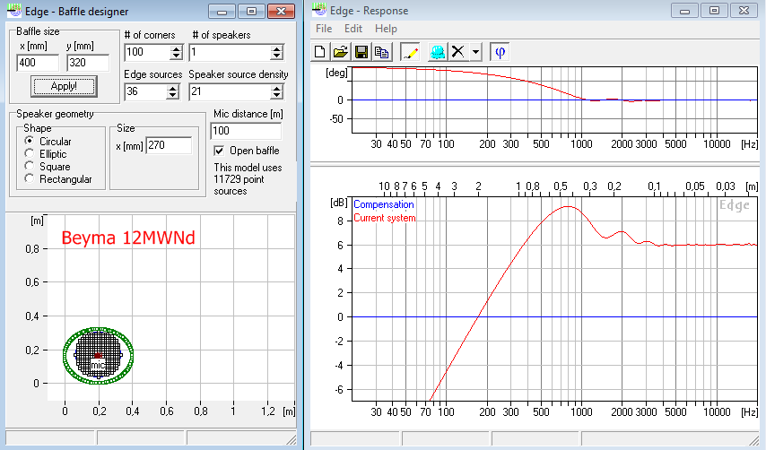

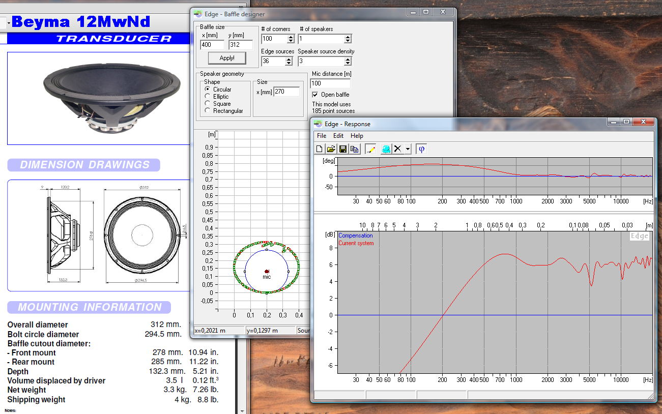

I simulated the response of my mid driver Beyma 12MwNd
Seems like it is wise to make an ellipsoid little baffle for it.
I have placed an order for miniDSP 4x10, U-MIK and a software plugin
edit was closed...
Seems like that with an ellipsoid baffle the
- 6dB is at 200Hz
- baffle diffractions start at 3500Hz

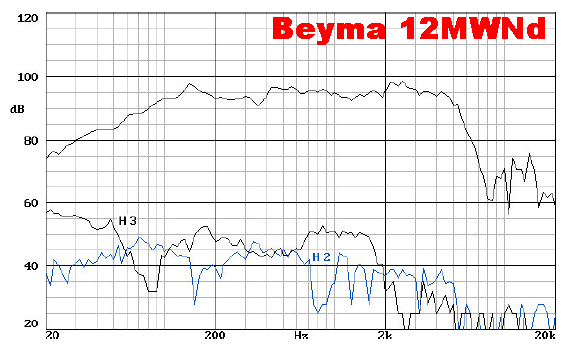

The simulation should be analyzed with the spl curve of Beyma in mind (this was measured in an infinite baffle)

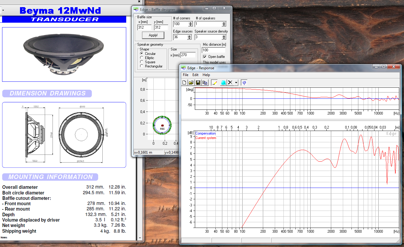

Edge is fine when you know what is important.;)
"3" for the Speaker source density is way too few. Make it "20". The cone (or dome) should be filled with small squares. With "3" you only show what the surround contributes to SPL. :p
And DON'T put any baffle around the driver!!! Leo Kärkkäinen of Nokia Research Center can tell you why. Nothing but a magnet mount. It's already too large for the Xover frequency.

Rudolf, please - don't be so mysterious!
We Finns are a naion of only 6 million people, but I don't happen to know Mr. Kärkkäinen... Tell us a bit more about this, a link maybe? Do you mean a 12" is too big for M/T xo? But I want to use the high directivity area!

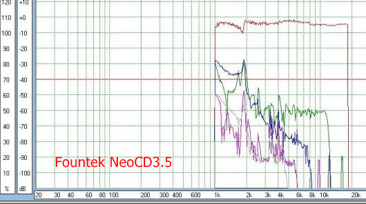

M/T xo is determined mainly by directivity of drivers in mind. The second factor is distortion, but I don't have that info about Fountek. The response is even enough to not be an issue here.
I made new plot swith 21 speaker sources. The response looks similar but cleaner. The -3dB at low end is around 230Hz with the baffle and 250Hz without - not a big difference.

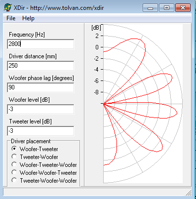

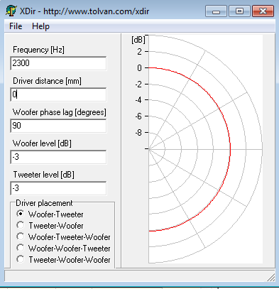

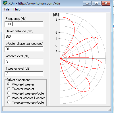

XO@2500Hz means trouble with vertical polar response and comb filtering near xo frequency
Coaxial arrangement has no lobing issues around xo. The Neo3.5 is too big to be positioned coaxial with Beyma 12" (acts as a diffusor)
miniDSP gives a possibility to do a 48dB/oct xo (LR8) - is this the least bad solution here?

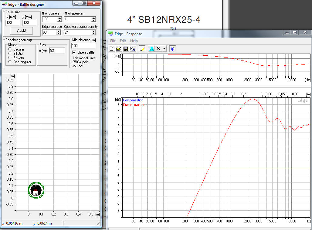

I guess this means that I need a 4-way system for transitioning from the 12" to tweeter's monopole area. Sounds like NaO Note and LX521...

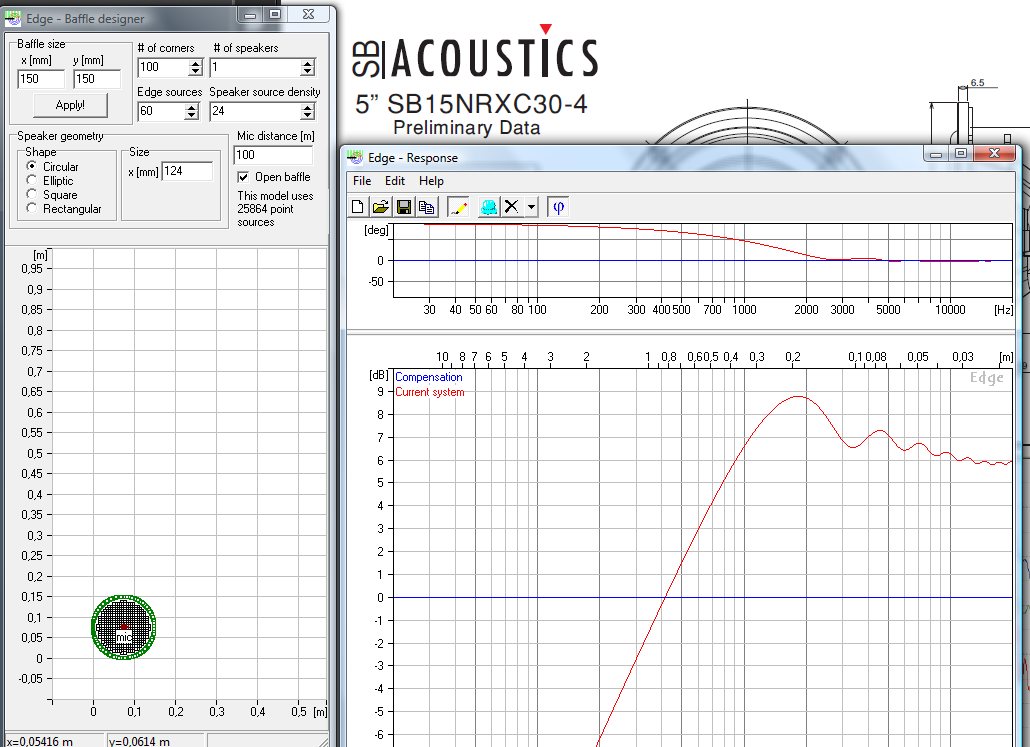

Those guys use a 10cm (4") upper mid drivers. But because my lower mid is a bigger one, perhaps a 5" for me -the directivity would suit better.
SEAS CA15RLY
Peerless HDS135 a special offer this week!
SB 15MFC
