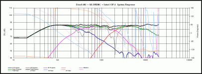

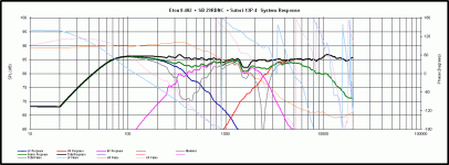

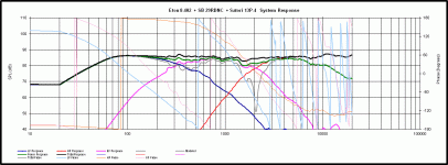

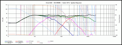

I ran some more baffle diffraction sims and did a couple of drawings and my preliminary results suggest 2 options:
1. 7x16x40 so the same as before but with the tweeter center at 37" with .75" chamfers. This means the top box can be shorter and the bottom box larger.
or
2. 8x16x40 with the tweeter at 37" again but with 1" chamfers. I think it looks better keeping the bottom narrower, but that's up to you of course. Both arrangements still leaves lots of room for the chamfers and drivers.
I still need to look at how the new diffraction patterns will work with the drivers and xo's I've come up with so far but I think they'll be ok.
Preferences?
Btw, what do you think of a top box that has a sloping backside, like the Philharmonic or the Tarkus, but sloping it down to the full depth of your bottom box. There are some added interior sonic benefits as well.
Give me a day or 2 and I should have some more specific details.

A few things stand out for me now that I've played around with the xo and the drawings:
1. My preference is for the 8" top with a 16" bottom, so 8"x16"x40". I think 18" on the bottom with an 8" woofer instead of a 10" looks too bottom heavy.
2. With an 8"x16"x40" cabinet, the diffraction works out just about the same as before with the tweeter at 27" from the bottom, the mid 32.5" and the woofer somewhere around 10". The edge chamfer needs to be 1". If you wanted to do a separate top cabinet, it'll work with 12" of height.
3. I've simplified the xo and got it looking pretty good but the one problem is still the woofer/mid phase alignment. Moving the woofer forward helps to minimize this. So, there are 2 ways to do it - move the woofer baffle forward about 1.5" and try and make the transition as smooth as possible or tilt the baffle upwards by bringing the bottom forward.

artofwar, a 1.75" chamfer will work fine. So that's about 1.25" off each side of the corners.
I just went back and re-read your 1st post and see that external xo's were in the cards to start off with, so that should give you enough box volume I would think to keep your dimensions at 8x16x40 with bottom depth also at 16".
Below are the FR and impedance charts I've got so far. These are with 3dB of bsc which I think is a good starting point for you unless you tell me that the speakers are flush up against an entertainment center or built-in shelving or some such. Then we'll want less.
The FR chart has a lot of info in it. I've designed for a medium/large room with a slight downward tilt to the response with xo points at about 400Hz and 2400Hz. The power response (green) has a few dips in it: the sloping HF is normal as the off-axis response diminishes as we get higher in frequency; the dip in the 1500-3000Hz range is also something that people sometimes prefer as it's a sensitive spot in our hearing; the dip centered around 450Hz may be noticeable in which case we might try raising the on-axis response just a touch around the lower xo point to compensate. It's expected that you'll be listening on-axis.
Phase alignment is good with a deep and narrow reverse null at the upper xo and a shallower but wider null at the lower one. This is achieved with asymmetric acoustic xo slopes (3rd and 4th orders for each one) and the tilted woofer baffle.
Impedance stays above 6ohm except where it dips down to about 4ohm between about 1300Hz and 6000Hz. So nominally, a 6ohm speaker.
The dip in the Satori13P-4 FR at about 1600Hz is plainly evident but not exaggerated. I'm thinking it will be similar to its big brother and not really be noticeable.
Tweeter ht = 37"
Mid ht = 32.5"
Woofer ht = 10.75" (plus or minus)
