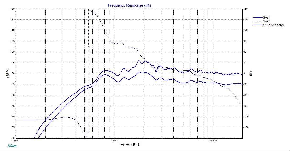

Here is a typical tweeter, the XT25BG (as measured by yours truly), with and without a 2.7 Ohm Resistor. As you can see, at 10-20kHz this is about a 5 dB pad, but down at 1 kHz only a 3 dB pad, so the resistor introduces a new, 2 dB downwards slope relative to the original tweeter response:

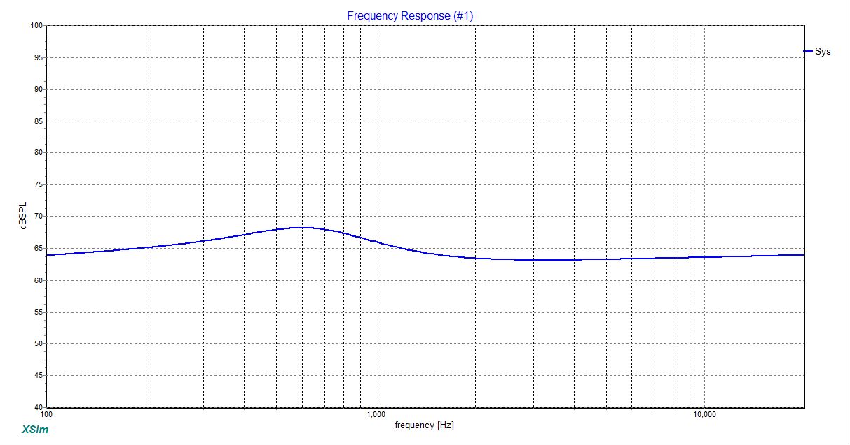

Here is an easier to see view. This uses the same impedance file, but we assume a speaker with ideal bandwidth and flat 70 dB sensitivity. I have also increased the series resistor to 4 Ohms.
At the top octaves, this behaves like a 6 dB pad, but at the impedance peak, it is only about a 1-2 dB pad:
Is this a HUGE deal if you are hacking around a pair of cheap speakers? Meh, probably not, but if I am making them for myself I would take this into account, or let XSim do it for me. 🙂
I should also point out this effect is entirely in the electrical domain. So if you wanted to use Room EQ Wizard to measure the driver impedance, that's all you need. Grab it, and stick it into XSim to see what your risks are.
