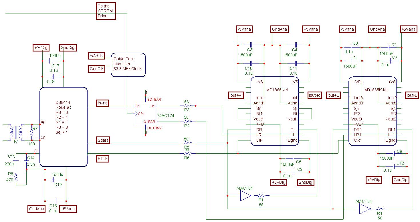

Hi
I have started my new dac yesterday in the evening, and it works!!!!
The DAc is composed of :
PSU : +5 digital, +/-5 analog, +5 clock, +5 glue logic (74act74, 74act04)
A spdif transformer, made with a IBM 93 Ohms coax/110 Ohms twisted pair balun transformer.
1 cs8414 (with the filter cell = 3.3nf // with 470ohms-220nf).
A reclock stage : it reclocks the latch signal for the ad1865 with a guido tent low jitter oscillator.
2 ad8565 : it means 2 dacs/chanel : one for data, one for data inverted. Then balanced output for each chanel.
It works as I said at the beginning since yesterday.(just on resistors at the I output of the dacs).
I have to build the balanced U/I. I plan to build the Nelson DI U/I stage.
The drive is a ASUS CD-S520 (ASUS 52X CD-ROM). I take the Spdif signal, and I send the 33.8 MHz clock from the dac to the drive (from which I have extracted the poor ceramic oscillator).
Then all the components are synchronous and the spdif and drive jitter doesn't matter.
The fsync signal from the 8414 can shift + or - 7 ns, the reclocked Latch signal will allways be at time.
I'll prepare shematics for all of you
(I am waiting for your comments an critics)
Philippe

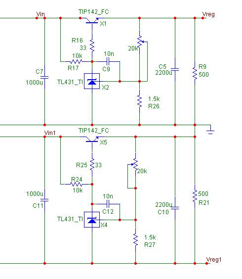

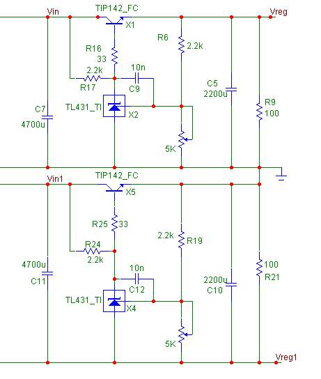

Some photos :
Psu :
Guido clock, glue logic and old CD "oscillator"

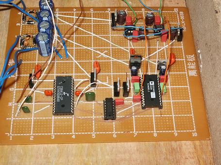

Hi all
I have completed an AD1865 NOS DAC. Picture below. This looks ugly compared to the DAC done by Xiaolong, for sure due to point to point wiring.
Brief on the design:
Generally based on the schematic on ptsoundlab
Separate power supplies for digital and analog sections. Power transformers are also separate. Regulators are 78xx and 79xx, one for each power pin.
I/V stage: one opa627 on each channel using the AD1865 built-in feedback resistors (not the built-in opamp). No filtering at all.
Bypass caps: WIMA MKS 0.1uF for AD1865. WIMA MKS 1uF for opa627. One more 0.33uF orange drop cap on top of opa627 (add in later, not in the picture).
Output coupling cap: 3x0.47uF Philips MKP X2 (add in later, not in the picture). These are not very good, I suspect. I have also tried Solen, Sprague PIO and dit not like the sound.
The DAC sounds very detail but not as musical as I expected.
I have also tried to parallel the bypass caps with 4.7uF ELNA Duorex II cap. This made the bass very heavy and slow down so I removed them.
Anyone have recommendation to improve it? Thanks in advance.
