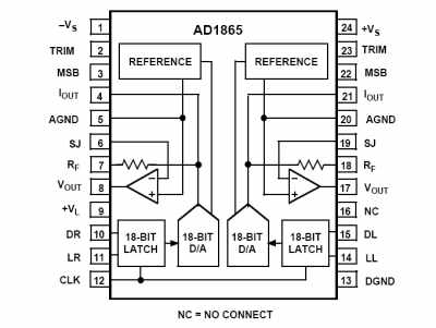

Hi
I have another question about the ad1865 :
on the analog outputs of this DAC, we have the pins :
Iout : this one, I know what to do
SJ : negative input of the internal aop
RF : Internal feedback resistor
Vout : internal aop output
As I will make a U/I converter (Pass D1), what do I do with those pins ?
I think to wire SJ to the analog ground, but for the other ones ?
Must I load the aop output ?
Philippe

Opamp out of service
Hi Phippe, Put the opamp on the AD1865 chip out of service. Now Bricolo must have an idea how to do that.philbyx said:Thanks Bricolo,
