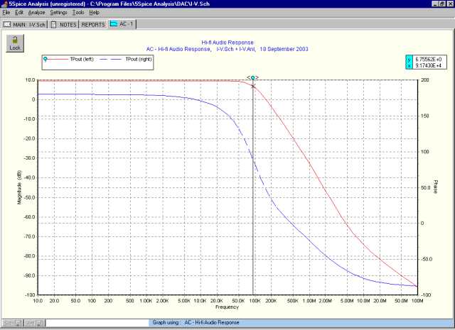

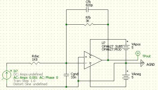

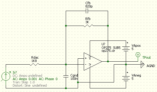

A possible solution relating to my previous quesions on this thread....
'The use of a capacitor across I-V conversion op-amp input to shunt noise directly to ground and produce a 2nd order response'
I have been busy this week, but I spent some time studying the maths relating to my problem. Eventually, however, I thought of solving the problem empirically using spice simulation. I used WinSpice shareware and downloaded spice models of real op-amps from various manufacturers. The individual behaviour of the op-amp is critical to the choice of component values. In the attached picture I have chosen an OP275 for example purposes only- I will possible use AD8610. The 1.8K resistor is the Thevenin equivalent of the output impedance of my AD1865 DAC.
There's more....
Here is the resulting response curve (See attached picture)
What does everyone think of this method?
I am striving for a transient perfect response. What does this look like on such a graph?
(I think... the phase characteristic around the -3dB cutoff frequency will have perfect symmetry like in my example - True or false?)
Check out the reponse curve..
The -3dB cutoff is rather high, but I wish to reduce phase shift at 20kHz.
Note how the phase response looks flatter and overall more linear. This linearity, however is not centred at the -3dB frequency. In addition, phase shift at the -3dB frequency is not 90 degrees.
Which of my plots represents a better transient response?
