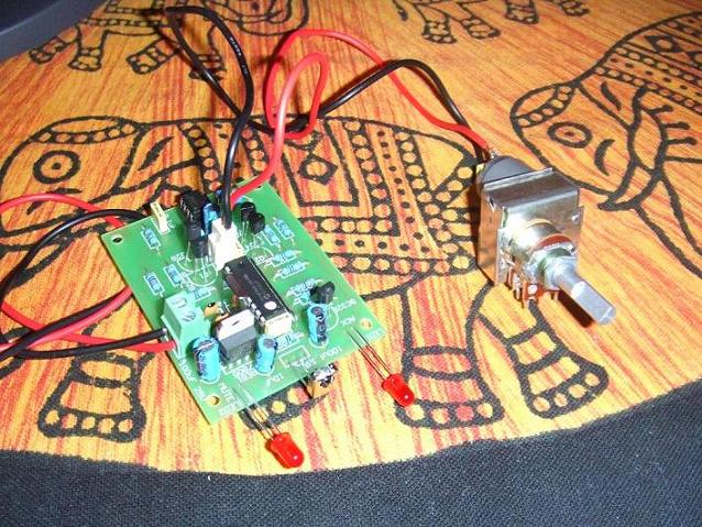

I received the remote volume control from altronics in Australia yesterday evening and have put it together.
Amusingly this PCB is probably the most complicated one I have to build for the whole project! Anyway, it's a good kit and I can definitely recommend it. It was £28 delivered to my door (very quickly) and works fantastically well. I soldered it, programmed my harmony for a philips TV, connected up a 9V battery to test - it worked first try and does exactly what it says on the tin.
Pic attached.

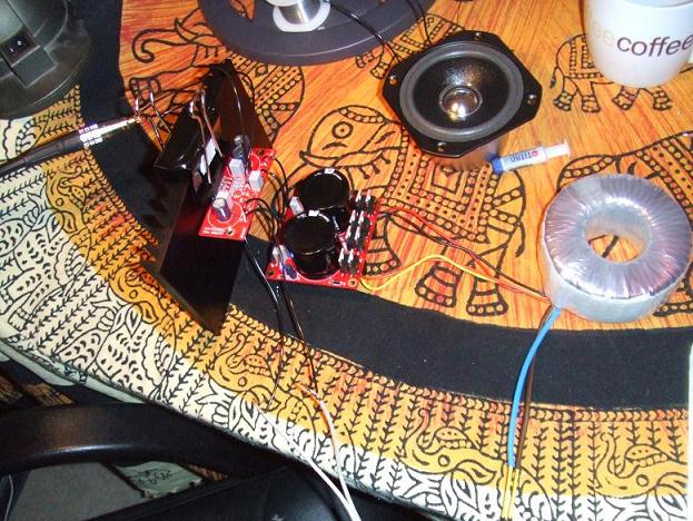

The LM3886 amps and PSUs are built and working fine. Here is a pic of one being tested playing a few things through my MA GR10s. Sounds fantastic though sounstage is severely hindered by mono operation
The heatsinks have turned out to be overkill and barely get warm, but I suppose that's no bad thing. They were only a few pounds each anyway

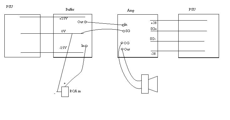

Finally, can anyone offer me advice on a better grounding... I have included a pic below of how I have things wired up at the moment which works, but as I said I definitely want to quieten it down a bit. Is it likely that the noise will be reduced when I solder things together, at the moment many of the connections are simply twisted wires helt by croc clips.

Well, after battling what I thought was noise caused by a grounding issue, it turned out to be caused by my soldering iron which was switched on on my desk. That noise is now gone (I switched it off) and I attach below for the interest of anyone else the grounding scheme I have settled on which seems to work well and the amps are now very quiet with barely any noise audible.
Also just another thanks to those who posted trying to help with that issue!
Edit: It's probably worth pointing out that in the diagram the point marked "CHG" isnt really a chasis ground since my chassis is wood, I just used the "CHG" hole on BrianGTs PCB as point of connection to the amps ground plane (which in this Dual mono setup I am effectively using as the main star ground).
