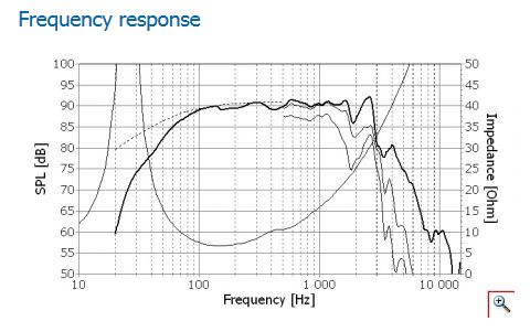

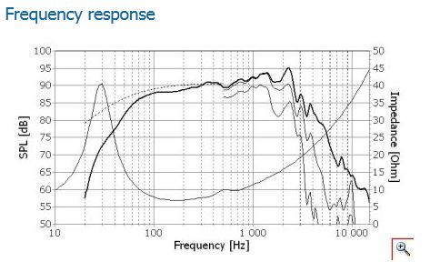

Resistance and Inductance is built into the speaker and optimised for different applications. In the below 10" midbass examples, SEAS let you add inductance externally (which opens up more options for filtering) or run it crossoverless to be flat. You choose. I could work with either.
