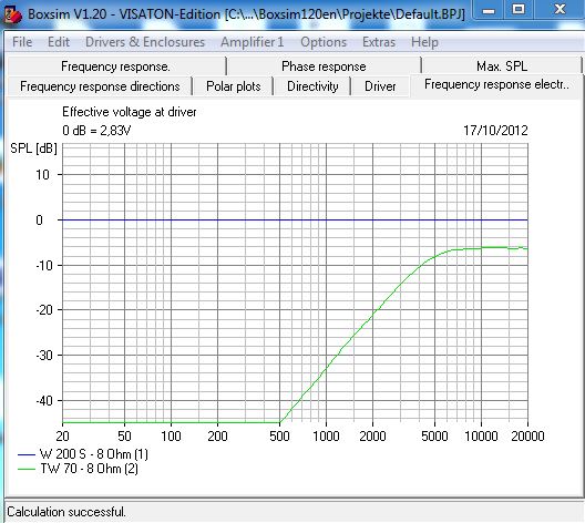

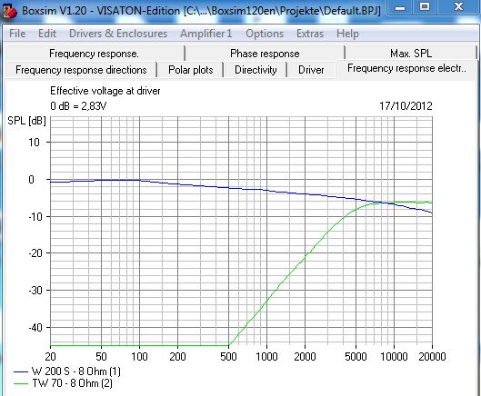

Then please explain the much tighter and more detailed bass I got when I replaced the passive xover on my speakers with an active one. Same room, same placement, same box, same amp.
Admittedly the active xover has 24dB L-R slopes as opposed to the 12dB original but most of the audible difference is well below the unchanged 1.2k xover point.
I think you've answered your own question there. :D
You're comparing a second order butterworth closed box response with a 4th order (overdamped?) reflex type response. I think I could hear the difference. It's not a valid comparison.
It's interesting to see what the simple 1.2mH bass coil does with that Visaton W200S 8" driver I looked at earlier. It slopes the driver response for a standmounter to be approximately flat in the 500-5000Hz region with a 6dB rolloff. The very deepest bass response is largely unaffected. It's worth mentioning that some drivers like the polycone Vifa P13Wh are approximately flat in the right cabinet and room placement without a bass coil at all. A question of loudspeaker voice coil inductance.
To avoid it getting lost due to the merger I'll have to ask again:
Where do you get the closed box response from?
It was still the same ported box in exactly the same position within the same room.
Are you saying that a 2nd order (overdamped according to Tannoy) crossover at 1.2kHz changes the bass response at 50Hz in a ported box to the bass response in a closed box when compared to a 4th order L-R at 1.2k?
