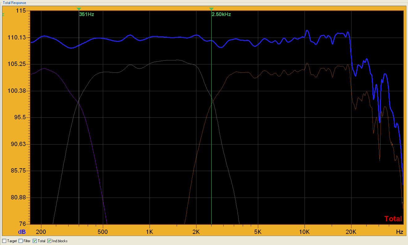

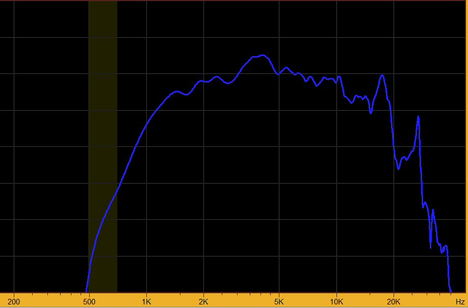

Hi Robert. Excellent project!

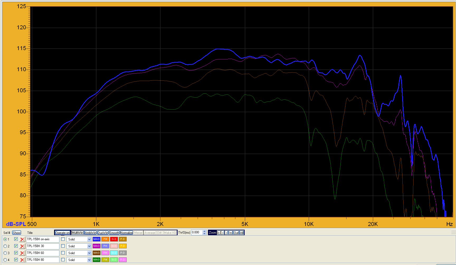

Comparing the manufacturer's spec to your own measurement of this driver, there seems to be a discrepancy up above 10kHz: their plot is flat, while yours has a dip. I find that equalising such deviations can introduce problems, rather than solve them. DSP tools are very powerful, but one can over-compensate or, rather, mis-compensate.
My suggestion: do some off-axis measurements and see whether that dip also exists off axis. Alternatively, try smoothing your measurement to 1/3 octave before applying equalisation.
I find that exercising constraint when equalising the tweeter yields good results, usually.
Hi Shaun,
Have a look at the attached - Why do you think it's good enough to overlook peaks just because the manufacturer only measure to 20kHz and smooth the "rest". Normally I would say that you have to look to the "break ups" (= heavy distortion) in the upper range of a driver - will normally give some problems further down in the frequency range if not dealt with.
Do any of you diyAudio members have any measurements of the TPL-150H? Also about 20kHz !
I actually sit on-axis and in the setup the peaks are minimized with a few PEQ to avoid any disturbances. I have to say that the sound isn't at all bad - and I will probably be able to tweak / fine tune the sound 20-30% more improvement.

That response curve you posted is similar (but not exactly the same) as to
the Stage Accompany SA 8535. The two drivers resemble each other. I said to myself if I ever lost the SA's, I'd consider the Beyma.
What I did (to tame that very mild peak) was use an in-line single high quality cap, but of course to still use an active crossover. Of course as low as the OP is crossing, a notch should be in better order than a rolloff cap. Then again, that slight variable in response in the over all system may not be bothersome at all.
I have noticed a few comments about the frequency response plot on the TPL150H datasheet being optimistically flat. IMO, it looks flat because of the scale of the sensitivity axis being from 20dB to 120dB. If the axis was from 80dB to 120dB, I think the curve would be as jagged as the ones posted in this thread.
in my room with no correction it was +/- 2.5db.

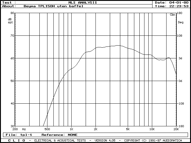

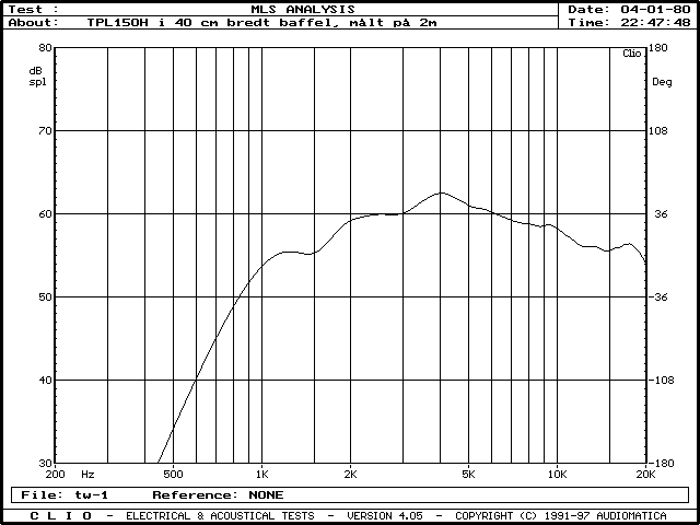

Here's mine. It's just the driver/horn with no baffle.
It will extend further down when mounted on a fairly wide speaker baffle. I have crossed it over at 900 Hz in one design I did with two 15" mid/woofers.

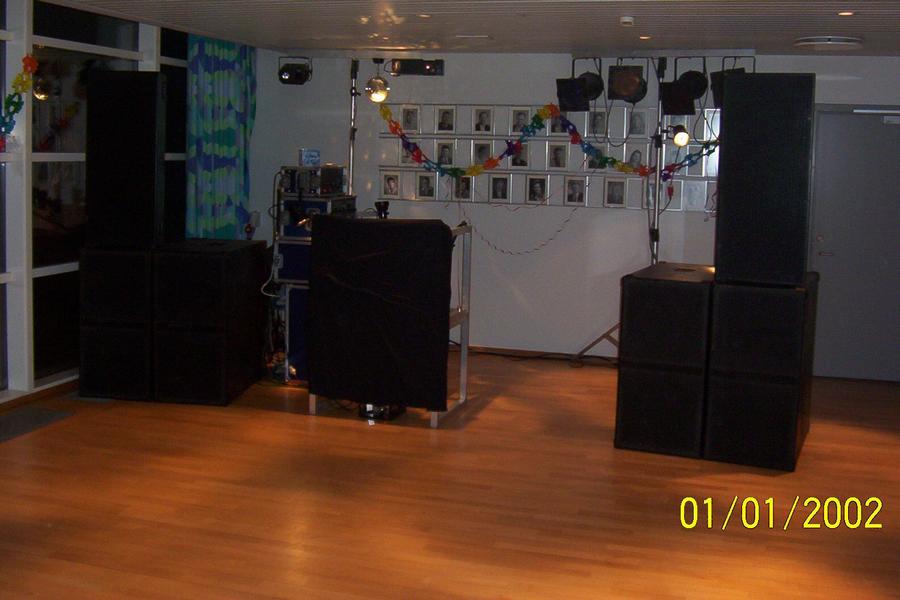

The ambition was to build a system that could satisfy my desire to play very loud once in a while and maintain sound quality now that I didn’t have my PA disco system anymore as I stopped doing gigs and the system was sold.

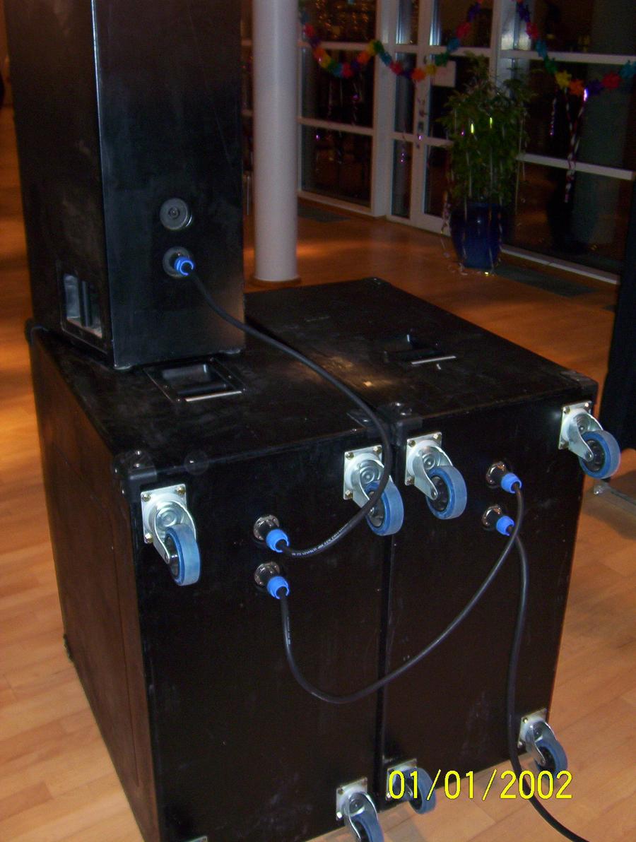

The latest PA system featured my own constructed speaker boxes like the previous systems - two types of top 1.4”+15” and 1.4”+dual 15” and my “small” reflex sub bass horns (6 pcs) see attached pictures. Especially a lot of energy had been focused on development of sub bass horns over the years. See attached pictures.
The latest system was built in 2000 and it was gradually reduced to “only” one small top + sub each side and the last bits were sold in 2008. I have always loved the sound / attach of a horn loaded bass and combined with a port it also had the body that I think is required to reproduce the music truthfully. Over the years I have compared my sub bass horns with many different incarnations of ported bas boxes – I literally hated the performance of the ported counterparts (also the few ones I tried building myself).

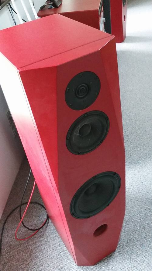

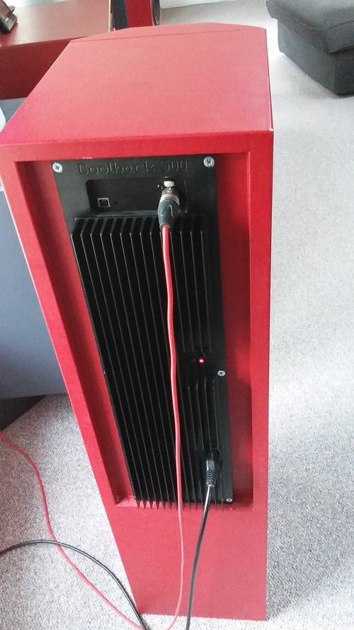

Well - a new system is on the steps so for the time being I have a modified version of the Faktum loudspeaker kit - 4ohms bass driver all Scan Speak. It's of course active powered by a set of Coolback 500 and DCN28 as digital pre-amplifier. See attached pictures.
The new loudspeaker system will consist of 4 closed 100 litres subs with 15" Dayton and the good thing these are already built :D
One of these days I will assembled the main speaker enclosures - all pieces of the "puzzle" are ready except the 4-channel amplifiers that will be sitting in the back just like the current Faktum speakers. The difference is that there will be no digital filter in the speakers and much more power 2 x HPA2K modules and 2 x PA3CC modules. DCN28 will preform the filtering in the new system.
