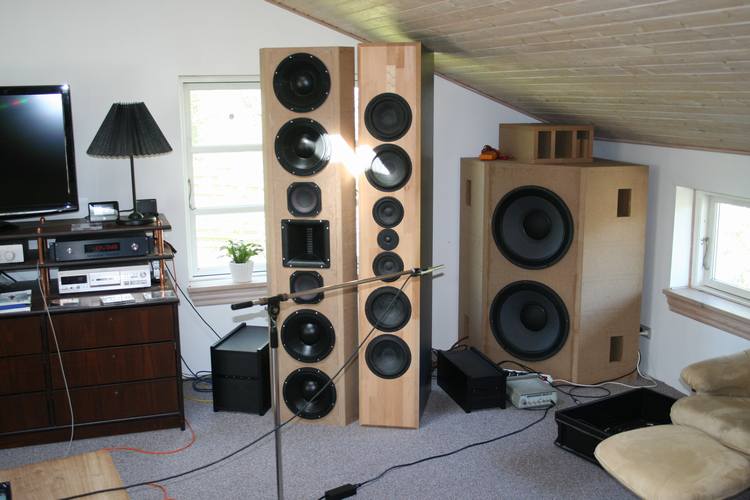

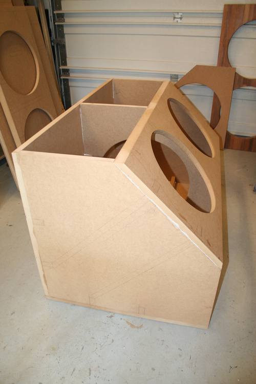

They turned out great. Surprised this doesn't get more responses.
Must be nothing to criticise .

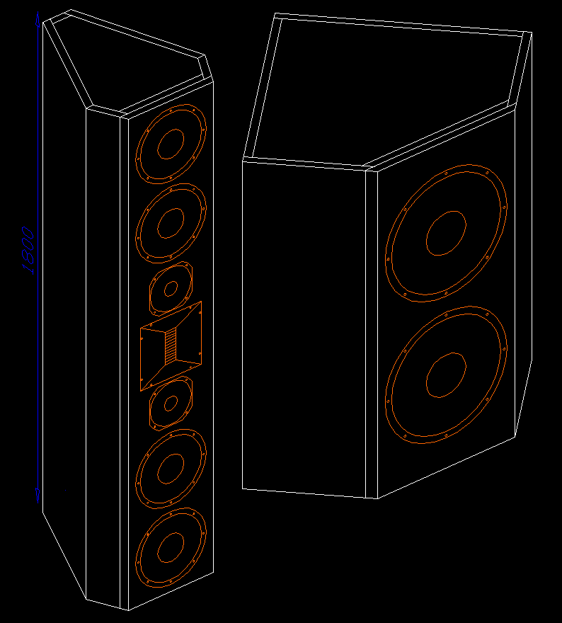

Thanks - I am please with the result and the "small boxes" makes the system acceptable even tough there are 6 of them

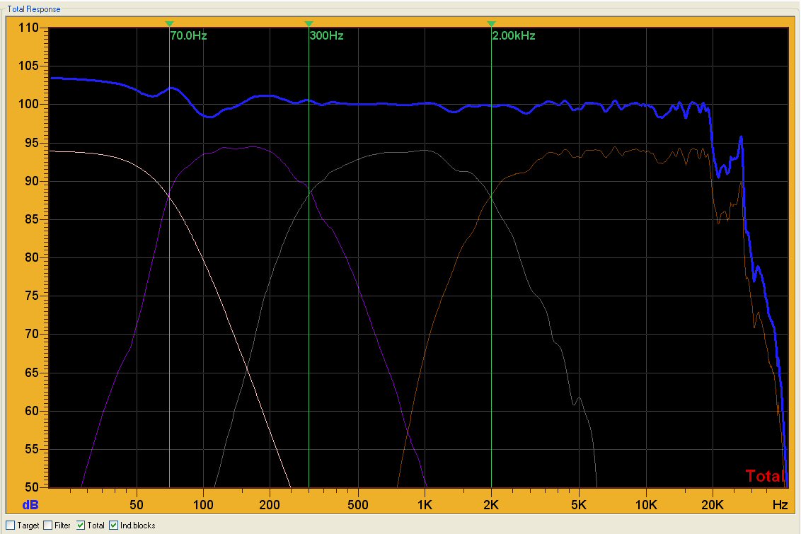

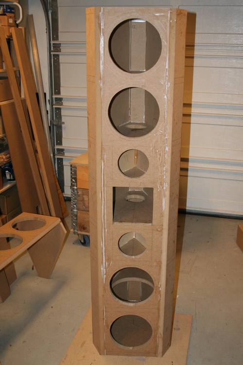

So how do they sound? What are your crossover points? Did they meet your expectations? Thanks.
Goose bumps and entertaining as one of my friends said and I agree

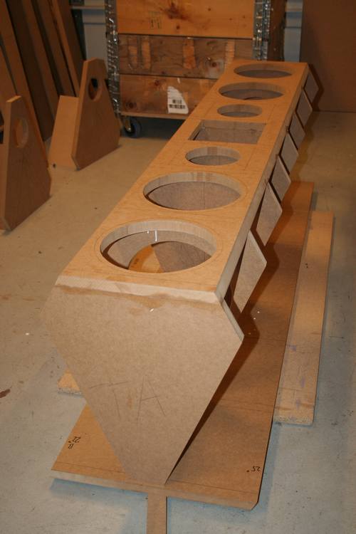

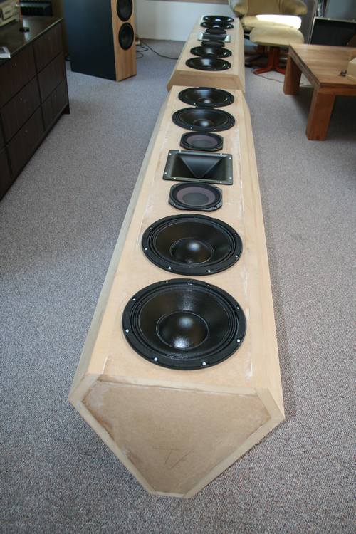

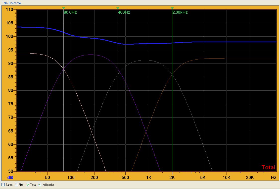

XO points are 80Hz, 500Hz and 3kHz

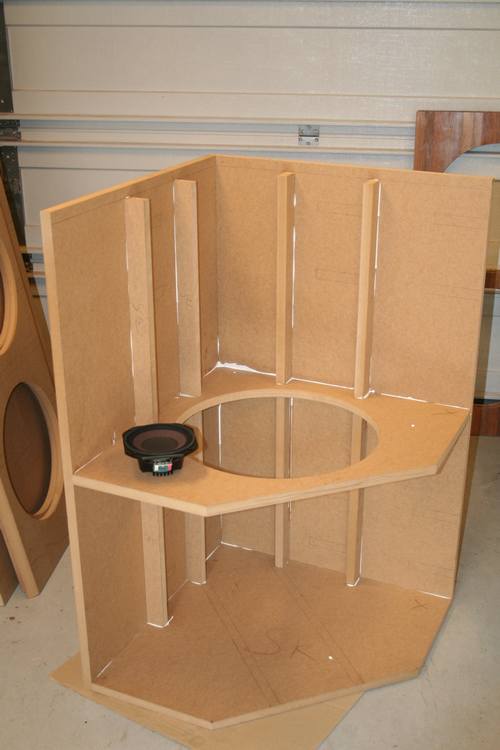

The system is actually better than I expected as I had feared that using the Accuton drivers could give problems that I have experienced in many other loudspeakers using these ceramic tweeter and mid drivers. They really outperform anything that I have had this far. Nothing "sticking out" - very clean...
And the Oberton 8" drivers nice precision (good choice)....

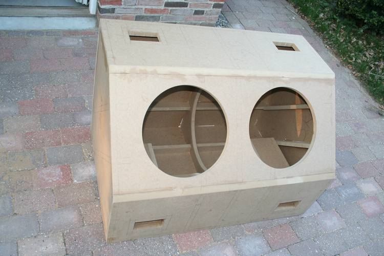

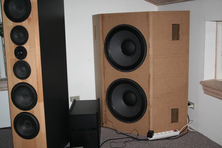

And the 4 x 15" closed Dayton subs.... very nice indeed = control at every bass node.
The amp blocks are only temporary as I will build a "Coolback" with the exact same amp modules into red enclosures. I use in each side 2 x PA3CC at +/-63V rail (tw+mid) and 2 x HPA2K at +/-63 and +/-125V rails (bass+subs)
Do the maths ~ 200W (8ohms) + 200W (8ohms) + 1200W (4ohms) + 2kW+ (2ohms)
