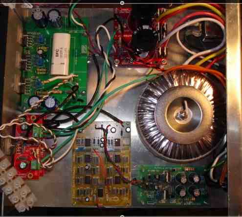

Bad Photo
Layout might be a problem also?

There are some good threads on grounding, here, that you might want to search for. Look for "star ground".
Ideally, all grounds should be kept separate from each other, until they all meet at a single "star" ground point.
Sometimes the star ground point is then connected to the actual chassis/earth/safety ground, often with a "safety disconnect" network, which usually consists of a couple of hefty diodes in anti-parallel, with a parallel reistor or 10 Ohms or so, and a parallel capacitor or 0.1 uF or so.

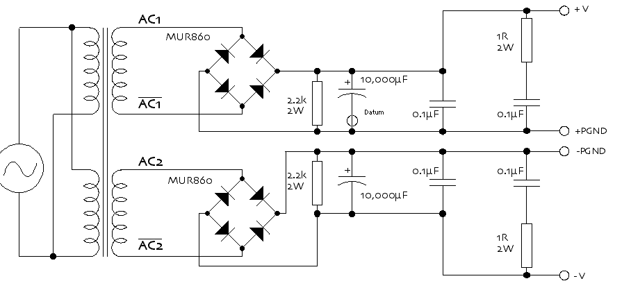

clarification
The power supply has + and - earths as in picture. The chipamp boards have connections for these and then a connection to tie back to chassis ground. The power supply for the crossover and the PA150 board only have a single earth connection. Sorry for my bad explanation.

MJL21193 said:
Ok, now I kind of understand. I just don't see the value in seperating the ground like that.
Oh well, just a new stick for the dog to fetch.
I don't see why, in Tex's case, not running the separate grounds caused the massive oscillation. And right now I don't have time to analyze it thoroughly (or at all).
But, "in general", as you probably already know, having ground-return currents sharing conductors can be "a bad thing". That is one basic reason for using a "star" grounding scheme, and keeping all grounds separate.
Every conductor is just another non-ideal component. Any current in any conductor will induce a "distributed" voltage, all along that conductor, because of the conductor's parasitic resistance and inductance (and sometimes capacitance), just like when current flows through a regular component. (There are calculators and tables on the web that will give you the values of the parasitics, for specific PCB traces and wires.)
In the case of a ground-return current, we can assume that the total induced voltage appears back at the NON-ground end of the ground-return conductor. That means that the "ground" for that device or circuit will not be at zero volts (i.e. not equal to whatever the voltage is, at the "ground" end of the conductor).
And if the ground-return current is dynamic (i.e. changing), then the "ground" point from which it came will have a voltage that is changing. That is called "ground bounce".
If, for example, the ground point that is bouncing happens to be the ground reference for the input of an amplifier chip, the chip will see only that the difference between its input pin and its input ground is changing, which means that the ground-bounce voltage will, effectively, be added to the input signal. Not good.
And having a ground-return conductor SHARE the return currents from two or more different devices or circuits or sub-systems allows a ground-bounce voltage to be induced, in each place, by the ground-return currents from each of the other places. Not good.
It should be easy to see, now, that if the ground reference point for an amplifier's input stage shares a ground return with any large, dynamic ground-return current, the result could be "less than desirable", at best.
So, as an obvious example, having a chipamp's input signal's ground reference point share the ground-return conductor with the speaker's ground return, or the power supply bypass capacitors' return, would be "a bad thing".
Note, too, that while the induced voltage from a current flowing through a resistance is proportional only to the current's amplitude (Ohm's Law, V = I x R), the induced voltage from a current flowing through an inductance is proportional only to the rate-of-change of the current's amplitude (V = L * dI/dt). So, even a small current, if its amplitude changes quickly, can induce a relatively large voltage, when flowing through an inductance. The point is that dynamic return currents can make ground-bounce much worse than some people might imagine.
If you want to include these types of effects in spice simulations, I have some downloadable LTspice circuits that already have the basic setup for it, at http://www.fullnet.com/~tomg/gooteesp.htm .
Basically, I have replaced every ground symbol with an inductor and series resistance, which are tied to a star ground point. (You can right-click on each inductor, to set the series resistance, in LTspice. Or you could use a separate resistor.) I have used node labels to simplify/clarify the wiring, and so all of the ground-returns' parasitic components can be conveniently clustered together, near the star ground point, making it easy to bridge connections between different return paths (i.e. to share and un-share them), for easier experimentation.
I don't have a specific example for an amplifier circuit, on that page. Someday, I will try to come up with a simple one that shows a massive effect from a shared ground return that is cured by separating the ground-return paths, and post it there. But it would be relatively easy to copy and paste or otherwise reproduce the star ground section on your own schematics, and then add node labels for each of your ground points, replacing your ground symbols.
Sorry to have blathered-on, for so long, about that. Tex's oscillation problem may not even be related to shared ground-return currents. But it's good stuff for people to be aware of, in any case.
