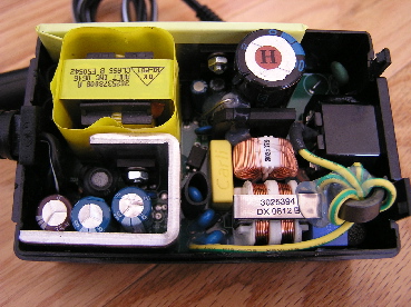

rob3262 said:Bob,
I have a few 24vdc / 2A power bricks hanging around. Would this be suitable to power the filter boards, or do I need to configure a split supply?
Thanks and regards,
Rob
If they are old linear pwr supplies you can open the bricks and re-use the transformers.
If they are SMPS then you're SOL.
Re: suitable PS
Thanks Bob & Troy
OK, filter requires split supply. I popped open a brick, switch mode
But the PS looks sophisticated, there's gotta be some use for it. So I did a quick search and found myself over at Rod Elliots ESP site, where he has posted Project 43.
I wasn't thinking of going the voltage divider route, but it's real simple to implement. The Dual Op amp supply would be easy enough, just a touch added complexity to the project.
What say the community - Divider network is sufficient, or the fiter requires better regulation? Regarding Rod's Op Amp buffered supply, would current limits be adequate for 2-3 filter boards (24v 1.7A input)? I have a half dozen of these bricks and wouldn't mind using them for something other than occupying space...
- Rob
Sorry Rob, the board is set up to require a split supply.

The bricks would be up to it, but the virtual ground might not. The ground opamp may need a booster (another dual opamp or emitter follower stage). Sure, not a lot of current SHOULD flow to ground and the rails should have balanced currents, but if something goes funny, you could toast everything.
I'm just a little leery of virtual grounds for a high quality application with no real reason. PSU 2.2 can be built (including transformer) for around $50...
