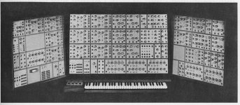

Meh the one I wanted was on ebay about 10 years ago. Some guys life's work to build a giant Moog rig. Full 8 note polyphony, which was madness in itself. But the best bit was the gimballed piano seat to give 2 additional axes of input! I seriously thought about the business case of fitting it into a 7.5 ton truck and renting it out!

Charles: Emu? or Arp 2500? Obviously you ve found the one i've never seen...
Emu.
