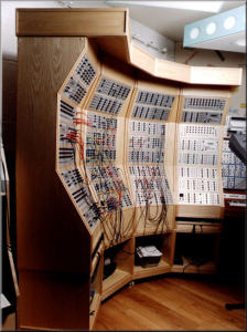

Damn you all. My modular synth (only a basic digisound kit) ended up in a skip with the divorce (long story). Always wanted another one. But this time bigger!
You want bigger?
Here is an Analogue Systems (not Solutions!) modular to aim for. ;-)

Please stop with synth porn!!!! It's time to go sleeping and i'll have wet dreams!
