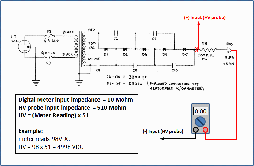

The first cap in the multiplier would only charge to 140VDC, not 280VDC like the rest. So, 105VDC is 75% of the maximum possible and is pretty much spot expected results for a 10Mohm load.
It just dawned on me that you could actually use the 500Mohm resistor in the Acoustat HV supply to rig up a temporary HV probe with 510Mohm input impedance. This would get you a lot closer to the actual unloaded HV.
Take a look at the attached image.
Disconnect all the diaphragm connection wires for the ESL panels from the HV supply, and connect the (+) probe from your meter to where the ESL panels had been connected. Then, disconnect the other end of the 500Mohm resistor from the HV supply. This would involve temporarily unsoldering its connection to the PC board. This end of the 500Mohm resistor would now become the (+) input for your HV probe. The (-) input is the (-) probe of your meter.
So, connect the (+) & (-) HV probe inputs to whatever you want to measure, for example, voltage across each capacitor. With 510Mohm input impedance, current draw is a lot less and you will see much closer to the expected values. Remember to multiply your reading on the meter by 51 to get the actual voltage.
You could even crank the Variac up so the output of the HV transformer was 750VAC since the meter will only see 1/51 of the applied voltage. So, if you were measuring the output of the multiplier and it was 5kV, the meter would only read about 98VDC.

I am a little confused... with 100VAC input on the voltage multiplier ladder,why do I have to correct for the 10M ohm loading of the DMM? I can see with very HV, but this is 100VAC.
If can properly read voltages on Tube Amp B+ of 500V with this DMM without any correction, why would I need to do so for these readings? Is it due to the extremely low currents we are dealing with?
Shouldn't my end of the bias ladder at end up 1/7.5 (with 100VAC) of the 5000V, which is 666VDC?
Voltage level has nothing to do with it.
It has to do with the ratio of your load impedance to the size of your power supply capacitors.
In the case of your tube amp, the power supply capacitors are probably 50uF to 100uF perhaps?
The HV ladder network capactors are only 3300pF, or about 15,000 to 30,000 times smaller storage capability.
So, the 10Mohm load on them would be like a 300 - 600 ohm load on the 500V tube power supply. That would make the tube amp supply sag just like you are seeing with the HV supply.

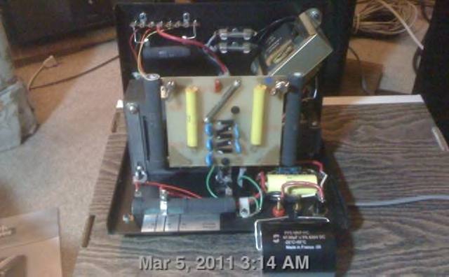

Yes it eze.....works great....look i have MartinLongan SL3s panles..that run at 3500 when i was working on my new bias that i can set from 4k-6 i would run the logen panels up to about 4500...sound great.... at just hear a little bzz ear right up to the panels...best the sl3 ever sounded..The Acousta are way diff...made to run fulrang....i have ran the Acoustat panels at 6k...no noise...but the topend get a little peky so i back of a little....but my bias is in it own box...it cant get pulled down like in the 121 interface box with the high low mixer 1"away with there on high V.that driving the panels.....Look at this pic....Dose anyone think this is a good way to setup a 5k bias???...I well say it works but come on....5k all over the box it in....It has to sound better out with it tranfourmer.away from the mixer....thanks for the info good post

OMG - you have to change out the old multiplier caps if you have not.
Then replace ALL of the HV diodes with new HV diodes.
Then you WILL get the required voltage.
The CLS beams plenty... fyi. It has a rotten interface.
Try the Acoustat interface on the CLS panels for fun. But the CLS does NOT have enough excursion to do bass right in the first place, but if you keep the levels lowish, it should work nicely. Give you more output too, probably. IF you need lower bias voltage, tap down the divider!
Change the caps and HV diodes.

OK, changed out the multiplier caps with 2000pf 10kv ones from Apexjr, but didn't bother with the diodes (they are good to 10kv, so should be ok), and I also added back the single cap diode link, so now should be around 6kv bias. Now it sounds a bit louder and quite a bit cleaner. I think this is it for these speakers. Just perfect now...

repeat: replace the diodes.
they die, if they are the stock originals. few interfaces survive to this date without either the caps dying and/or the diodes as well. Not all of the diodes, or all of the caps, but it is best to replace them all and not have to go back and do it again in a short while when the next one dies...
