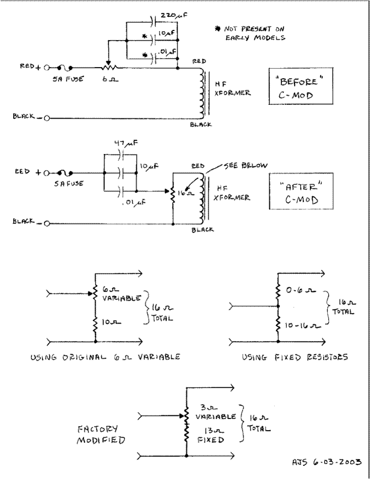

Anyway, as soon as I turned on the TNT-200, I got a power "pulsing" and one of the audio fuses blew on the same speaker that had the bad fuse initially. I checked all the schematics for 121-MK-2A and noticed 5A instead of 3A audio line fuse. I changed both to 5A and tried again, but on the TNT-200, it still get the "pulses" for a few seconds with no sound from the speakers, and I shut off the amp. The amp continues to work perfectly fine with other cone speakers, and my CLS (although crossed over at 125hz and higher)
The Icepower play fine as does the Krell, but at certain high-ish volume, I get speaker cut out on both, where I just lower volume and all is OK (amp protection at work?) I tried the Aleph 5 I have and it also pulsed like the TNT-200....
I, later, did the C-Mod as shown on the Acoustat thread. I thought maybe the 10 ohm resistor across the speakers inputs / step-up trannys would give something the amp could work against, but still get the pulsing.
Don't know what the issue is...Am I saturating the LF cores? Whyis it just these certain amps? And the TNT was specifically designed to run these amps...

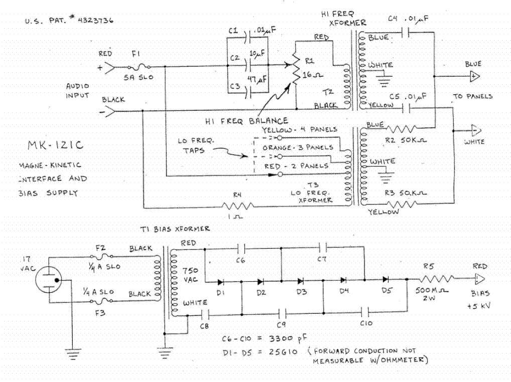

Overall schematics attached - I reused the 6 ohm variable pot and added the 10ohm resistor (50W) as shown in attached...

The DCR should be higher than 1 ohm.
It should be the DCR of the bass transformer windings plus the series resistor (1 ohm).
The impedance of the IIIs are about 6 ohms minimum.

There is only the single 1 ohm resistor in series with the LF transformer. But the DCR of the low and high transformers audio side windings are usually quite low - less than 1 ohm a piece, correct? So series 1 ohm with the LF transformer and paralleled resistance of the HF transformers should be close to 1 ohm (btw - my voltmeter resolution at low resistance is crap). What should the DCR be at the speaker inputs?

for some reason I expected 3-4 ohms also, but I guess I never measured. I have several models available, so here is a list. Also, in the original Acoustat owners manual, they are all listed as "Nominal Impedance:4ohms". After I had the first unexpectedly low number I decided to get a bit more serious.
So these numbers are straight resistance numbers at the speaker input banana jacks hot and ground, and on 2 of the interface units I was able to get directly to the low frequency primary taps. I checked both channels of each Model and left and right channels were all basically the same.
All these numbers are pretty much at my measurment limits using an old 4 1/2 digit meter. I did check it against a 3.92 ohm 0.1 percent resistor and my meter reads 3.90 so hopefully I am fairly close, but don't bet any money on these numbers.
so here goes:
Model 3 with MK-121-2A (no Medallion labels) (each tap setting measured at input jack hot to ground) (brown paper transformers)(interface appears unmodified with a blue 220uf EL cap and yellow 0.01 uf and 10uf film cap and, and a monster cable label, and corroding internal monster cable)
At input banana jack. Red tap = 1.22 ohm
At input banana jack. Orange tap = 1.3 ohm
At input banana jack. Yellow tap = 1.33ohm
yellow to brown = .38 ohm (Directly across the low frequency transformer primary at tap terminal strip)
HF transformer alone = 0.07 ohms (red lead lifted to common)
I resoldered the red lead and again measured at the output jack and unplugged the low frequency tap lead and measured 5.99 ohms, so that is the resistance of the HI FREQ balance control in series with the HF transformer and without the low frequency transformer in parallel.

Putting th 10 ohm resistor across the primary side of the treble tranny (C- Mod) probably does some good, but a series resistor on the speaker inputs would probably help make more amps usable, albeit lower spl...
