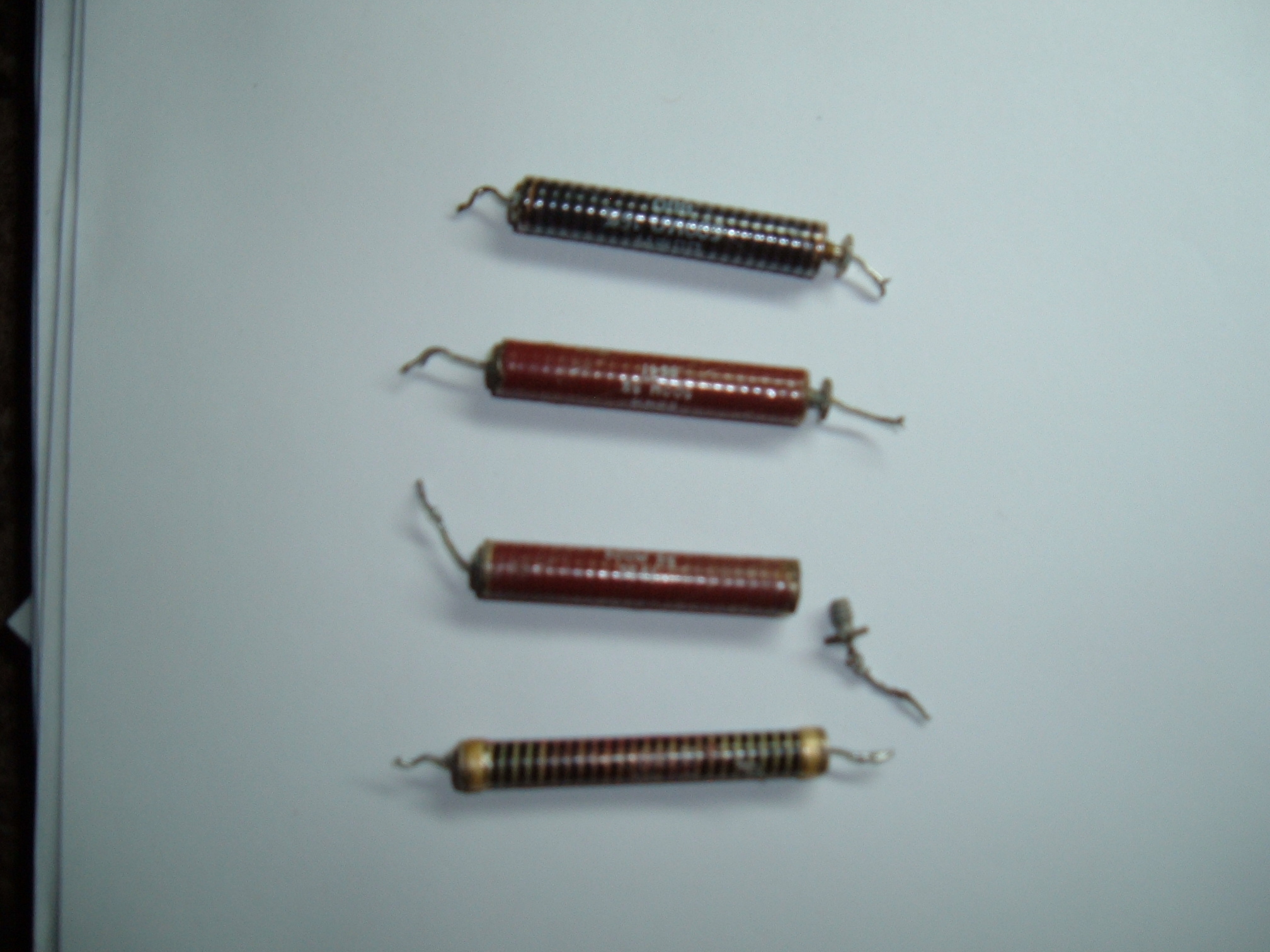

I think your right, since I replaced the 500Ohm resistors it seems much better.
Here a pic.....of SOME of the stock type 500meg bias feeder res.....as you can see the small ends on some..... can be-come UNSCREWED....Get lose over 20-or more years...make you lose bias output to the panels.......this setup....has gave ME..... bias loss for me in the past......some time ok..then low output...
I post this because these ....are NOT a ezey res....to find off the shelf....
.....just one more thing to help with getting great sound out of some of the best ESLs ever made........

replacement HV resistors from Ultra High Voltage Components
500M Ohm 2W 15kV 5% Non-inductive High Voltage Resistor Glass Glaze
