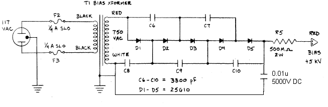

My Acoustat 2+2 are awesome , but now that winter is down here they distort when humidity is very high, especially after heavy rainfall.
I replaced the HV caps and diodes with HV rated devices, made a big difference and brought them back to original sound. I also made the final cap bigger, for a considerable increase in dynamics I thought. From memory I think it was 0.05uF. Maybe I have too much voltage now and is causing distortion when humidity high? Have you experience of distortion in winter?
Like this

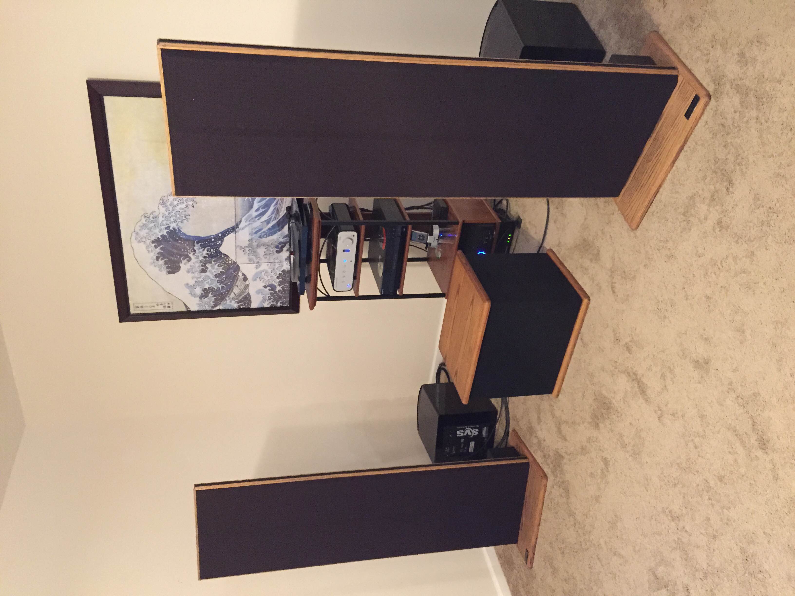

SPW-1 DONE
Well then I got the SPW-1 and the speakers all done and they sound great. I will be compiling pics and info from the teardown and rebuild of the SPW-1 specifically so that people might be able to rebuild theirs. So far it sounds great for vintage 90's gear.

Bias being pulldown by humidity....
or just low bias....makes the tran- parts work harder...all parts get hoter...
So how do I an others deal with this.....add more bias....I run my bias over 6k...an drop the stock bias feed res from 500mg..... to 10mg.....an run AC in my home to get rit of humidity...........but that me........
As you see the stock bias is less the 5k...then after the bias feeder of 500mg... when your driving the 2+2 you have about 3-4k.....good luck
Although I am not in favor of any modifications to the bias supply, I doubt that the added .05-uF capacitor is causing your problem, provided that is it connected as shown in your other post. However, if there is any doubt, remove the added capacitor and see if the situation improves.
When the Acoustat panel was being developed, extensive research and field-testing was done to make sure that there would be little or no performance change in conditions of high and low humidity, and high and low altitude. I think the design was successful in that regard, as I have operated Acoustats in both Florida (with god-awful high humidity and near sea-level) and in Arizona (with skin-cracking dryness at about 1200 feet above sea level). I have never noticed any difference in performance between these two very different climates or any seasonal changes.
If you mean a crackling or similar noise on large bass notes when you say 'distortion', this may be caused by an increased tendency of the air to ionize
under high humidity, which might cause (non-destructive) high-voltage 'sizzle' under large excursions. This condition may be aggravated by dirty panels, so perhaps a thorough vacuuming and/or blowing out with compressed air might help the problem.
There in a shed workshop so quite possible they are dirty, I'll give a them a vacuum , thanks for that.
