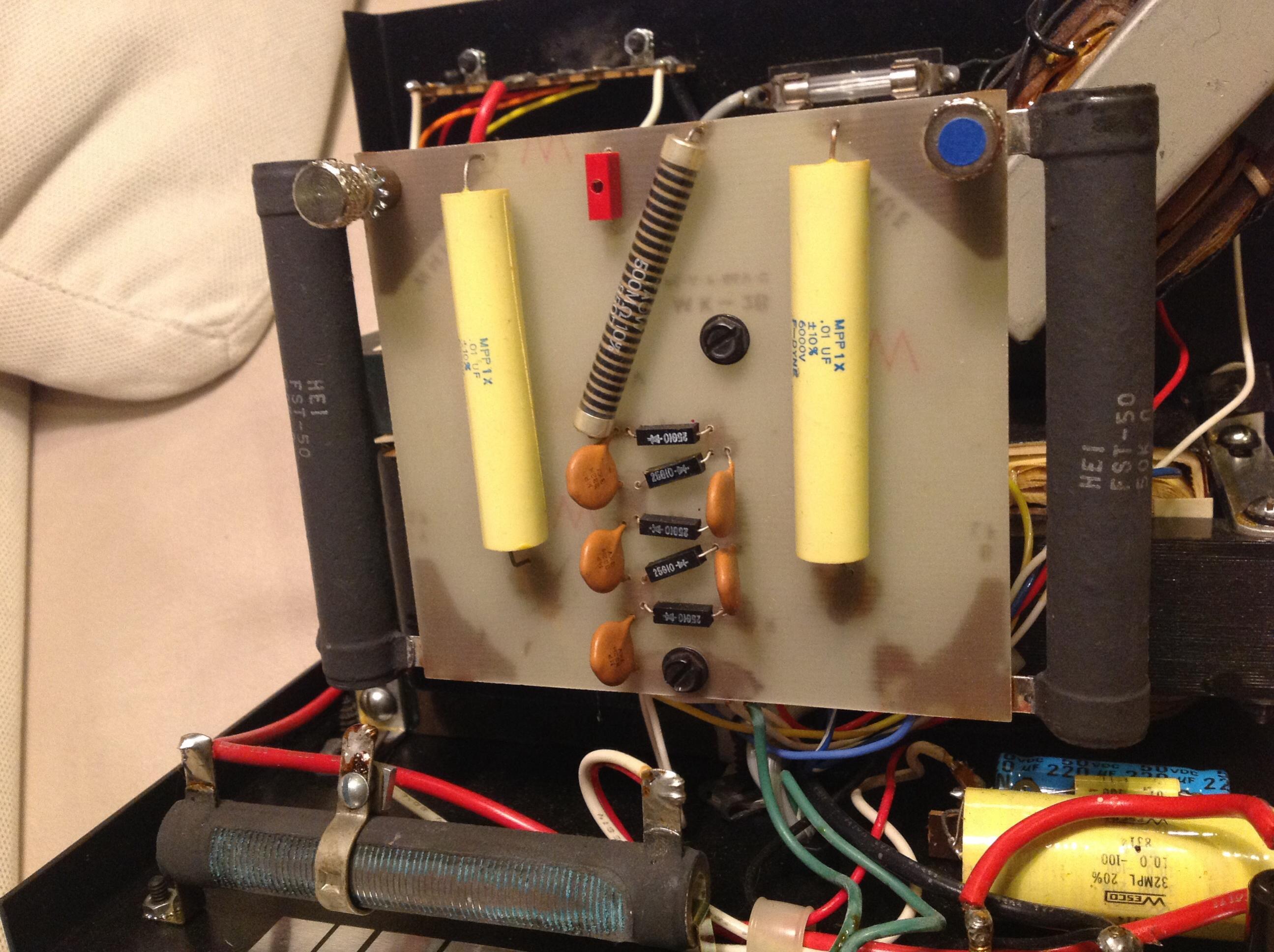

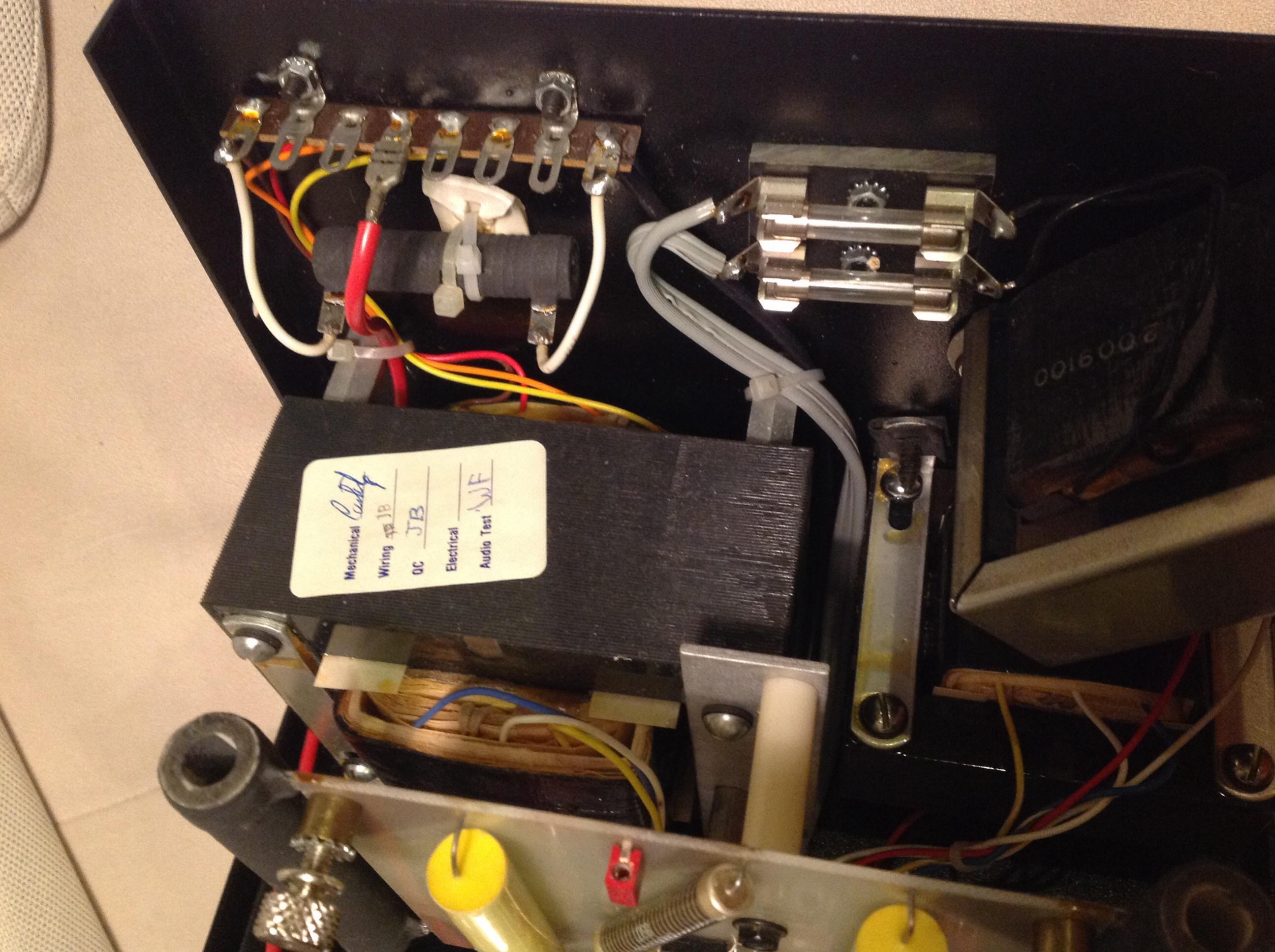

Help with Acoustat 1+1 speakers.
I would appreciate any help. I recently bought a set of these with the blue medallion interfaces from CL. the owner mentioned the original owner of these was Mike Scott, the first CEO of Apple computers. In any case, he said they worked fine when he last used them. when I arrived to pick them up, they were disconnected. after getting these home, i plugged them in and got a loud sound from one speaker. the other was fine. switching the interfaces isolated the problem to one interface. the panels are fine. My questions are: has anyone here assembled a list of electronic components to rebuild the interface if the transformers are okay? how to check if transformers are okay? can an electronics neophyte with a solder iron hope to repair this, or do i have to send it to Roy Esposito? Thank you
A 'loud sound' coming from the interface is a very unusual symptom. There really isn't anything that I can think of that would produce such a problem. Can you perhaps describe the nature of this sound? Was it a humming sound, a screeching sound, what?
Another question - was it the same amplifier channel that produced the loud sound? I'm wondering if your amplifier channel might have a marginal stability problem when connected to the interface, that caused it to oscillate. Or does the sound occur with no amplifier connected?
I should clarify that the sound came from the panels. Upon switching the interfaces from one panel to the other, the affected interface which caused due out sound to be produced from both panels. But the panel sounded fine with the normal functioning interface.
Yes, I had assumed that the 'loud sound' was coming from the panels. But please do describe the nature of the sound, and whether the same amplifier channel was connected to the 'bad' interface when tested on both panels. Does the 'bad interface' play music along with the loud sound, or just the loud sound? I'll need a little more help if I have any hope of helping you with this very unusual symptom. I've been working with Acoustat speakers for nearly 30 years and have yet to hear of an interface doing this.
i talked to the owner, and he wonders if the sound is from a 60 sec hum. Is this plausible from an acoustic interface?
A 60 cycle hum is an extremely unlikely fault mode from an Acoustat interface unless someone has done some crazy modifications to it, or perhaps a wire has become disconnected and is touching something it shouldn't. This is why I was attempting to get you to describe the nature of the sound, whether it was a 60-cycle hum or a higher pitched sound.
Take a look at the low frequency transformer tap in each interface. This is a multiple-position terminal strip with a user-adjustable position of a push-on spade terminal. For the 1+1, it should be set to the terminal with the small red wire. Having this tap set incorrectly will NOT cause any problems, but I am wondering if the tap may be set differently in the two interfaces. The position of the tap does change the impedance, and it's possible your amplifier is stable in one position and not the other. What amplifier are you using?
Also, try setting the two interfaces next to each other on a table, and compare the two for any differences in wiring, component position, etc.

It's hard to describe the sound. Not like a fire alarm, but loud. I could not find anything different between the two boxes. No loose wires. Here are some high res pics from my iPad. Thank you all for helping. Looks like I can only upload a picture at a time.
