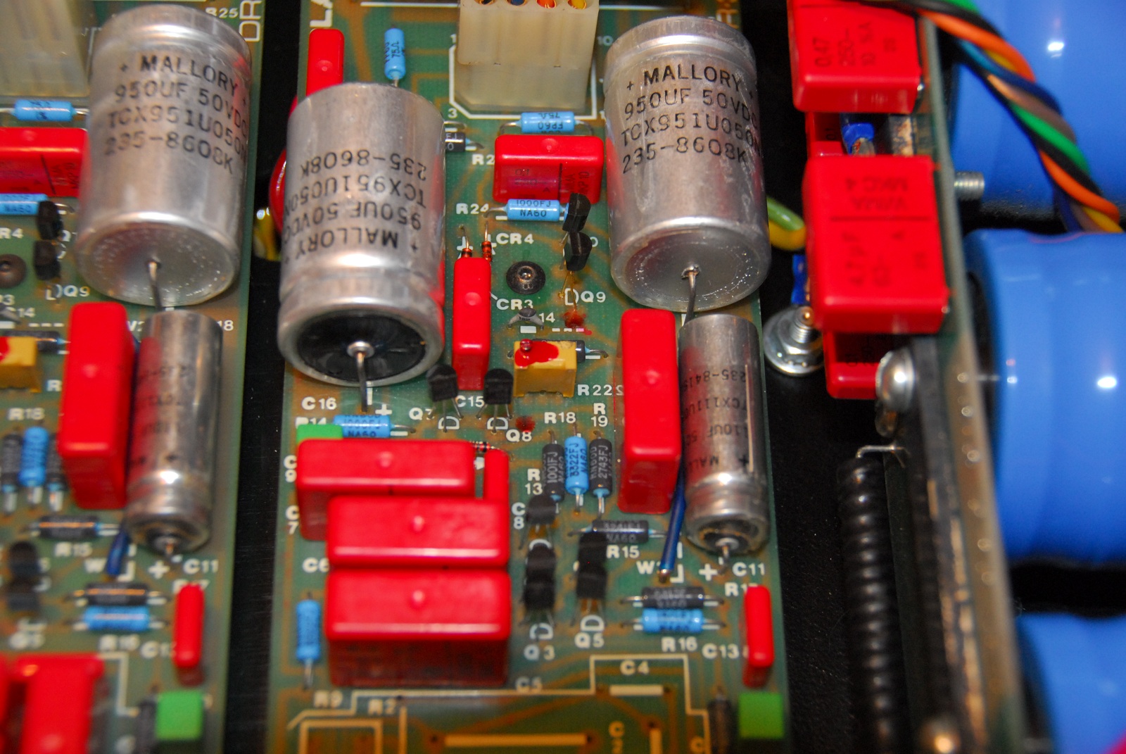

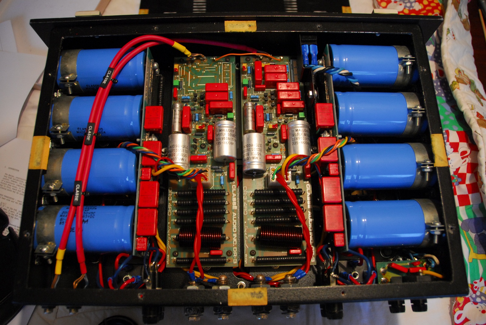

Just Got a Classé DR-3 (the little one) from a store.
Have trouble to get the bias and offset stable even with the Service Manual.
I can run it on halfpower (250 Watts AC intake instead of the 500 Watts spec) and still remain easily in Class A for the power that I need with the speakers I use.
One channel has a fluctuating DC offset reading that could be solved by substituting the two inputtransistors (TO92´s MPSA53 location Q3 and Q4) by MPS8599 according to a handwritten add on in de SM.
When I run at 250 Watts intake without a load I get decent readings like ± 15mV max in the problem channel.
As soon as I connect a speaker load the reading goes to -150mV and remains stable at the other channel (+ 3mV).
I wish I knew what kind of outputtransistors are used in the DR-3 so I can buy them and change them all just to be sure.
Any thoughts/advice?
I promised the store that I could keep them for two weeks before I decide and one week has already past.
Unit sounds great but I do not dare to use int on my Acoustats 2 + 2´s afraid that the DR-3 suffers a bias runaway and kills the Acoustats and then itself...

If i was you i would try to contact Dave Reich the last time i spoke with him he worked for Theta Digital - - - 1 323 278 0001 hope that this can help good luck.

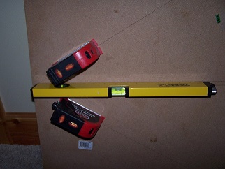

I figured as long as I'm here I'd add something useful to the conversation. We all know how difficult it is to properly place Acoustats. Here is my solution, and it worked wonderfully.
First off you will need a Black and Decker Bullseye auto leveling laser, part number BDL-170. I bought mine a Lowes a while ago for hanging pictures etc. The unit has a locked mode that will project a vertical beam from the front approximately 6 feet long. Turn the laser on in this mode and center it on top of your speaker. There are little feet on the bottom that will align with the rear ridge in the top of the Acoustats, effectively making it square with the frame and projecting a beam precisely where the center of the speaker is aiming. From there you can easily position the speaker to aim exactly where you want it. I positioned mine so the center of each speaker aims perfectly at my ear on the same side.
This is perfect for me, although you may want to experiment as outlined in the Acoustat owners manual. Hopefully this helps in your setup and helps repay you all for me being a PITA!
