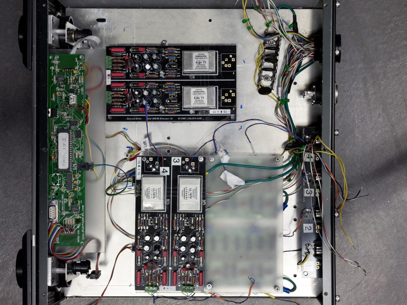

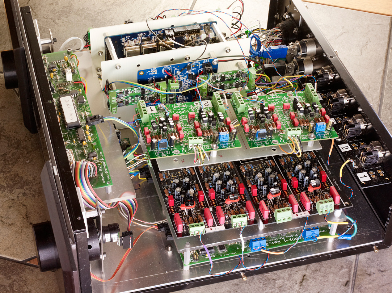

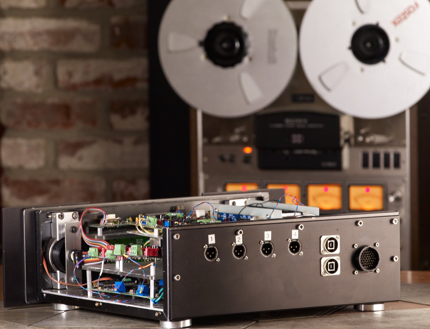

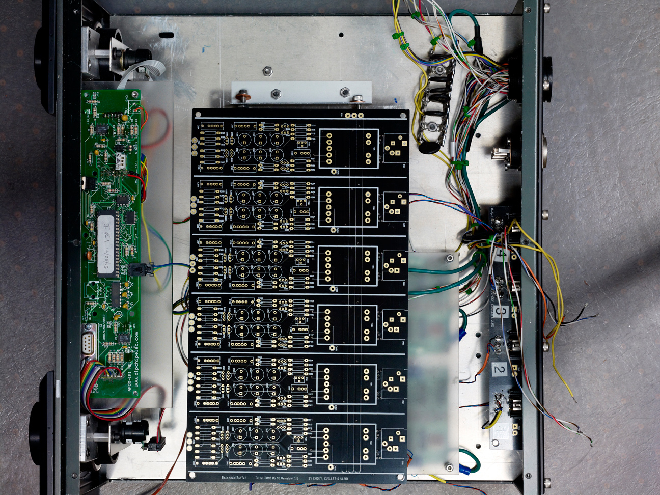

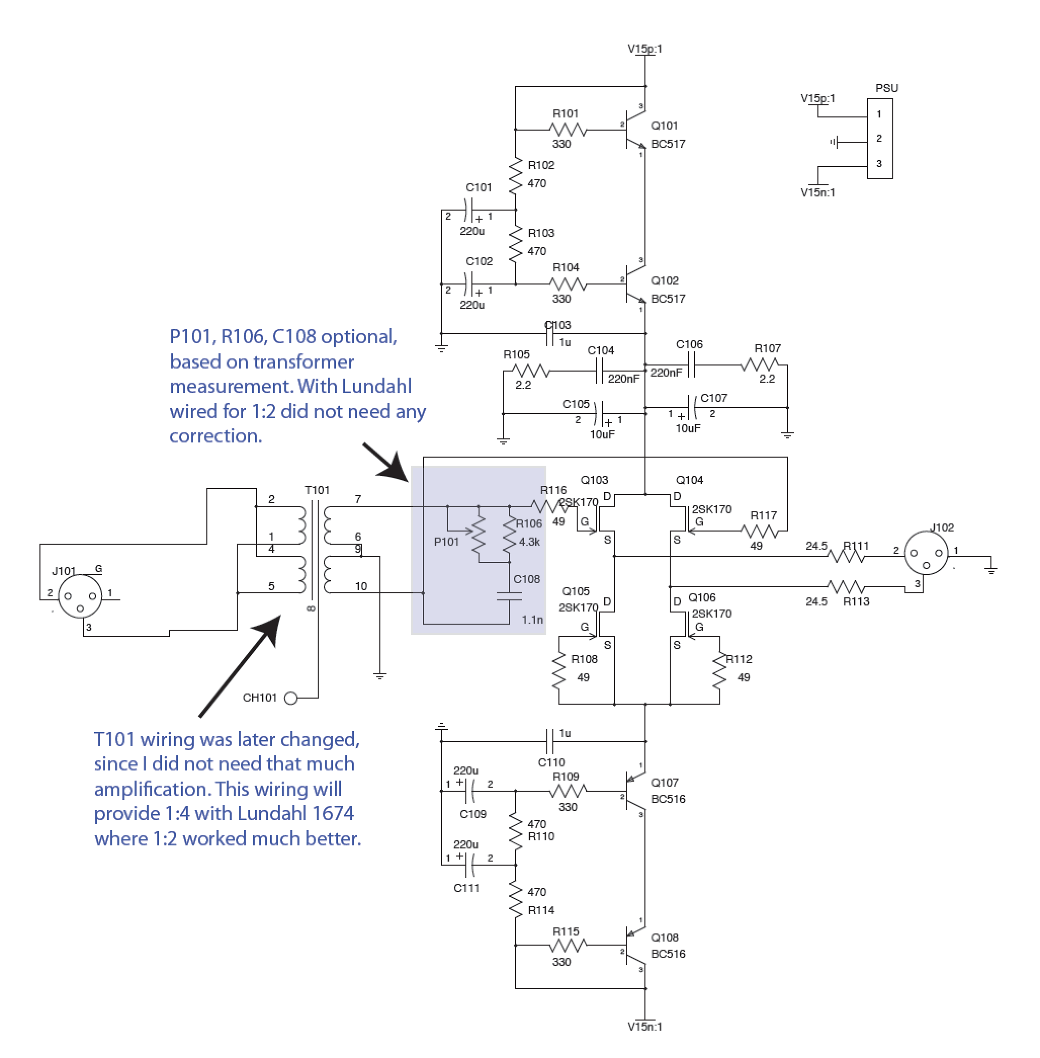

Hi there AR2, great work.
Could you point me to further information on the jfet buffers you are using ?
Thank you deanoUK.
Here is the schematic of buffers I am using. I posted picture and PDF, so it is easier to read for you. Buffer could be stand alone, without trafo, but together it was intended and used as an output stage for voltage out DACs, particularly AK4396. It is an outstanding unit and very versatile. As you could see there are no caps in the line of signal, and any DC coming out of DAC is blocked by Lundahl. Originally it was designed to be 1+1 : 4+4 but that was too much and I am using it as 1 +1 : 2 + 2. That also gives much less distortion.
Here are some shots of populated boards as well as empty ones, and some of many implementations I did in the process of making my DAC. I do not have any more boards, but if you would like to make your own I will be happy to send you gerber files.
