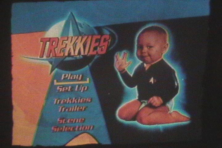

I recently harvested a screen from one of those PSone lcd's.
Slapped the whole thing together last night and documented it.
You can check out my results at
www.geocities.com/tweakerprojects
This is about 50" at 8-9 feet from the wall.
Im allready working on a metal and wood housing for the screen.
The picture is way worse than the projected image.

I live in a ****-box little garage apartment, so I don't really have room to throw a very large image.
Biggest I can go is about 70-80"... The pixels are plainly visible at this size up close... but not too bad. I can still watch it comfortably from 7-8 feet away.
You can see how much better the picture would be with a higher resolution lcd
The light source is an unmodified 3M 522 projector.
I have no idea about the lumen output. Brightness isn't an issue though
