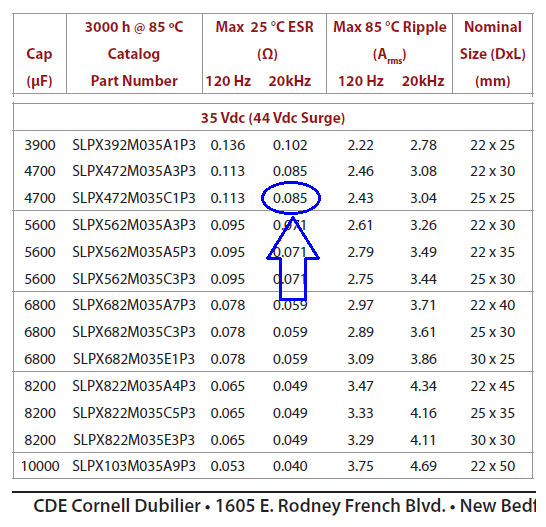

Whoops, I think you might have accidentally assumed ideal perfect resistors and ideal perfect capacitors in your simulations or hand calculations.these two cascaded R-C filters add more than 120 db attenuation above 20kHz.
Real capacitors have nonzero Equivalent Series Resistance; this parameter is often listed on the capacitor datasheet. If not, you can easily compute it from the (tan delta @ 120 Hz) number that is on the datasheet. Thanks to ESR, your RCRC filter becomes a resistive ladder network at high frequencies. The ladder's horizontal resistances are 2.2 ohms, and the vertical resistances (to ground) are the capacitors' ESR. Oops, attenuation is now quite a bit smaller.
Real capacitors also have nonzero Equivalent Series Inductance thanks to their leads and to their internal construction. Cornell Dubilier has some helpful application notes which describe how to estimate ESL. Series inductance reduces the capacitor's effectiveness at high frequencies.
As an example, this 4700 uF capacitor from Cornell Dubilier has an ESR of 85 milliohms at 20 kHz, as shown in the datasheet image below.
One way to get greater HF attenuation, is to design the series (horizontal) legs of the RCRC filter, to have rising impedance at high frequencies. And one way to get rising impedance at higher frequencies, is to include some inductance in the series legs. You could use high-inductance resistors, or actual inductor components, or ferrite beads, or a combination of them. If you use actual inductors, make sure the resulting LC resonant circuits are overdamped (damping factor zeta > 1) to avoid oscillatory ringing; this can be accomplished by adding resistors to make the RLC circuits overdamped.

My fault: I have included 100mΩ series resistance in my simulations, but forgot to say so. Still, I said 120db to give an idea of how big it is, even though it will get lower.
Yes, I think I got nice results for 50mH of series inductance - nice dumping, and even up to 100mH the peak was below 10Hz - hardly an issue. I will condsider the beads maybe. What is their equivalent behaviour? Just a series inductance?
I am planning to use some Nippon-Chemicon caps. But the following seemed weird to me:
The type I will use quotes for Ωmax=13mΩ at 100kHz (and 38mΩ at-10C, but I don't think I will get there ). Still, quotes for tanδ(max)=0.22 for 20C, 120Hz. Which gives a maximum ESR of 780mΩ!
Which one should I use in my simulations? I have been able to get good attenuation with both values, but obviously there is huge difference.
And for ESL, I read somewhere about a typical value of 10nH-30nH for radial lead types. Sounds reasonable?
