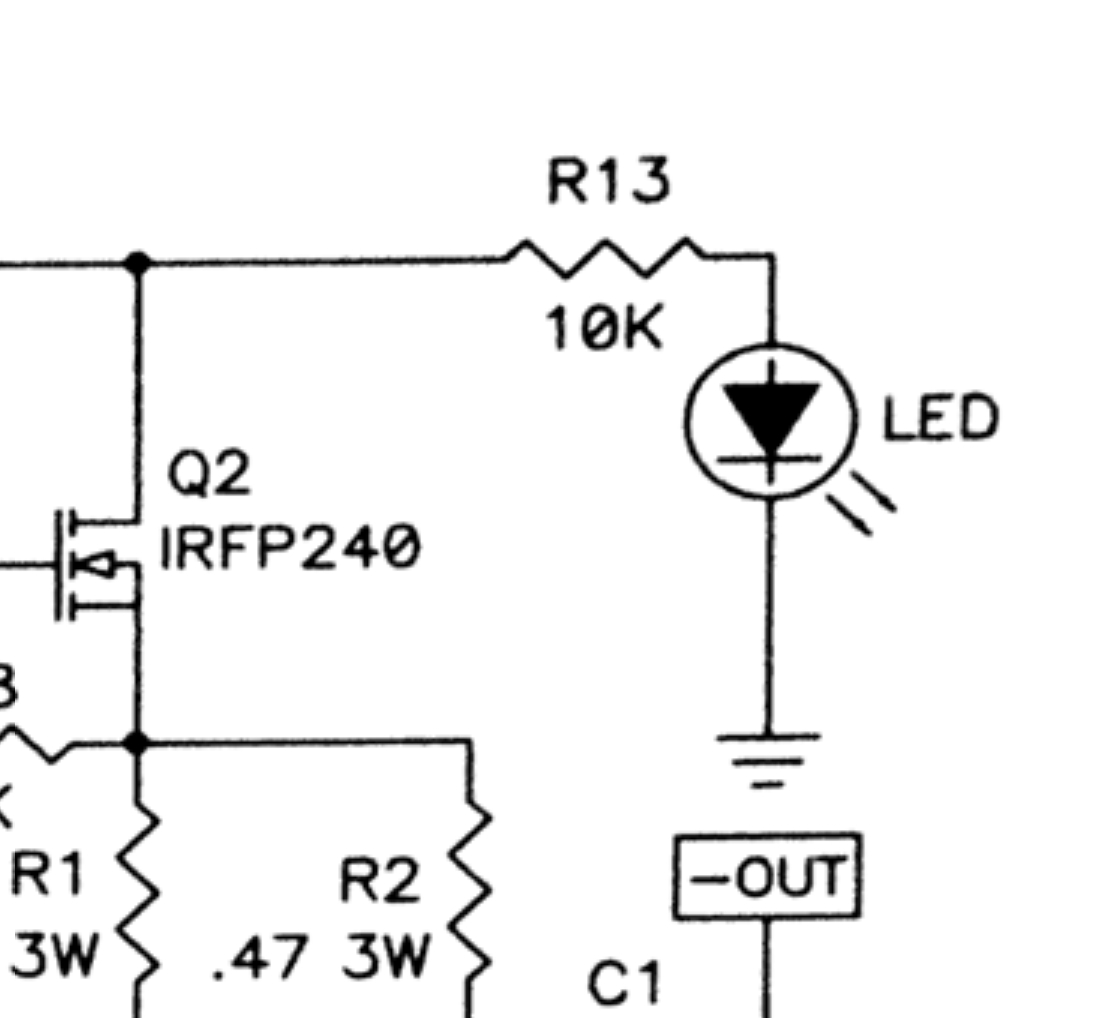

Thanks so much for this. I’m in the middle of giving it a try and swear I couldn’t find R13 anywhere on that schematic!

awesome, thanks! i also made this table, maybe it will also be helpful:
R1 .47 3W
R2 .47 3W
R3 .68 3W
R4 .68 3W
R5 100
R6 100
R7 10k
R8 1K
R9 1K
R10 332K
R11 10K
R12 39.2K
R13 10k
R14 1K
R15 2.21k
C1 3300
C2 1000
C3 10
C4 10
Q1 IRFP240
Q2 IRFP240
Q3 ZTX450
Q4 2SK170
P1 5K

Soundhappy - The ACA's CCS is most accurately called a Mu-Follower.
The output node between the power resistors and the CCS on top of those resistors allows the CCS to vary into the load
to help the output device drive it. (More power, more damping)
ACA is a Single-Ended common source amplifier with his CCS special Mu-Follower variant. I get it :D
