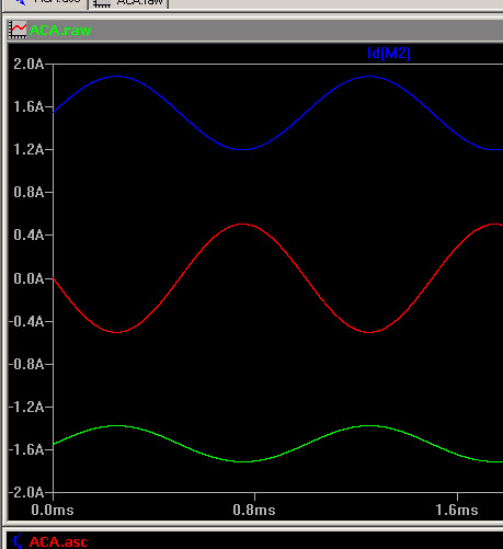

The distortion pattern will look a bit different?

I assume THD will be less in the bridged version with less 2nd harmonic....but is 2nd harmonic still the most dominant?

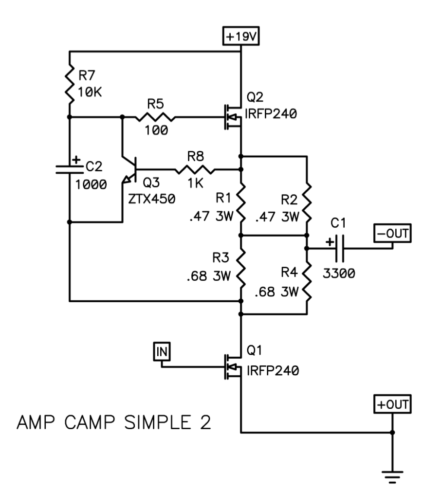

whose current contribution , in overall seesaw fun , is 33% minimum

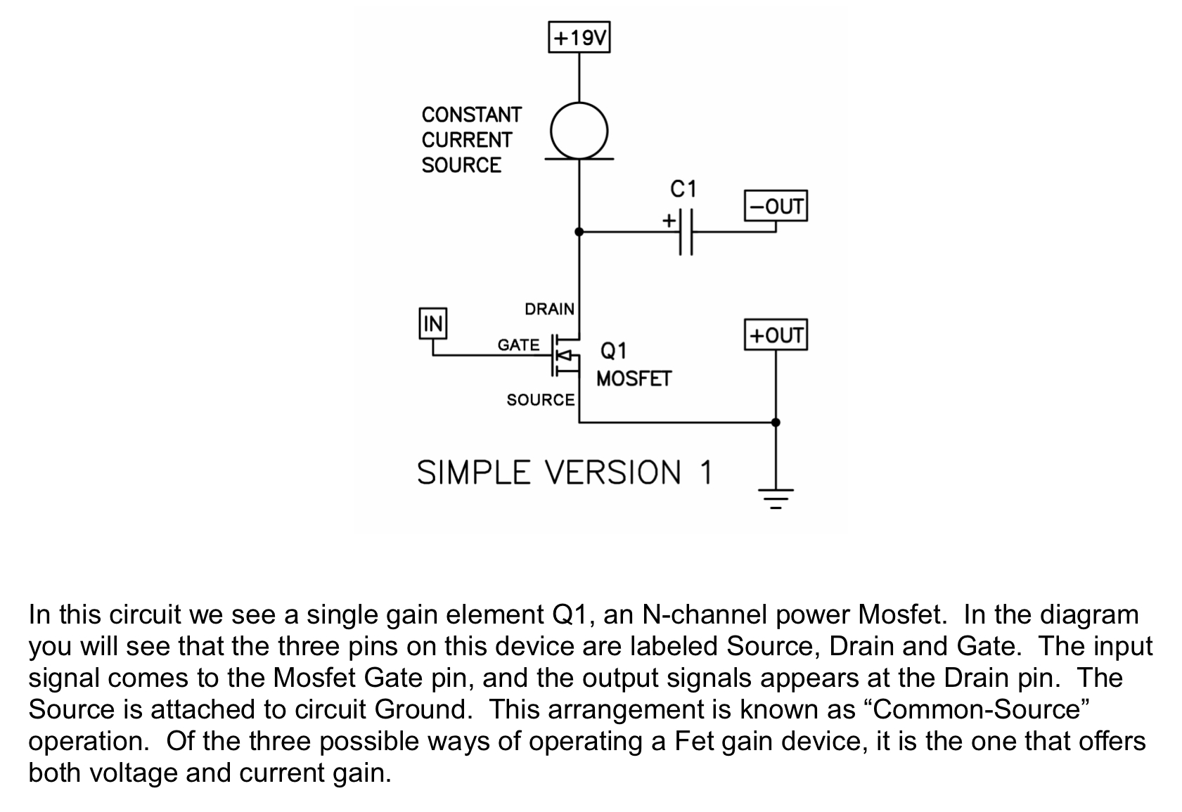

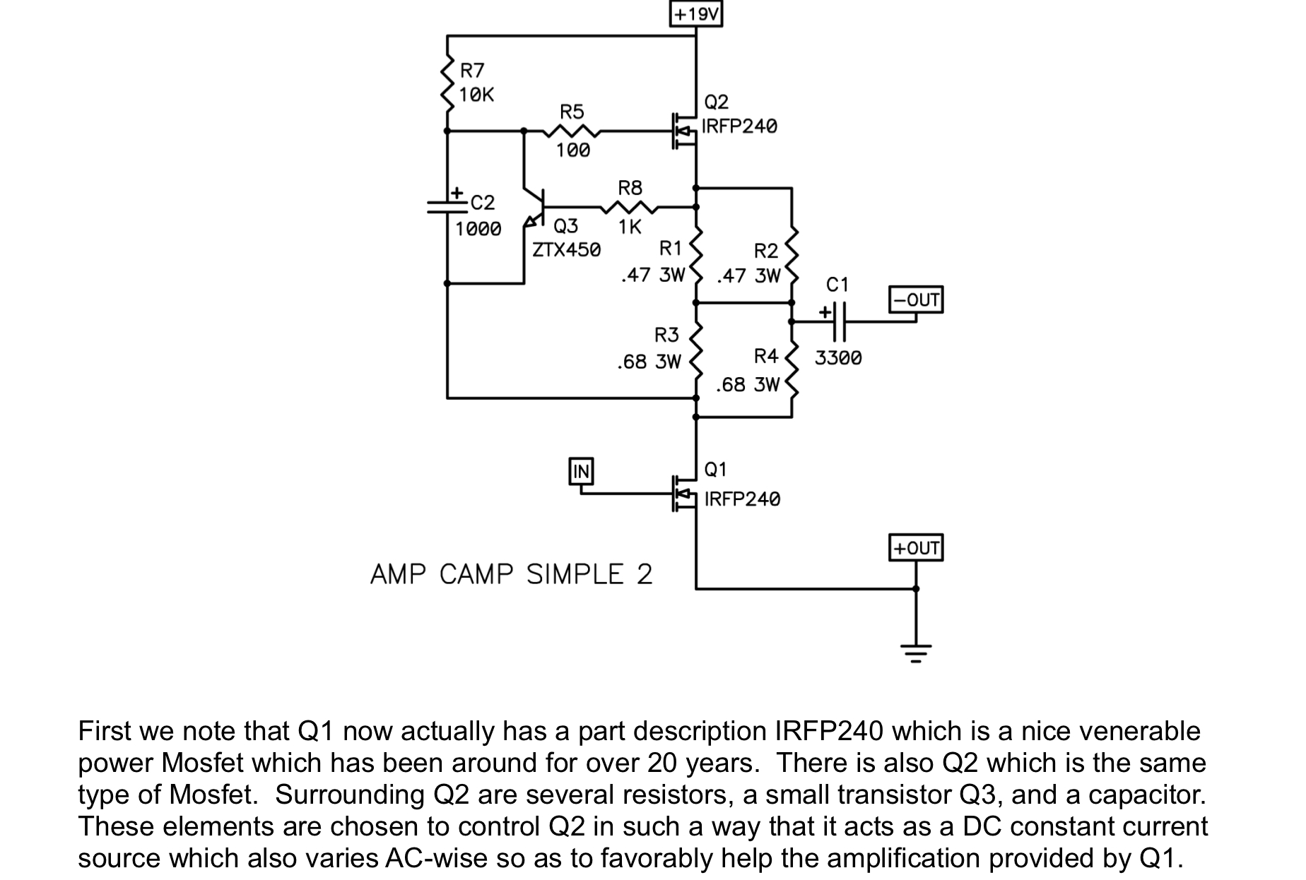

In the extract of FW ACA article I read Q1 mosfet is operated SE :checked:
Q2 help AC-wise for Q1 but do that mean ACA is a PP amp....?

Soundhappy - The ACA's CCS is most accurately called a Mu-Follower. The output node between the power resistors and the CCS on top of those resistors allows the CCS to vary into the load to help the output device drive it. (More power, more damping)
