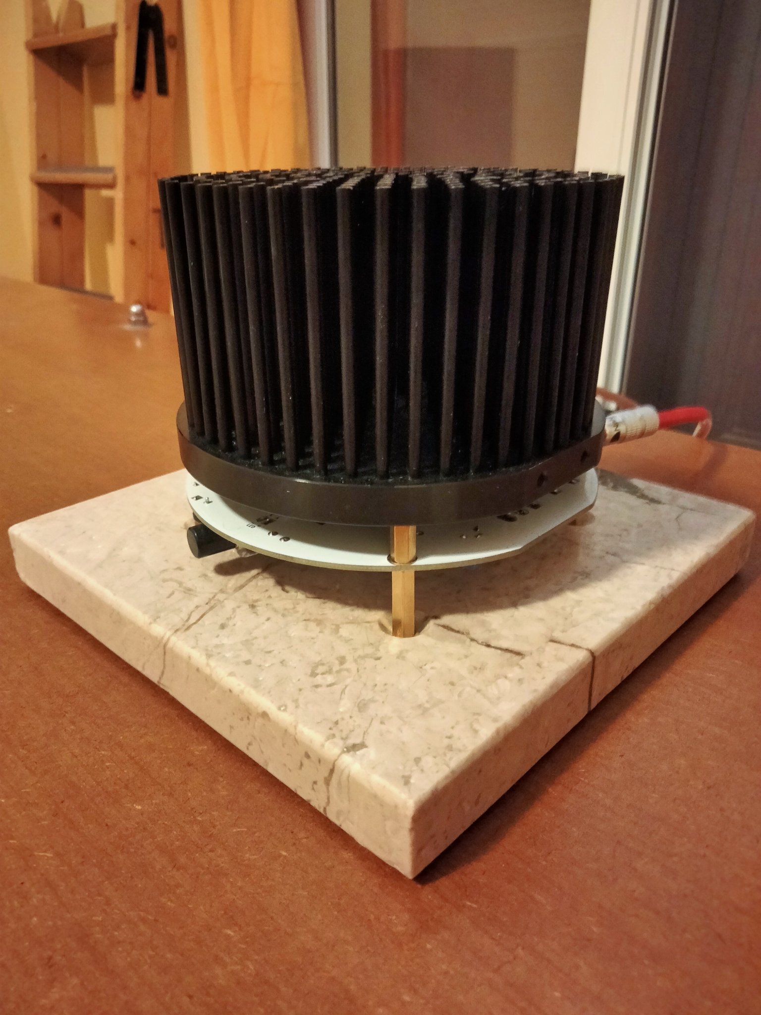

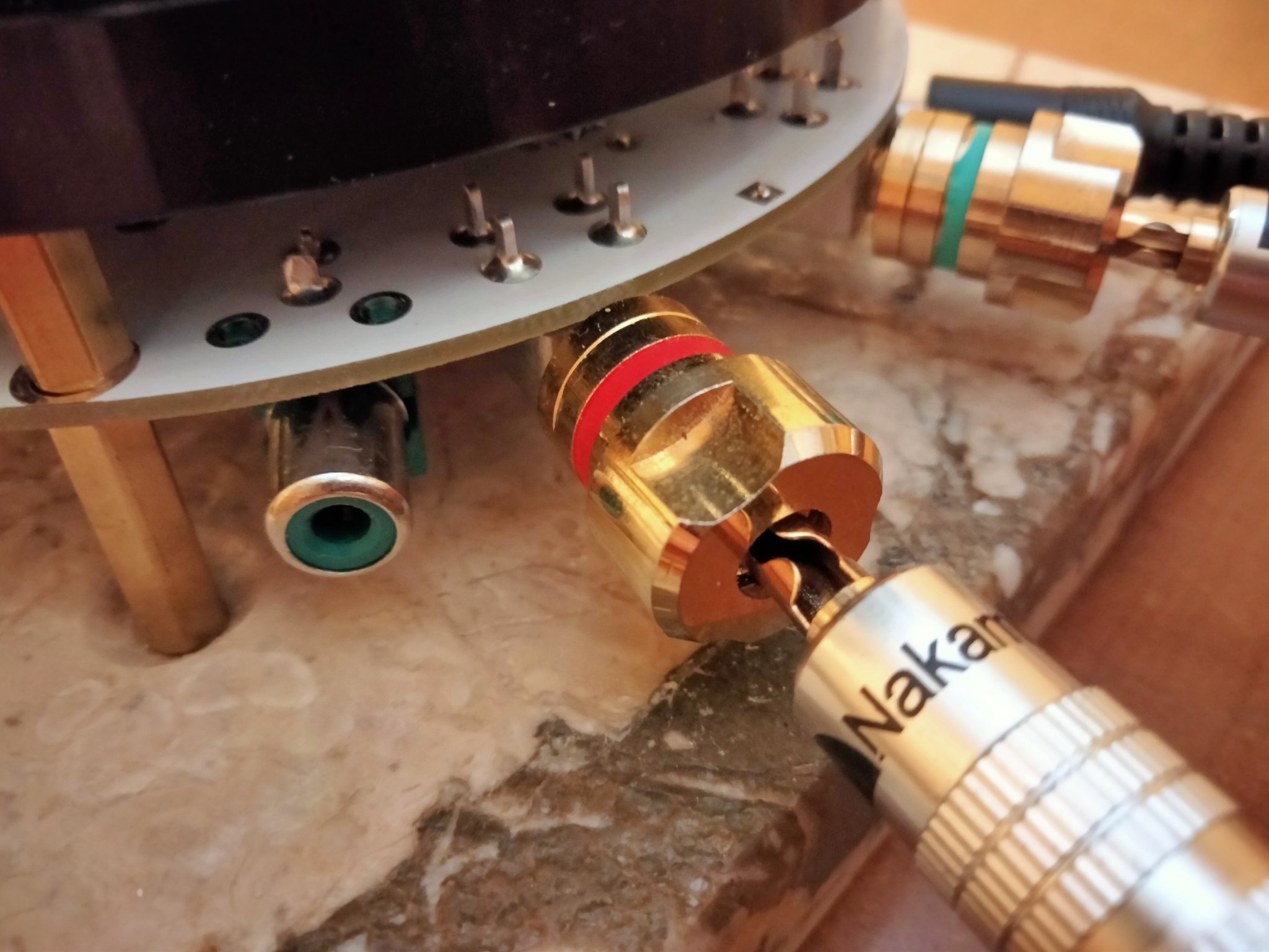

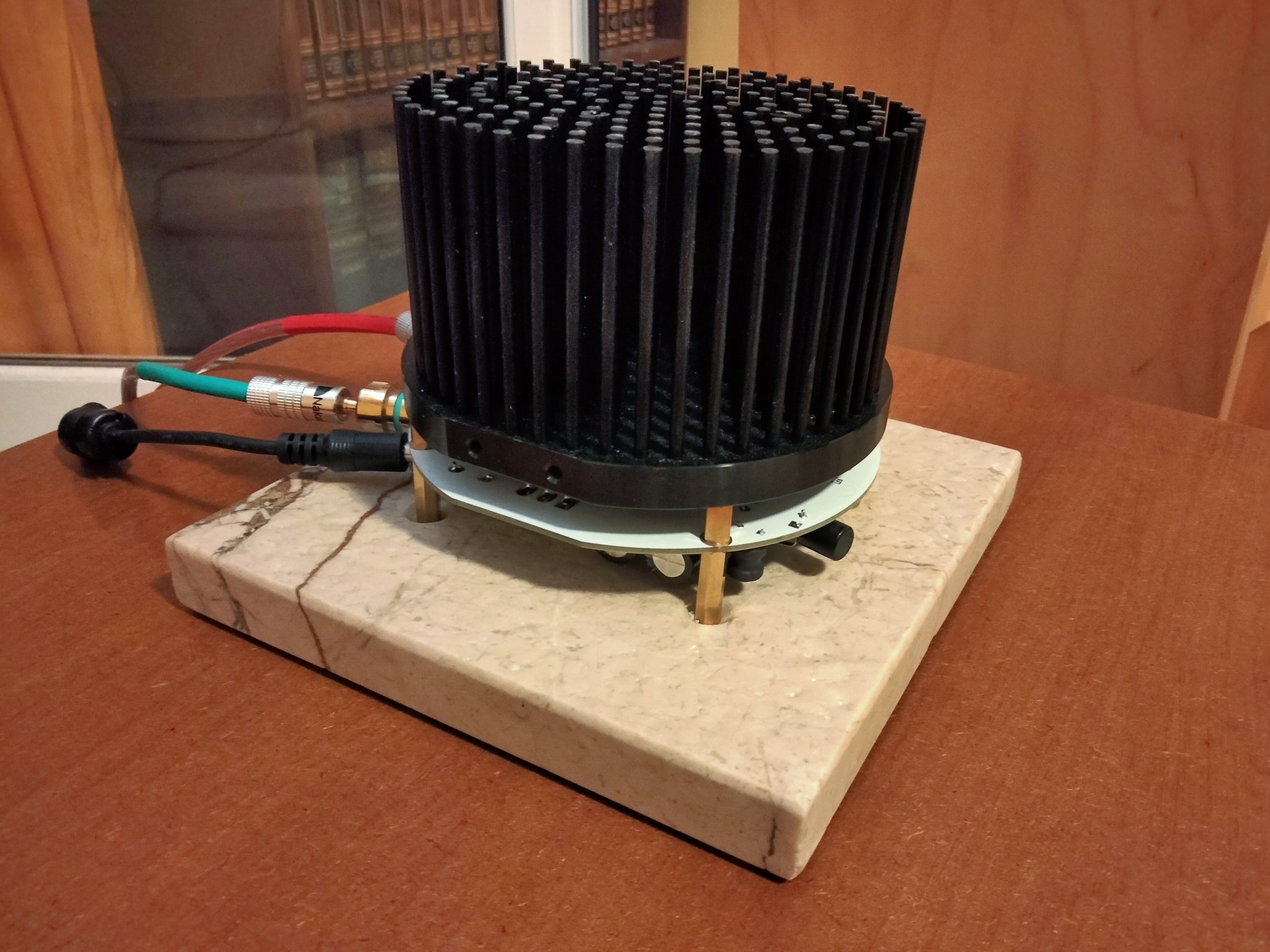

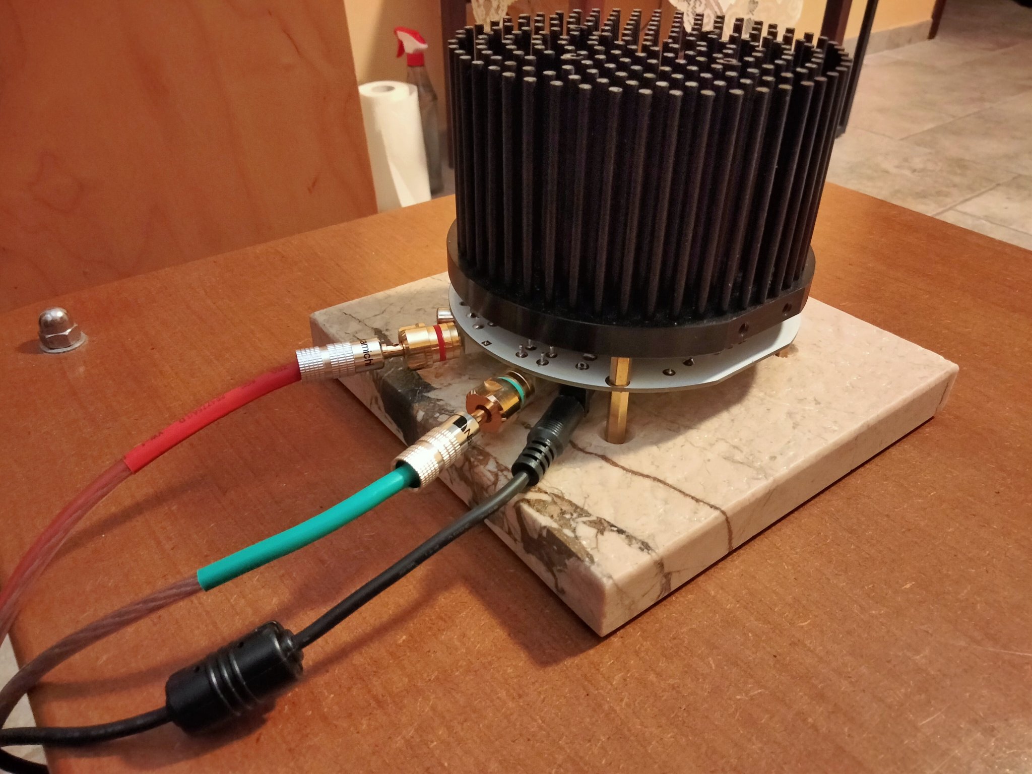

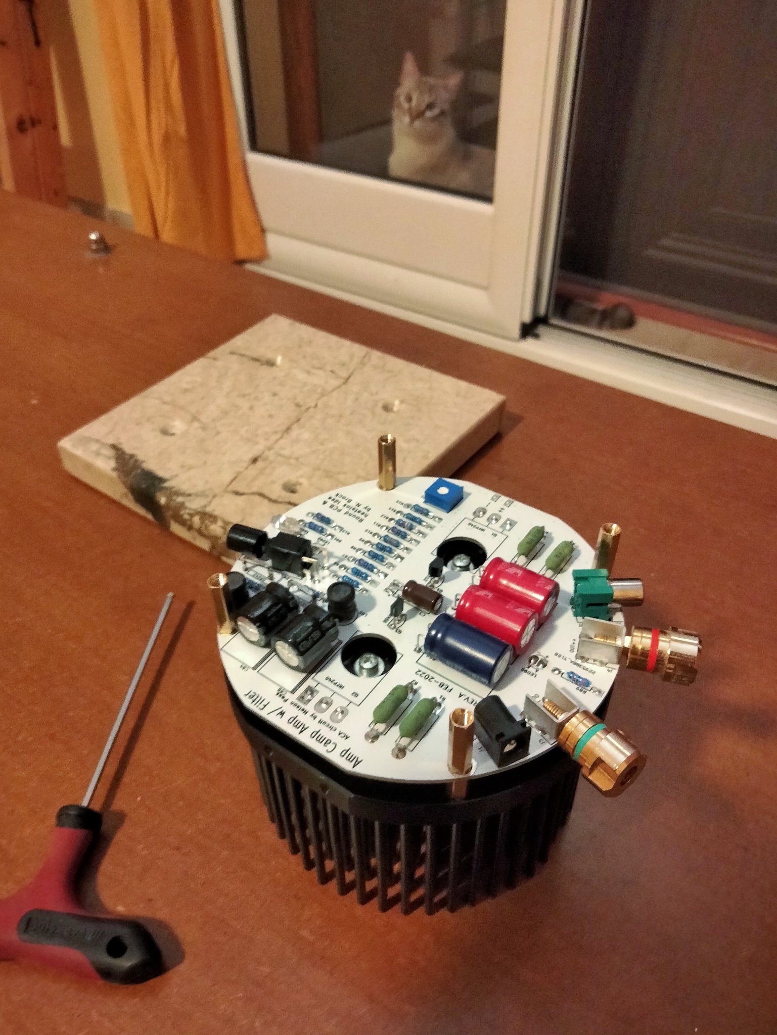

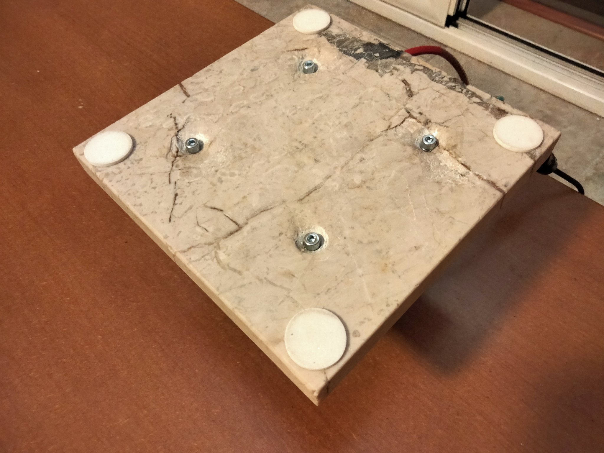

Nelson Brock's original photos included many clever ideas and cute implementation choices that I gladly copied when I built my pair of monoblock amps. Including
* Soldering the speaker binding post's M4 threaded bolt, to the 90 degree mounted PCB connector. Now it can't vibrate out.
* Using black nylon spacers for the final four "legs" that touch the tabletop which supports the weight of the monoblock. Nylon is less likely to scratch wood or glass, than metal.

Yes, but I cannot find them here. I'd like to try some nice drawer handles, as they have an M4 thread.Using black nylon spacers for the final four "legs" that touch the tabletop which supports the weight of the monoblock. Nylon is less likely to scratch wood or glass, than metal.

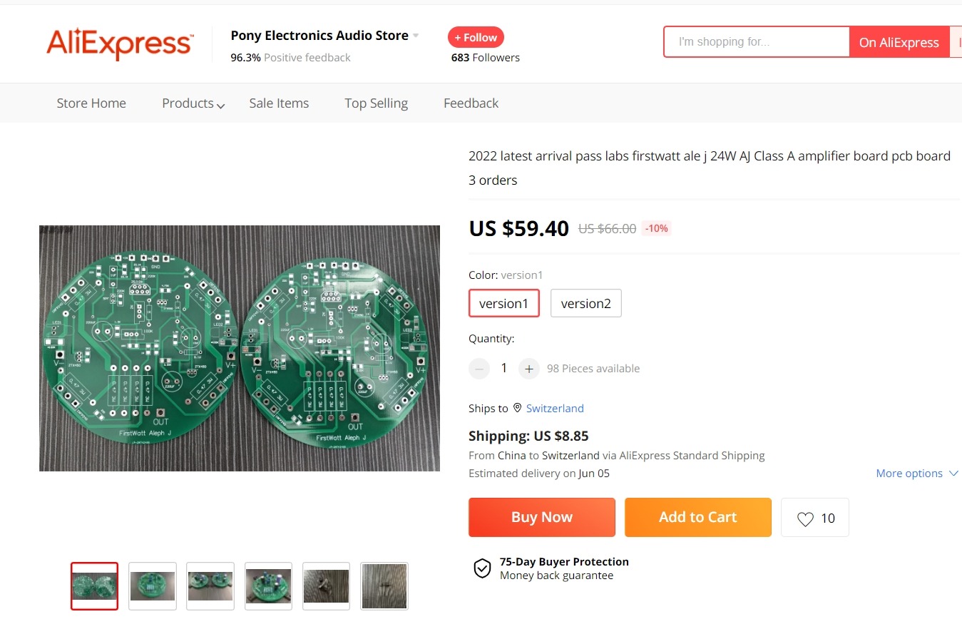

That's not even an Amp Camp Amp. It's an Aleph J. Look at the silkscreen text at center bottom. Notice the "24W" claim in the title.
There are no mounting holes on the PCB to attach it to a "hedgehog" heatsink. It appears they intend for the board to be suspended only by the leads of the power transistors at the Northeast, Southeast, Southwest, and Northwest perimeter.
On the other hand it does vividly demonstrate the value of being able to lay out your own PCBs starting from a Nelson Pass schematic. If you made your own layout, you could fab twenty of these boards, and have them shipped to your house by DHL International Express, for the same price+shipping as two boards from these counterfeiters.

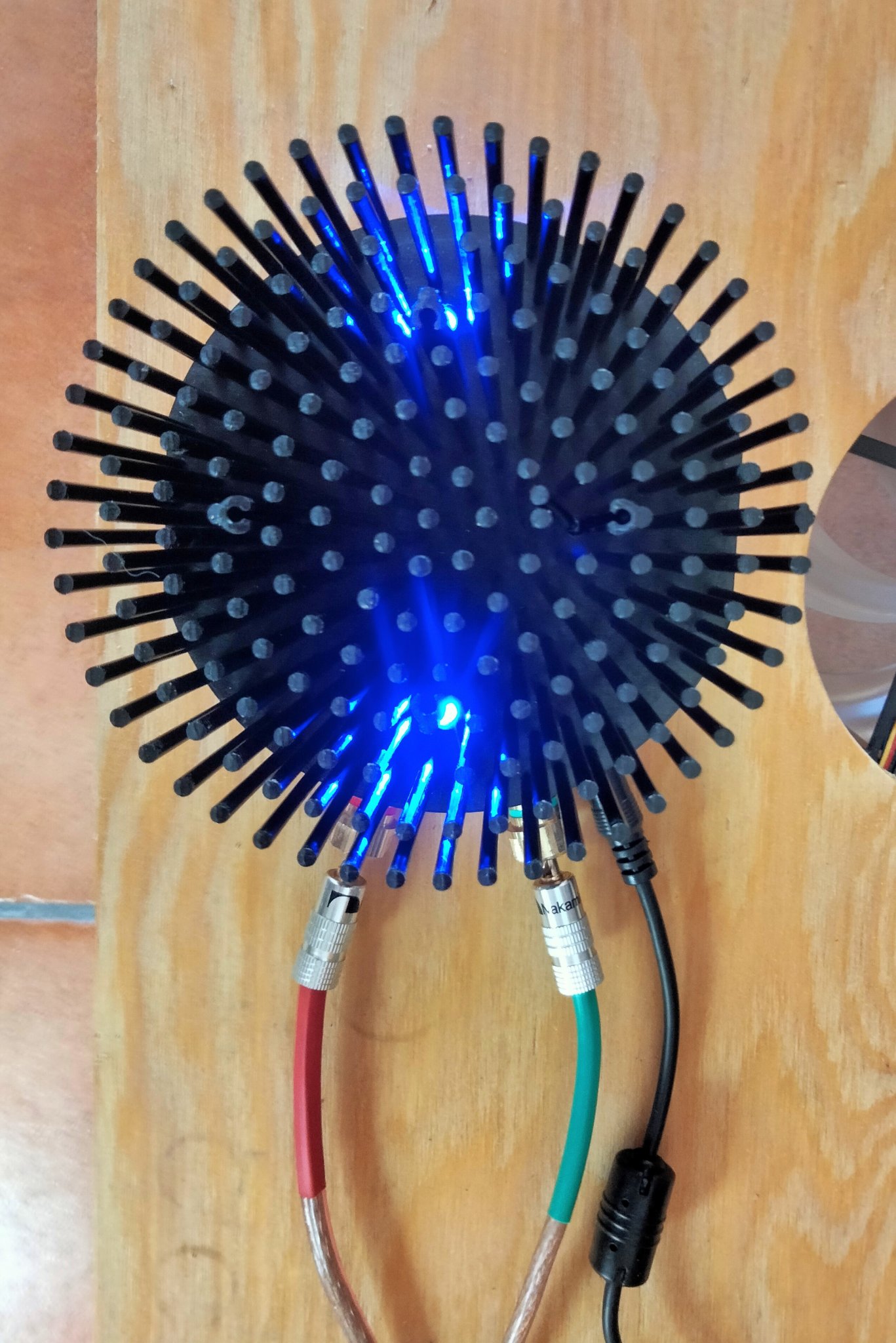

Nelson Brock’s design is another step forward- easier yet, and so cool looking, while keeping costs even lower. I call it The Hedgehog!
