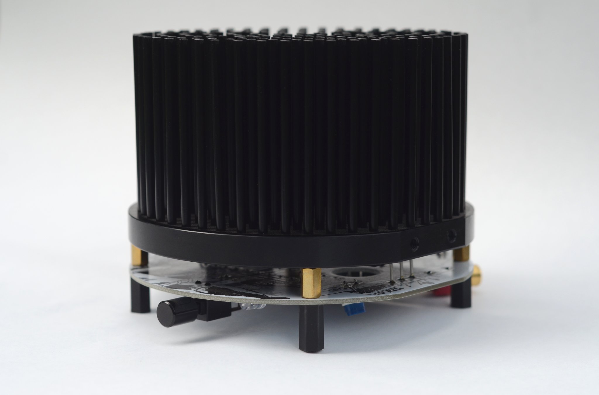

The enclosure presents the biggest opportunity to cut cost in this amplifier (and most other DIY amps). There a few critical functions that an enclosure performs.
1. Heatsink
2. Finger-proofing
3. Aesthetic
I selected a heatsink meant for LED lights. Typical "grow light" heatsinks are now produced in large quantities and are one of the more economical large passive heatsinks available. The one I've selected is a circular forged pin heatsink 120mm diameter and 70mm tall (4.7" × 2.75"). I estimate its thermal resistance at around 0.9°C/Watt. It cost $19 with free shipping.
Another advantage of the LED heatsink is that the base plate is meant to be horizontal with the pins sticking up (and LEDs pointing down). This is what makes the "caseless" design a bit more practical. By placing the PCB below the heatsink it provides a bit of protection for the components underneath and IMO, some visual interest. Standoffs hold the whole thing up off the table and no other enclosure parts are needed since the amp operates at a touch safe voltage.

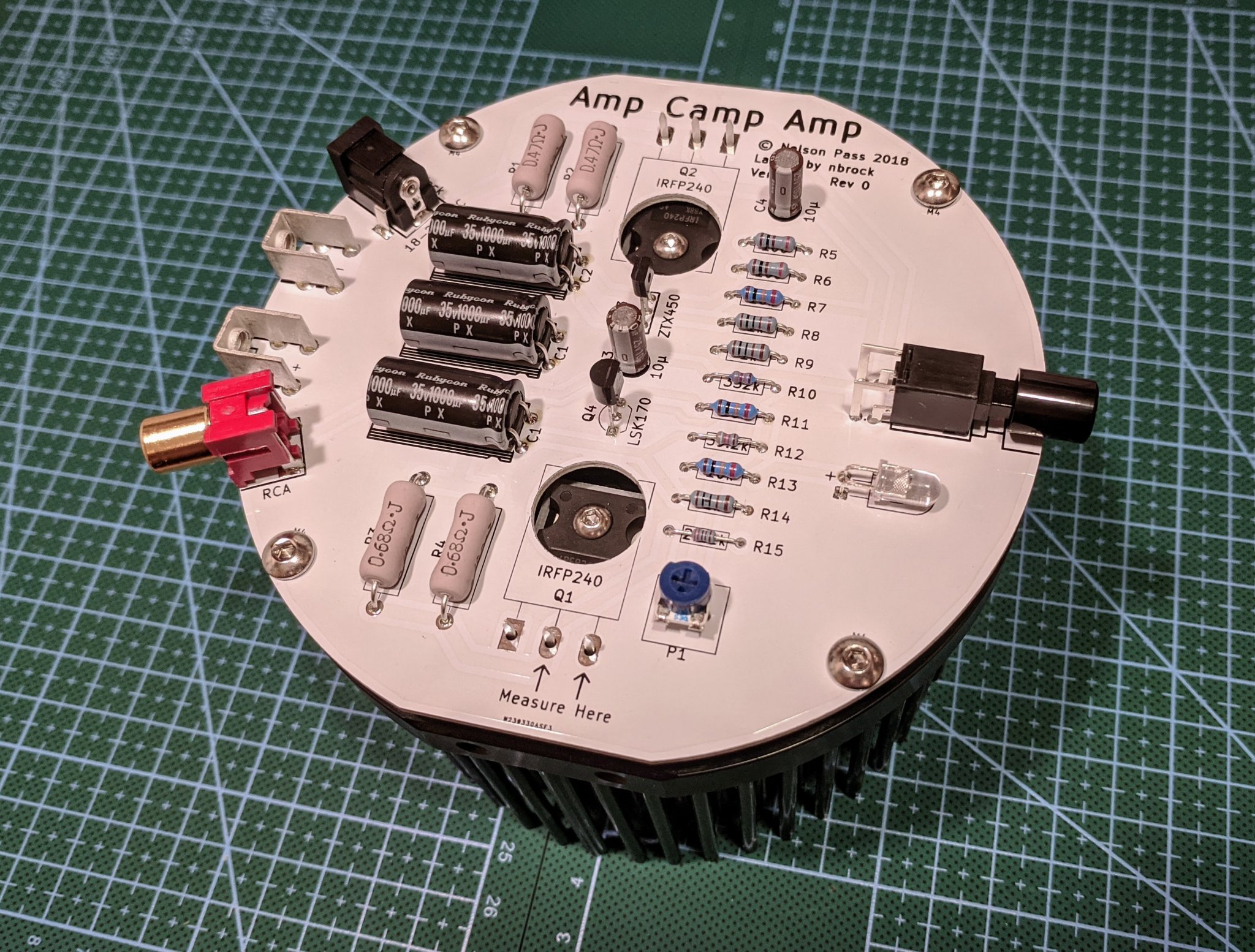

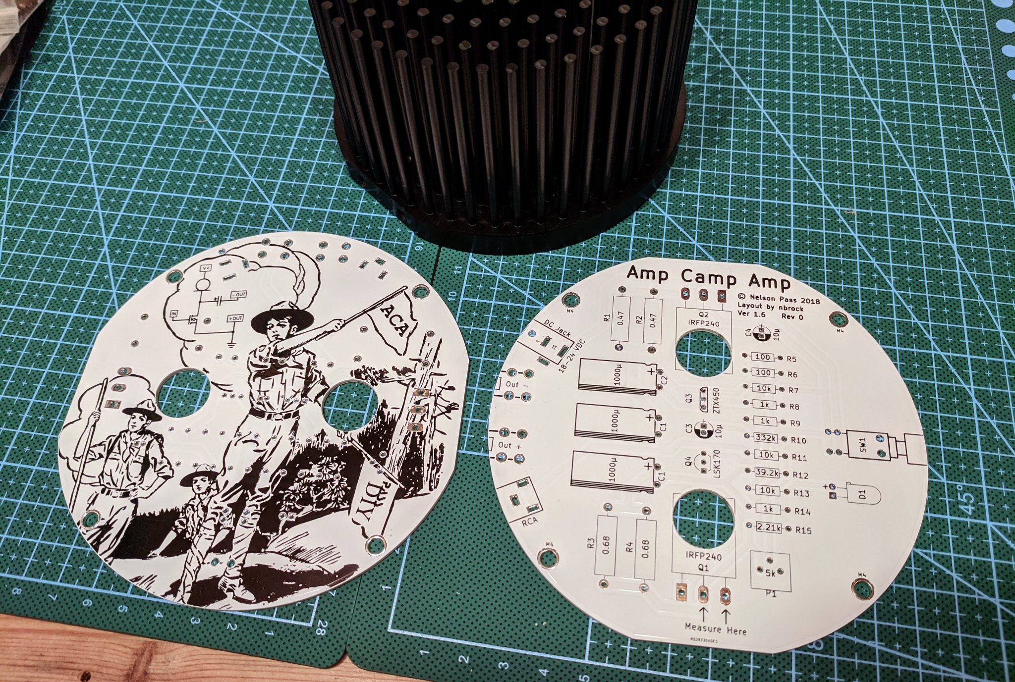

Board layout and parts selection:
In the interest of beginner friendliness, I've elected to print component values on the board and line up all the small resistors according to their numbered designation. The large capacitors lay down flat to minimize the overall height (currently 96mm / 3.8" tall). The heatsink is "grounded" through brass standoffs to the PCB mounting holes. Nylon standoffs screw into the brass standoffs so they may act as somewhat less scratchy feet for the amp to sit on. I added a bit of camp themed artwork to the back side of the PCB along with the simplified circuit from Pass' original article. I chose white soldermask because I think it makes the art look good, but it's quite difficult to see the traces ¯\(ツ)/¯

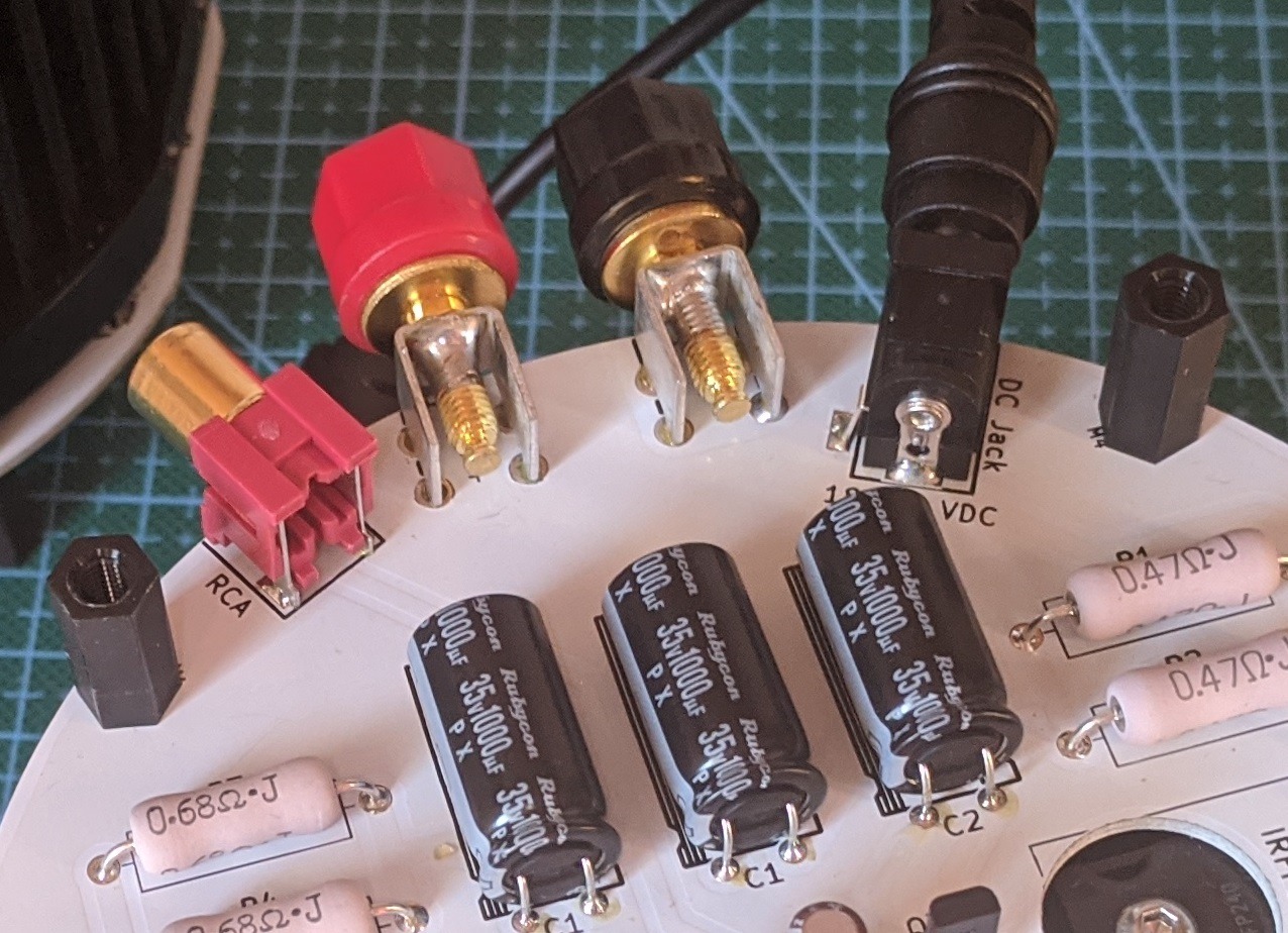

In an attempt to make assembly as easy as possible, all the connectors and the power switch are mounted to the PCB. Look ma, no wires! PCB mount power jacks and and RCA inputs are commonly available. Binding posts are less common. This design uses a right angle screw terminal with a 5 way binding post screwed into it. The threads are secured with a bit of solder. Because the binding posts and screw terminals have a high thermal mass, this is the most difficult part to solder. But even a beginner with patience and a higher powered soldering iron should be able to make it work.
These LED heatsinks often come with pre-tapped holes with spacing for the most common LED modules and lenses. I aligned the MOSFETs with the furthest apart M3 holes and used the M4 holes near the edges for the standoffs.

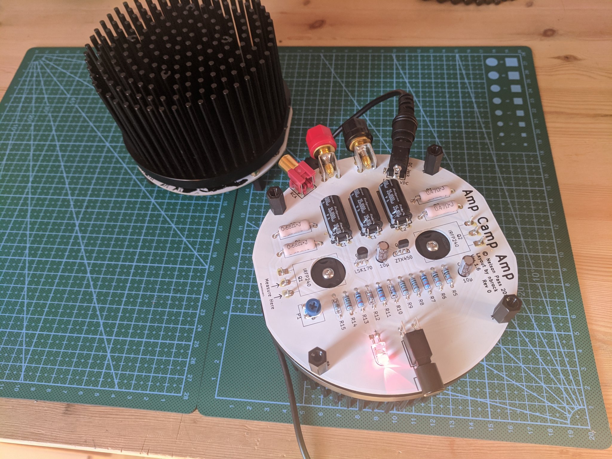

A slow moving, inaudible fan above the heatsink will more than double the cooling performance, opening the door for higher power designs in the same form factor. I've started tinkering with some old F5 boards I had laying around and I've started thinking about a 2 channel, single board ACA for bridge / parallel operation. These future projects are the primary reason for moving to a larger PCB / heatsink.

This is totally cool! I love the look and the caseless concept. I got my son a speaker kit for Christmas that he built with my assistance. Next he’ll do an amp project. This could be a great match for a first time amp project.
One idea, could you put a little power filter at the input? Maybe implement the P089ZB filter concept? Those parts are compact. If you go with the bigger heatsink it might be able to squeeze onto the board.
Thanks for the encouragement guys
Bigger output caps is on the list for next rev, but I personally don't see much reason to go larger than the original value of 3300uF. I'll give as much space as I can on the new boards.
Could probably fit it, but it ultimately will depend on the added cost / complexity, at least for this version.One idea, could you put a little power filter at the input? Maybe implement the P089ZB filter concept? Those parts are compact. If you go with the bigger heatsink it might be able to squeeze onto the board.
F5 will be my first follow up, but likely after an ACA revision.I'm interested to see where it goes. As you said maybe an F5 or how about the M2?
This heatsink gets about 25°C above ambient. The 140mm will be a little cooler.This is a really fun idea. How warm does the heatsink get with the standard ACA build?
My suggestion would be to allow larger value output coupling capacitors. Two or three 2200 uF would help with the lower frequency response.
